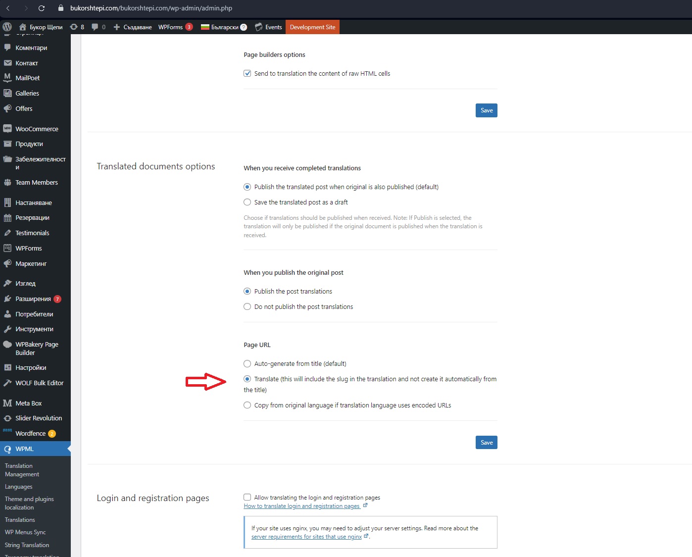

I'm building a website for reservations using the Milenia theme, which uses the Motopress reservation extension 'motopress hotel booking'. The main language of the site is Bulgarian. After translating the content and administrative texts into Bulgarian, I added WPML to make the site multilingual and added English. I made the necessary settings to translate the 'accommodations' slug from the Motopress extension.

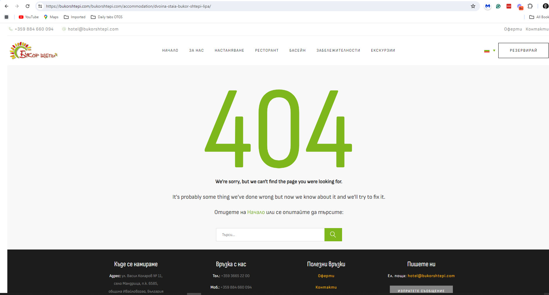

When checking the site in Bulgarian and English, sometimes loading a premise results in a 404 error. The URL slug alternates between 'nastaniavane' and 'accommodations' in the Bulgarian version, causing inconsistent behavior. Sometimes refreshing the page resolves the issue.
Why is the URL slug alternating between 'nastaniavane' and 'accommodations' in the Bulgarian version?
What can I do to fix the 404 error when loading premises in both languages?

I can see the problem on your site. It happens, for example, when I use the Language Switcher to switch from English to Bulgarian. Please see the attached screenshot. I tried it on this post, for example.

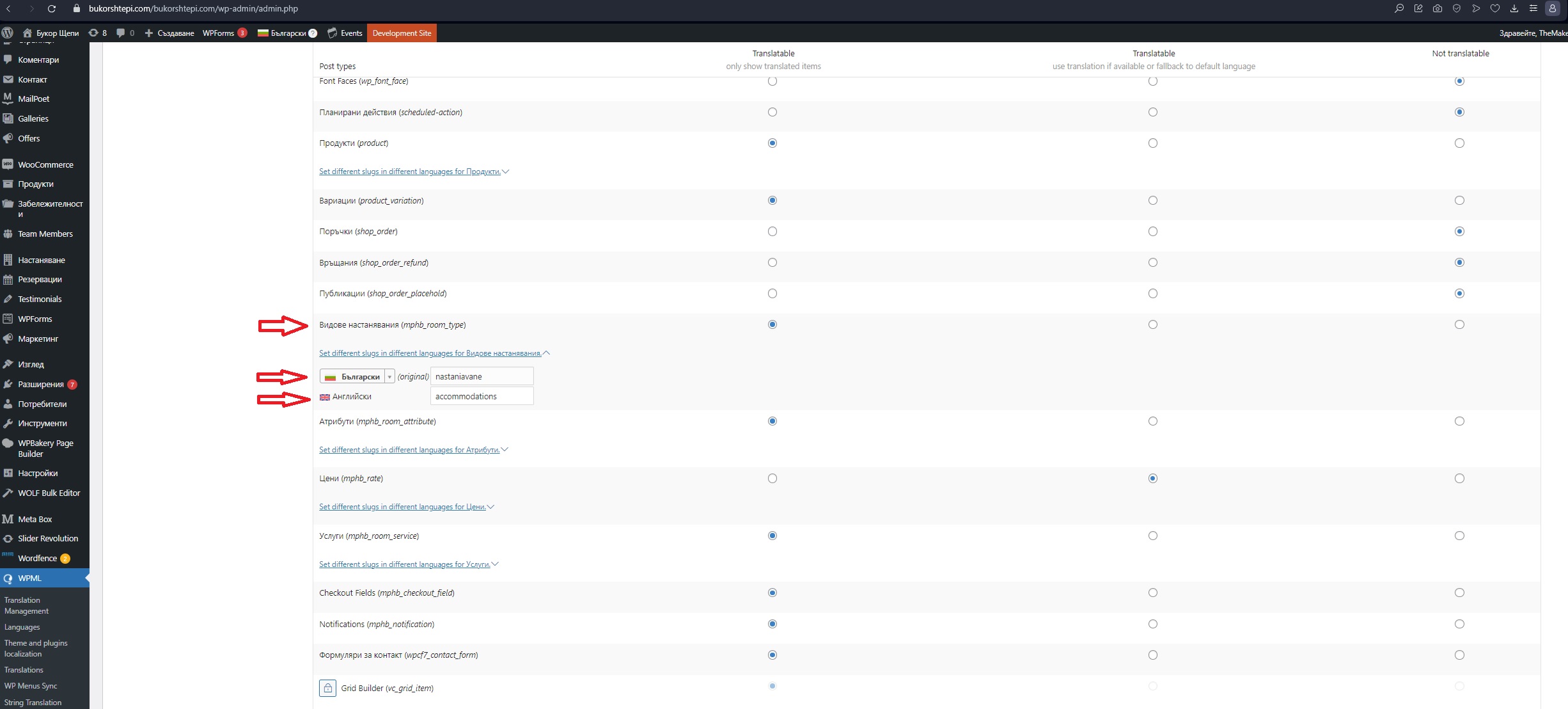

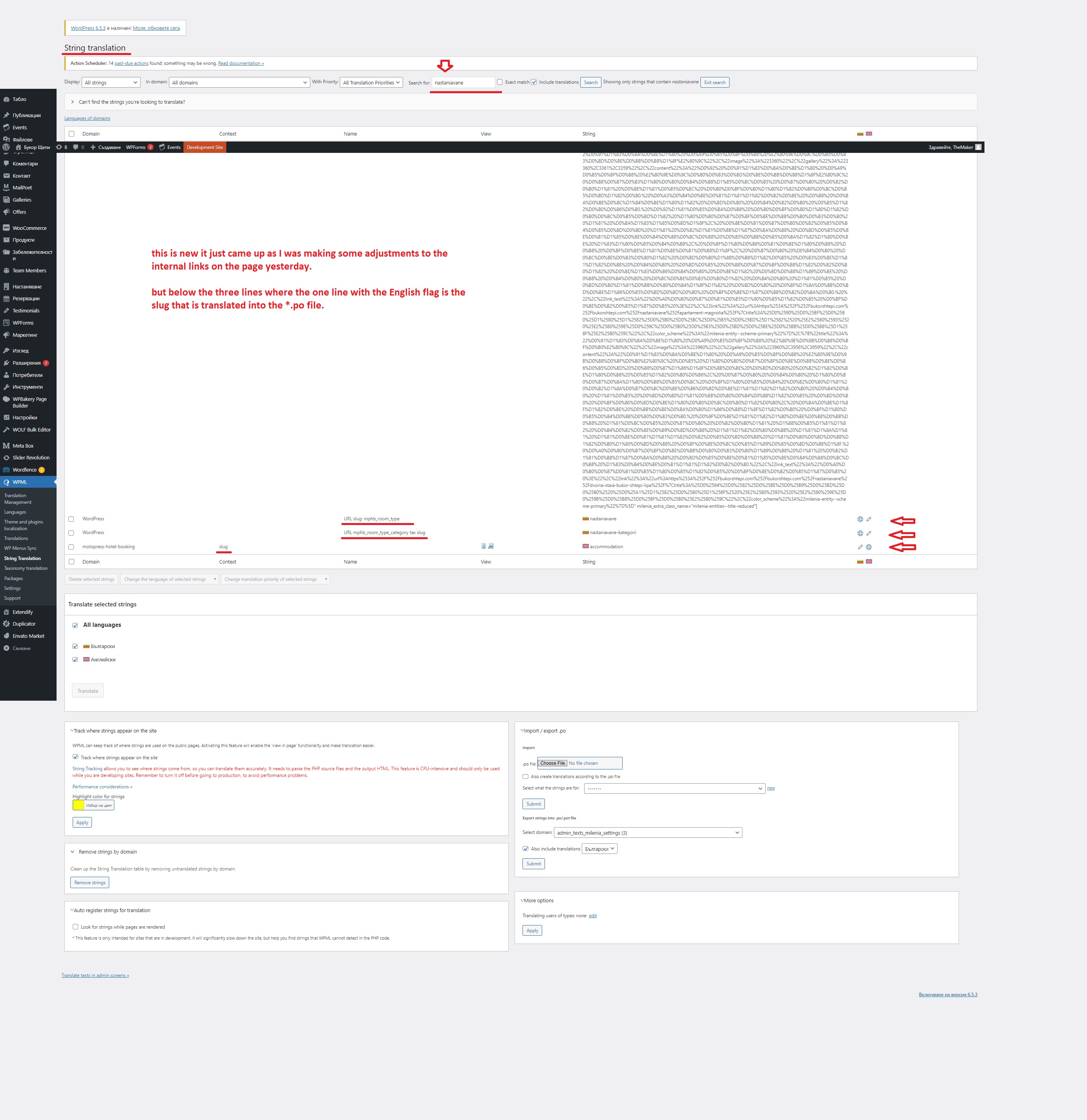

Where "slug" was once shown as "nastaniavane" (one of the words for accommodation in Bulgarian) another time with the English word "accommodation" in the Bulgarian version and once worked in both cases, other times not, and that when it works in the Bulgarian version with both words "accommodation" and "accommodation", when it first shows the page and "slug" is not translated and shows it as "accommodation" in the Bulgarian translation, when the page is refreshed, the same slug "accommodation" changes of "nastaniavane". Which is also an indication that somewhere there is an intertwining of two names for one language, in this case Bulgarian. As you can see from the screenshots, especially in the string translation images, that the slug "accommodation" in English is also translated into Bulgarian, however, from this translation of the slug, the system takes the translation for the other language and puts it in the slug change field in the part with the WPML settings where it is specified whether to translate the slug or not.
Since the default language is Bulgarian, the translation word "nastaniavane" (in Bulgarian) for "accommodation". Probably due to the fact that a slug has been translated directly into the string translation, it causes sticking and confuses the reservation system because of the Bulgarian word, which replaces the role of "accommodation". Because accommodation is key to the operation of the reservation system. So, I went to the string translation and instead of directly translating "accommodation" as "nastaniavane", as it was before, I simply also wrote "accommodation" in the field for the Bulgarian translation. And since, as I said, then this translation is transferred to the WPLM settings in the part with translations for taxonomies and slugs, from there I have already changed things, because even in Bulgarian it showed me accommodation and because from there I already have an active option to change the language to which the name refers, from there I changed it so that it is not Bulgarian, but English. Then WPML, after updating the settings, showed me the change field correctly and then I already wrote the Bulgarian word "nastaniavane" for "accommodation".
