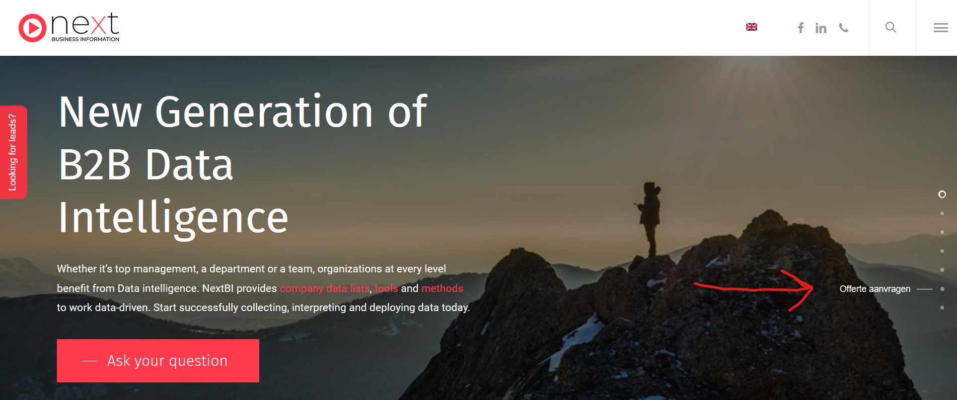

January 22, 2024 at 3:27 pm #15212476
deddoW
Some parts from salient templates are not automatically translated. I can't find the place where I can translate these parts. An example is the row-name. So the Dot Navigation is not translated in English.

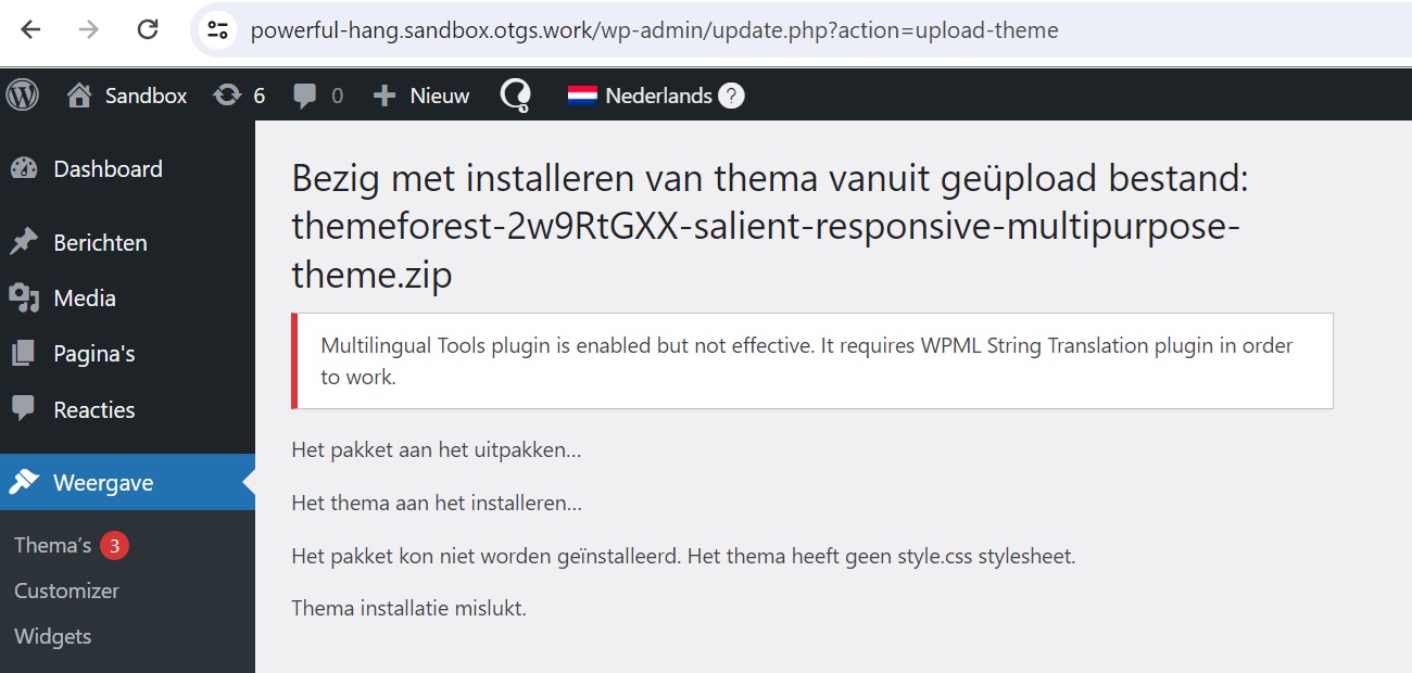

January 29, 2024 at 10:25 am #15237276
deddoW
Hi Diego,
I uploaded the latest version of our Salient theme, but got an error stating the style.css was missing from the theme, so I need to get into contact with Salient through themeforrest and require some extra time. Can you keep this ticket open for another week?
Deddo

My colleague Deddo managed to add the theme. I have now created a page that somewhat resembles our actual homepage.
On our actual website we translate everything automatically via WPML, but the topics in the dot navigation on the right are not translated and I cannot find where I can translate it. I prefer not to translate manually because I know from experience that this can disappear again due to another operation or update.
Thank you very much for your support!

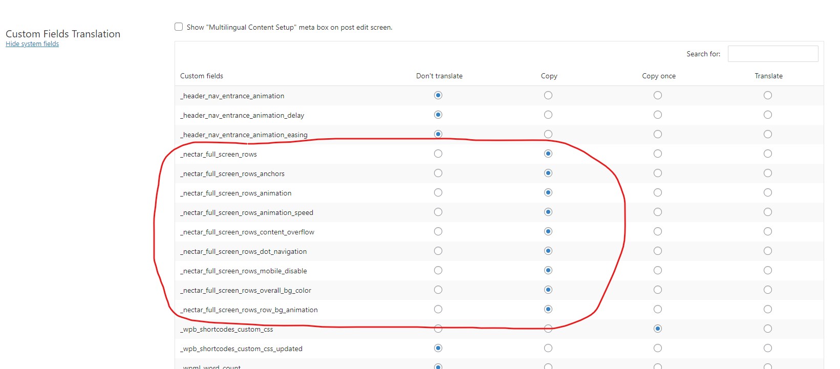

3) Then go to WPML -> Settings -> Custom Fields Translation section.
4) Click "Show System Fields".
5) Set the following fields to "Copy" and save (see atttached):
_nectar_full_screen_rows
_nectar_full_screen_rows_anchors
_nectar_full_screen_rows_animation
_nectar_full_screen_rows_animation_speed
_nectar_full_screen_rows_content_overflow
_nectar_full_screen_rows_dot_navigation
_nectar_full_screen_rows_mobile_disable
_nectar_full_screen_rows_overall_bg_color
_nectar_full_screen_rows_row_bg_animation

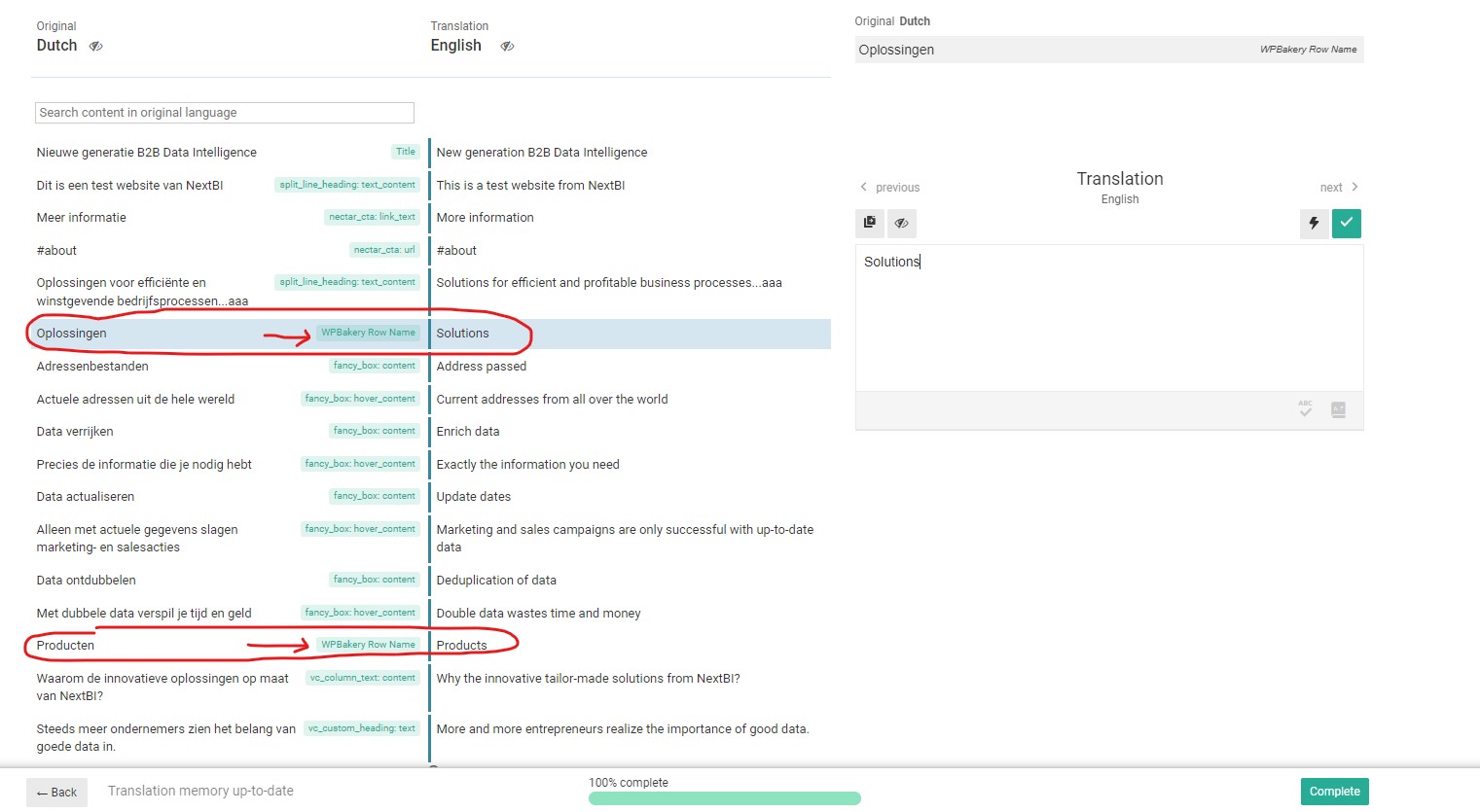

9) Update the translation of the page in ATE.
10) In ATE, you should now see the labels of dot navigation available for translation (also labelled as WPBakery Row Name) - see attached.
11) Translate these labels, as well as, any other incomplete translations and mark as completed.
12) Clear caches and check on the frontend, it should be working fine now.
