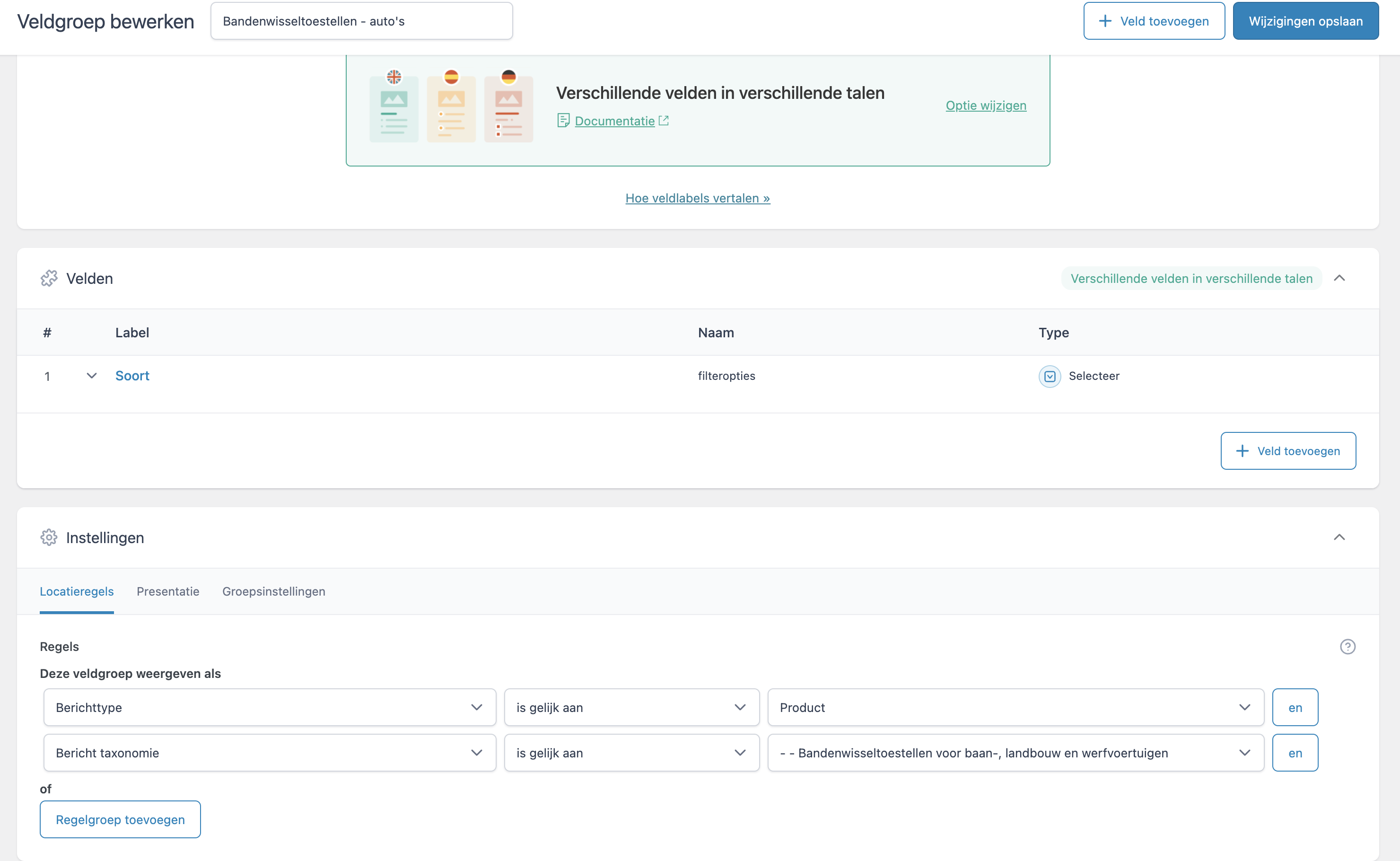

I've got another problem with this. I need to change a location rule but after I save it it's back the old one. If I disable the plugin 'Advanced Custom Fields Multilingual' I can change the rule and it is saved. Can you help please?

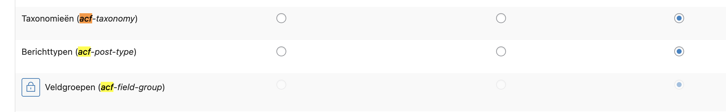

do you mean to change location rule on your translated ACF field group or? Since it should be possible to change in regular ACF field groups.
I am asking this because I see you have set ACF field groups to be translatable, which is not recommended procedure an can cause issues. In addition to that, it is expected location rule is same as the one in your default language.

Hi, the ACF field groups are not translatable. So that can't be te problem. (see image attached)
It is just with one ACF that I can't change the location rule. With all the rest there is no problem. So if I change the location rules 'bericht taxonomie' it will not save. (see image attached). But if I disable the plugin 'Advanced Custom Fields Multilingual' it works. So can you help please.

thanks, I checked and I suspect there is some corruption with this field group since the same rule can not be removed at all.
