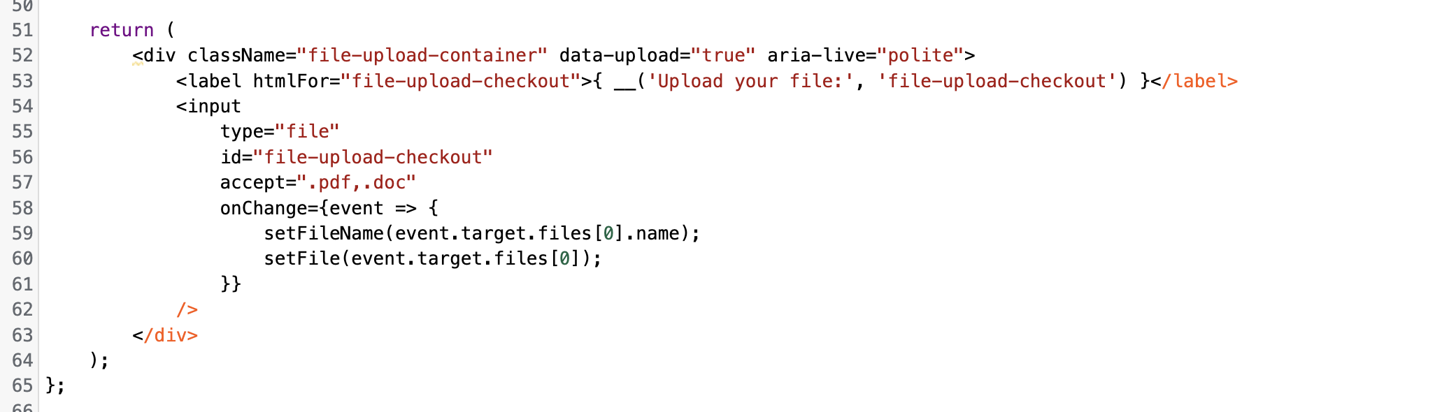

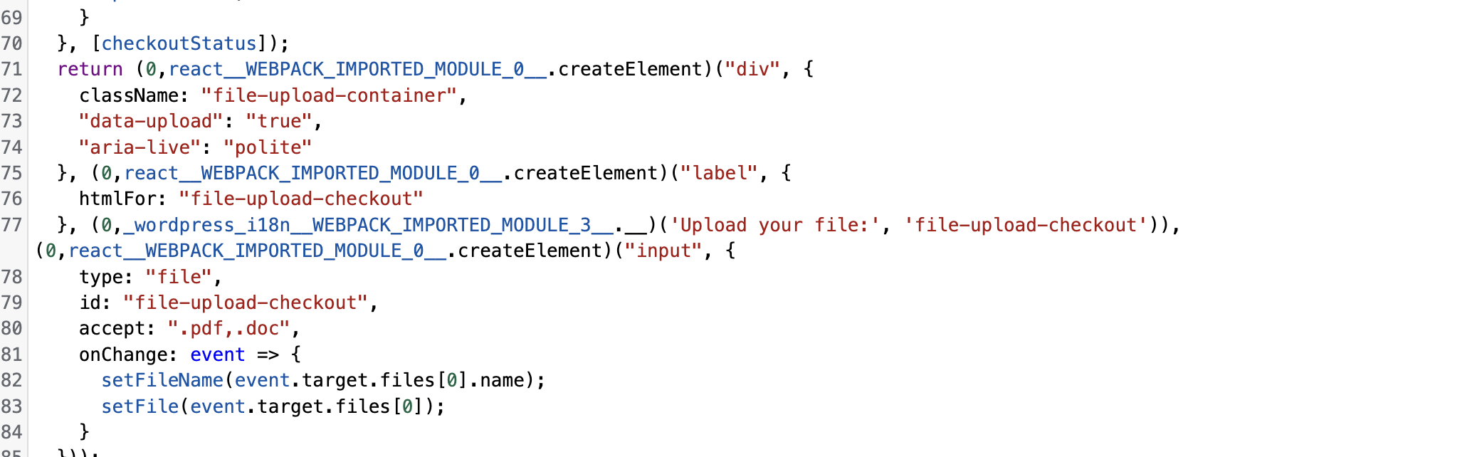

2. Custom block contents not being translateable despite having wrapped them in localisation tags

August 15, 2024 at 8:31 pm #16076180
karelR-3
Screenshots from both src and build files.

As far as I can see, those are JavaScript strings. To translate them, follow this guide: https://wpml.org/documentation/support/translating-the-theme-you-created/#adding-gettext-calls-to-javascript-js-code.
However, you may encounter a problem https://wpml.org/errata/translating-strings-from-javascript-files-using-wp_set_script_translations/ that WPML can't currently translate.
I also noticed stings like "Choose file" and "No file chosen." Those strings depend on the browser language.
