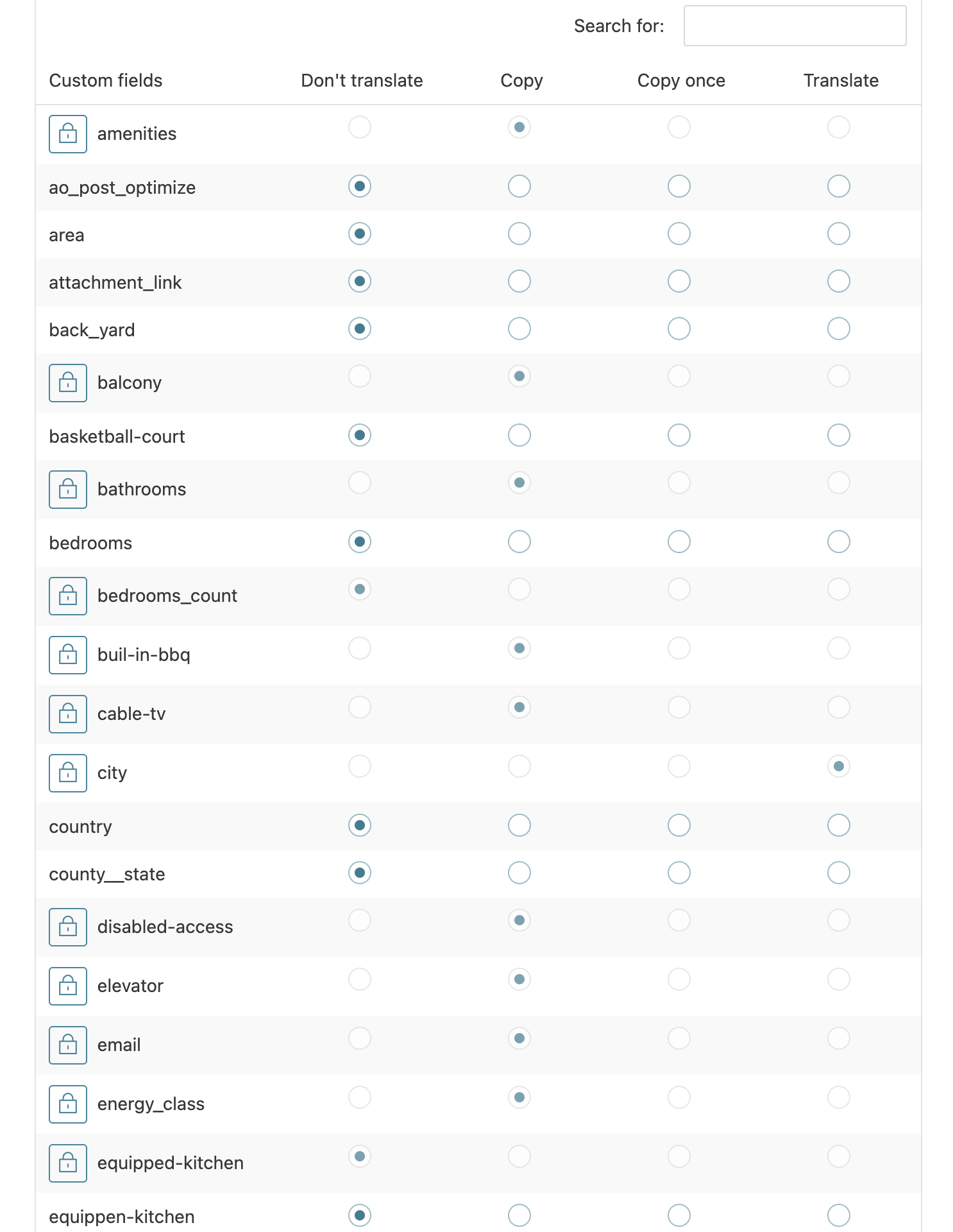

As you can see on the image attached, the ACF field groups are locked. When I am trying to unlock to change to "not translatable", it gets me to ACF field groups > edit> whereas I have chosen "same fields across language" because I want to use the same fields in greek but translate them from english to greek.
So I can't really change anything in WPML->settings->Field Groups, as the Fields are locked.

In WPML → Settings → Post Types Translation → Field Groups (acf-field-group), you correctly set Field Groups to Not Translatable.
Note: Please do not edit any items marked “locked” unless directed by our team.
Next, go to ACF → Field Groups → Property Fields.
Using the option to apply all fields across languages is perfect. If you ever need finer control (e.g., setting individual fields to copy, translate, etc.), switch to EXPERT mode. This will show the field-level options as in my screencast.
With this, the ACF configuration is correct and fields now transfer properly to translations.

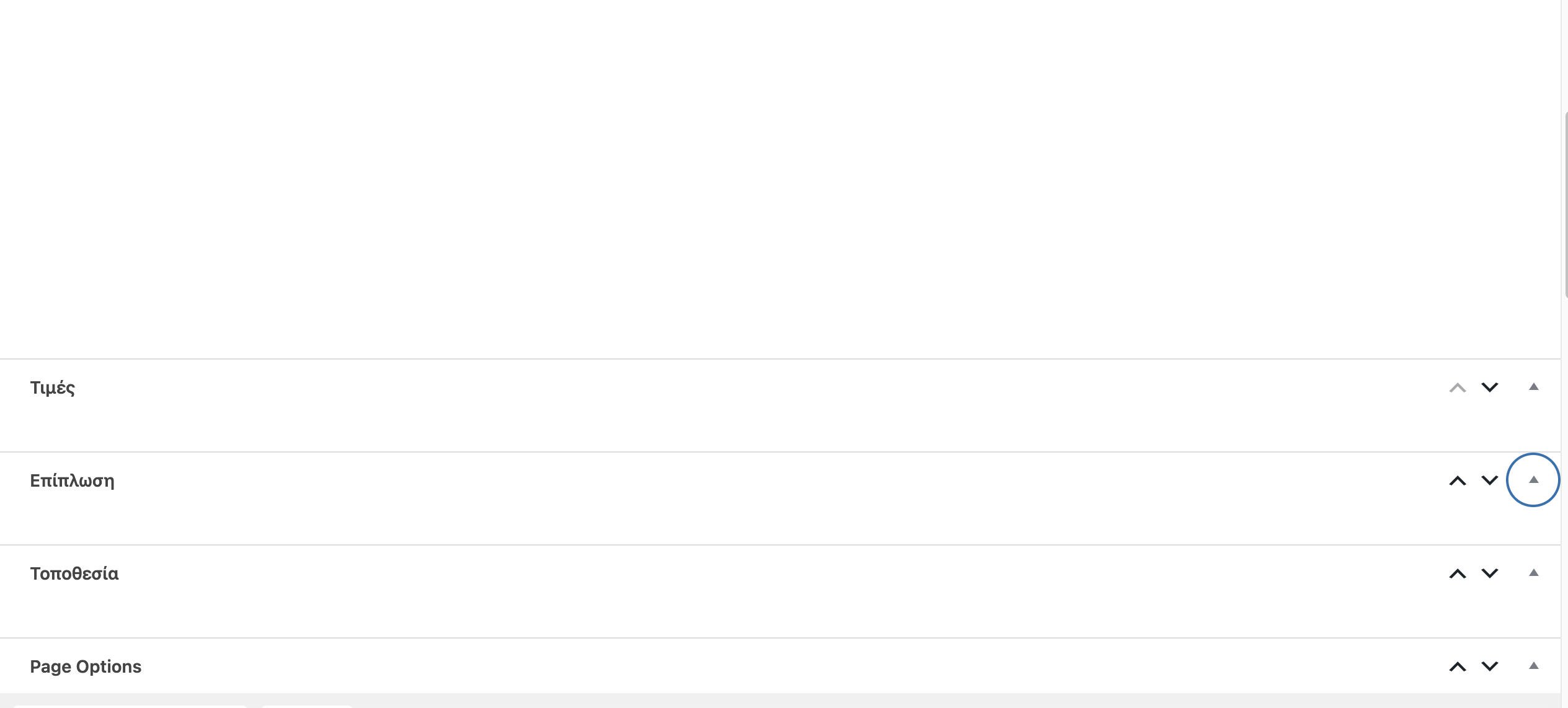

However, data was still missing because the product page uses a template, and the Greek translation wasn’t assigned the correct template.
Fix applied:
Edited the property in the default language
Switched to Greek using the language switcher
Scrolled to Theme/Page Options
Copied the same settings from English to Greek
For example, the Content Layout → Post Template was not set in Greek; adding it resolved the issue.
I also set the custom field thegem_page_data to copy, which should prevent this issue in the future.

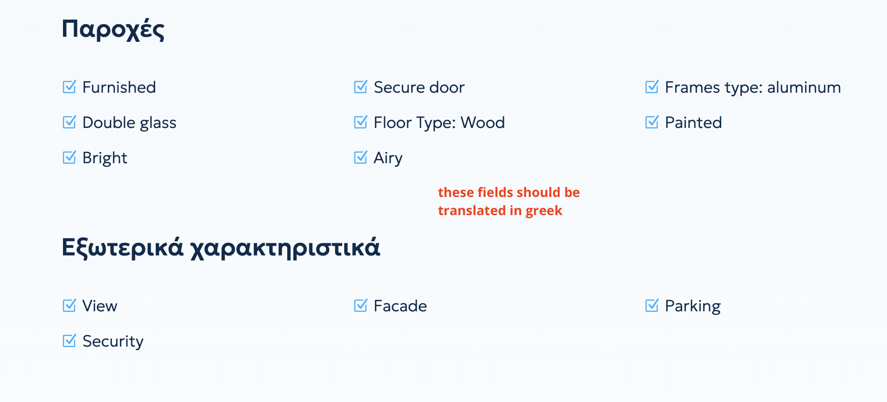

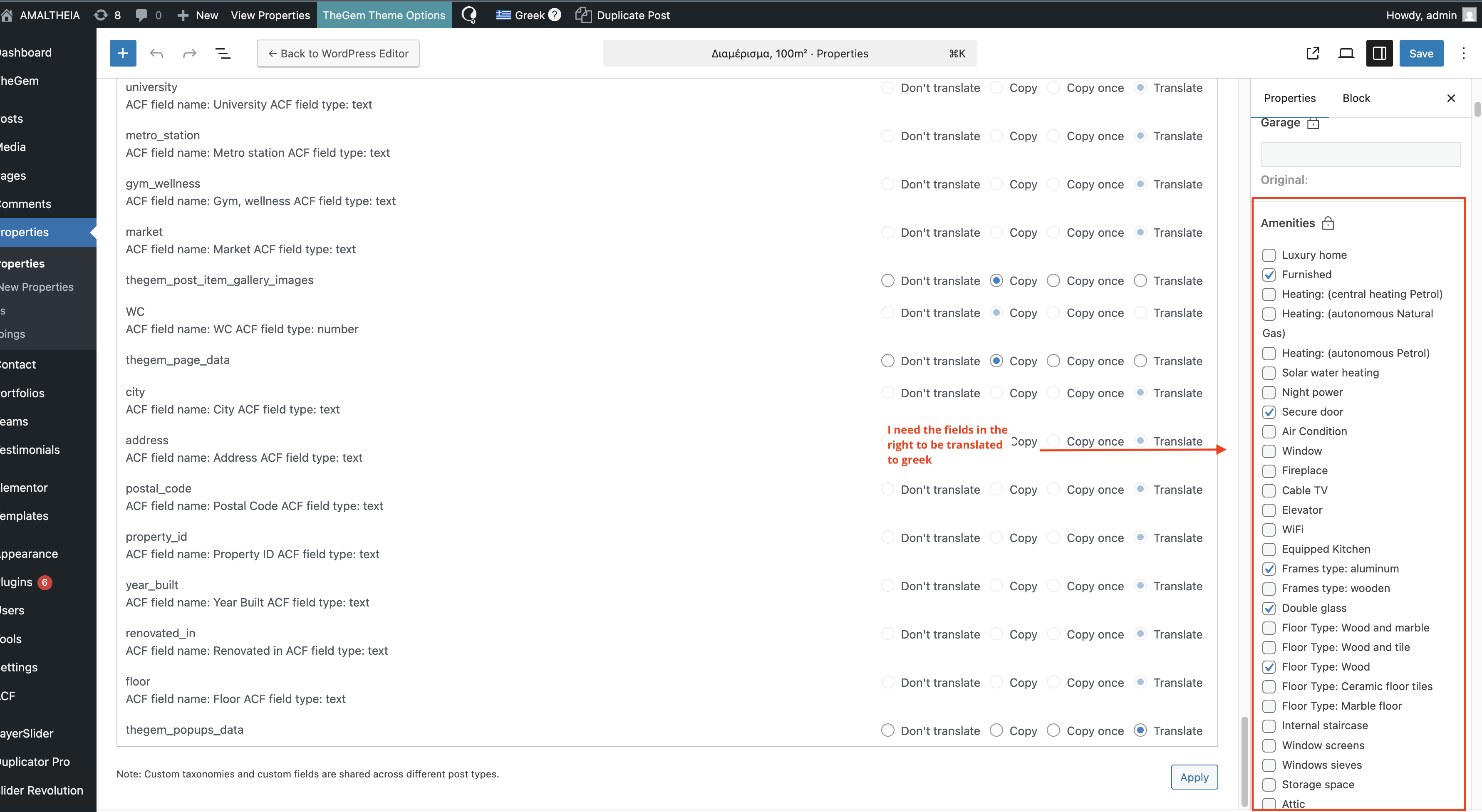

Although I am still missing some things:
The fields I try to translate are still untranslatable, please see the pictures attached.

Regarding the ACF Choices, I have reviewed and verified that they were correctly translated via WPML->Translation managemenet->ACF Field Group
->Field Group Labels 57.
Regardless the correct set up and translation the choices are still showing untranslated in the front end.

I was able to resolve the issue now.
NOTE: I attempted the expert mode prior the updated versions of the plugins and my results were not good.
With the latest versions I was able to resolve the issue doing these steps:
1. Go to ACF Field Groups -> Edit the field group
2. Set it to "Expert"
3. Edit the specific field "ammenities" and set to "Translate"
4. Update the property (edit and click update)
5. Update the translation
Now the Greek data is being pulled.
