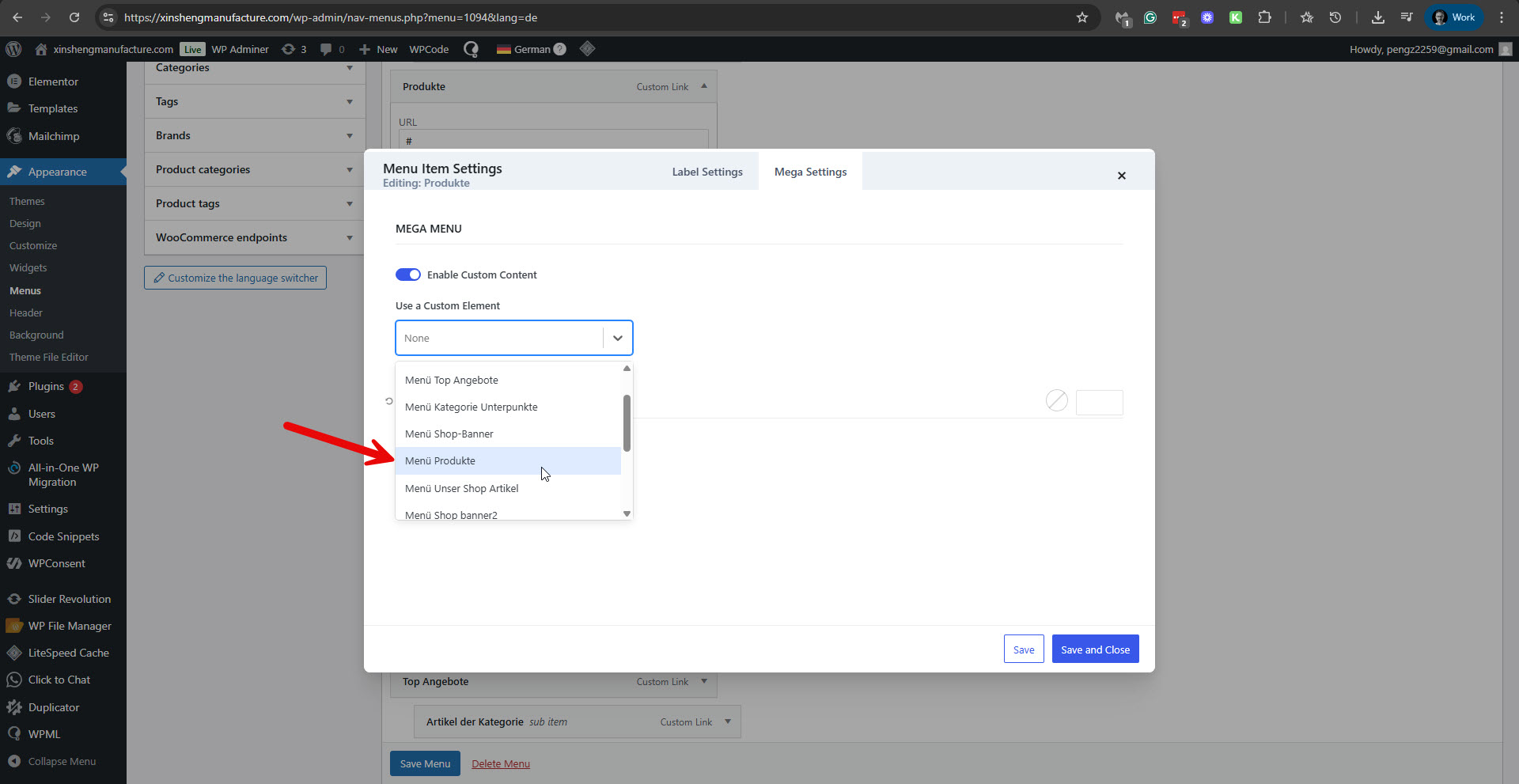

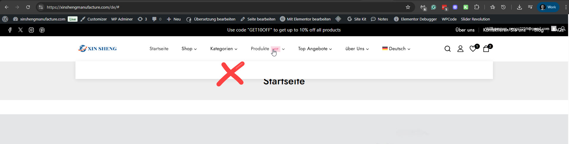

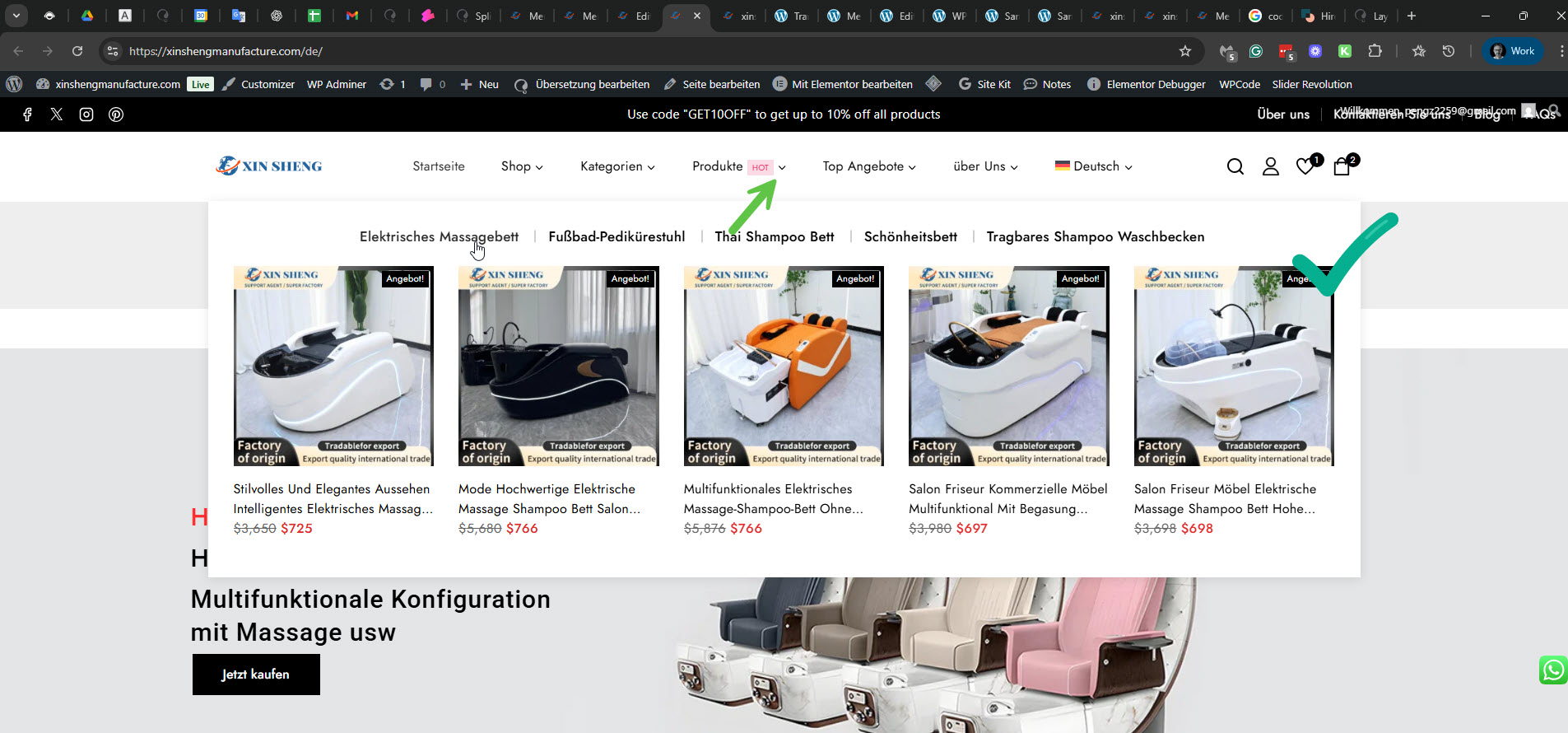

I've carefully watched the video you shared and followed the same steps. I could set the mega menu in German to the Menü Produkte German template. Please see the attached screenshot menu-produkte.jpg. However, on the front, when hovering over Producte, the section is empty. Please see the attached screenshot no-content.jpg.

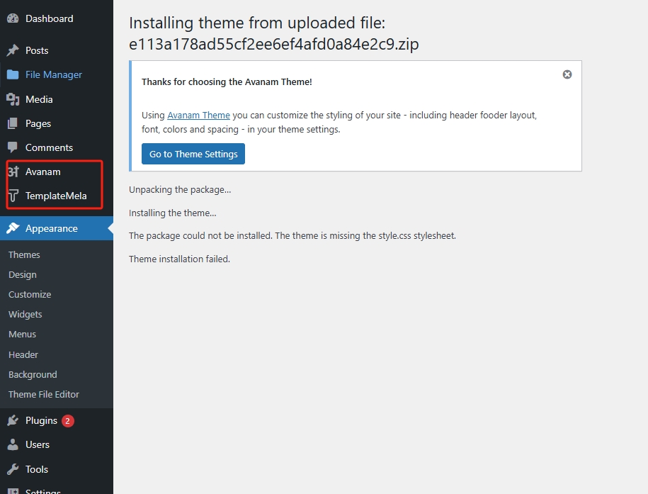

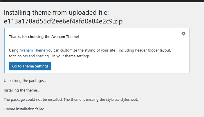

This is the theme I purchased. It only allows one website to use it. It shows that the style is missing. If you can rewrite the code file, you can try to change it.Or find the problem directly on my website

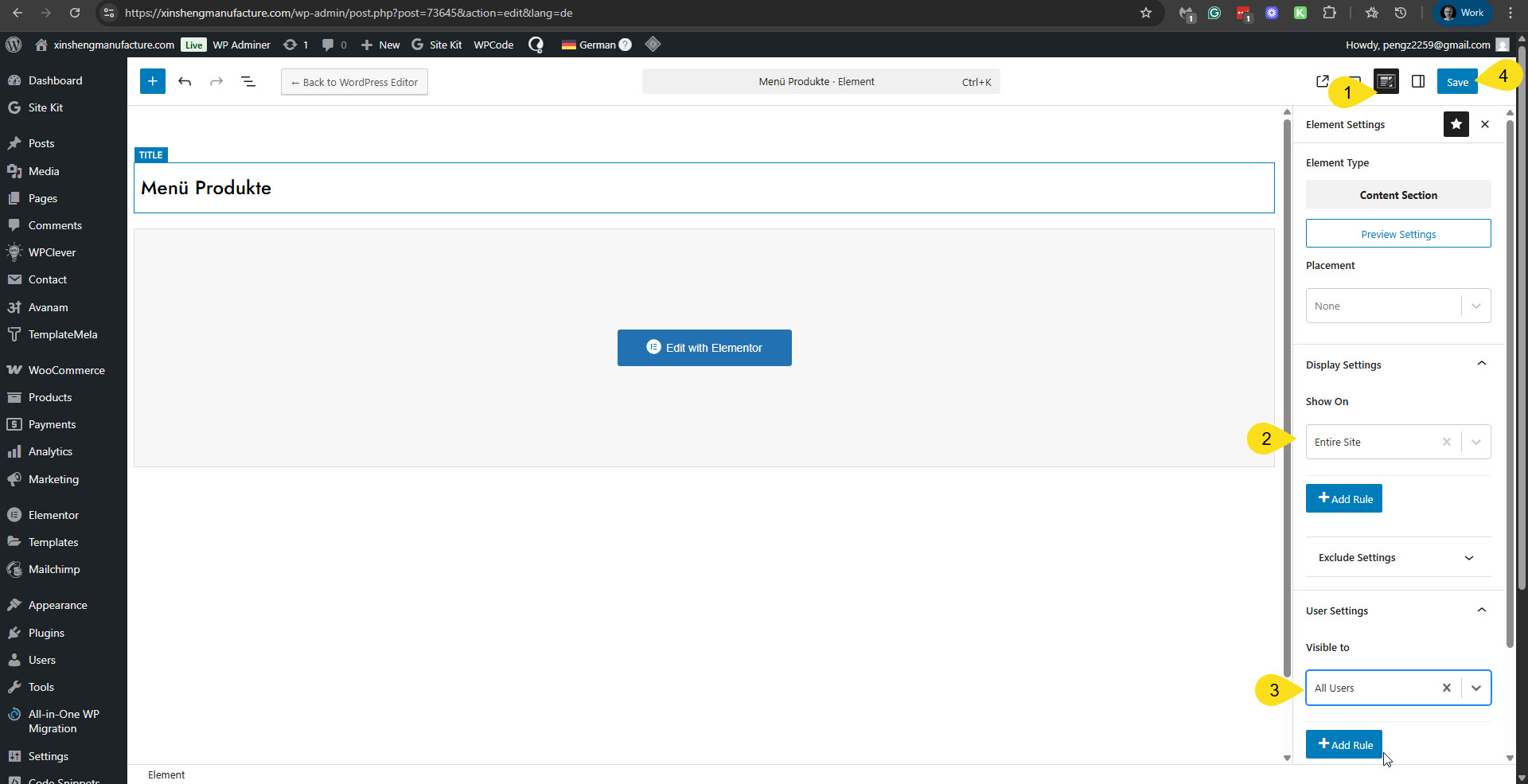

I was able to solve this problem. Here is what I did.

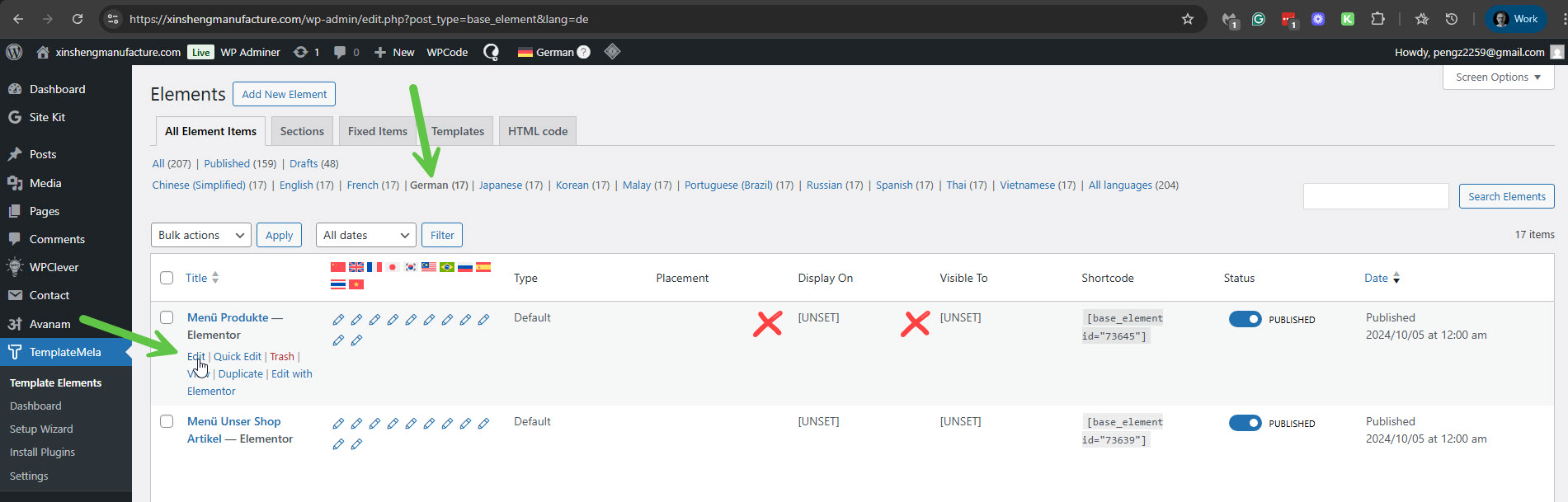

1. Edit the translated element in TemplateMela. (You will be able to see that it Display On [UNSET] and Visbile To [UNSET]) Please see the attached screenshot edit-translated-element.jpg.

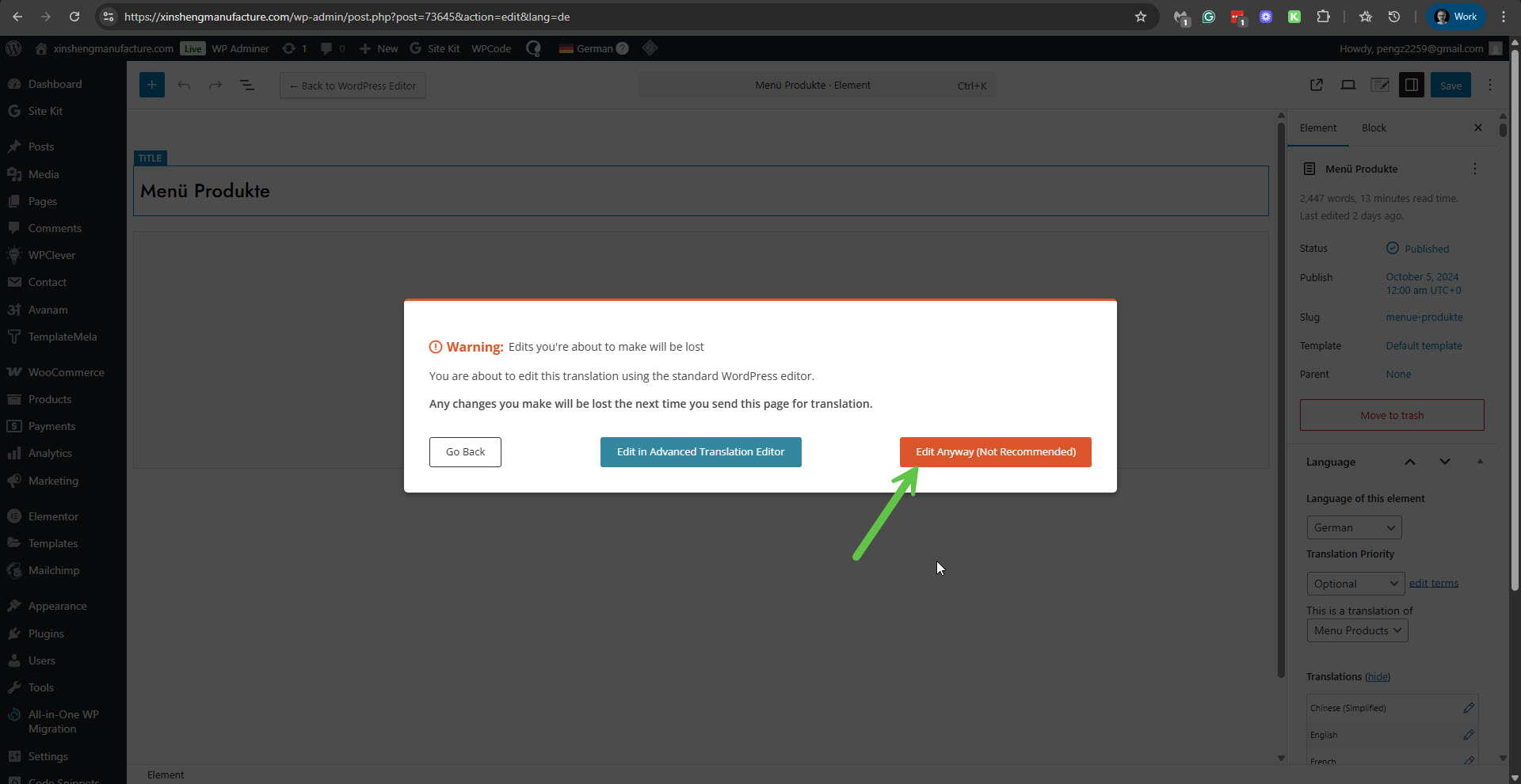

2. When you get the editing screen of the element, click on the 'Edit Anyway (Not Recommended) button. Please see the attached screenshot edit-anyway.jpg.
3. Click on the Element Settings button, and set Show On: Entire Site and Visible to: All Users. Then click the Save button. Please see the attached screenshot element-settings.jpg.

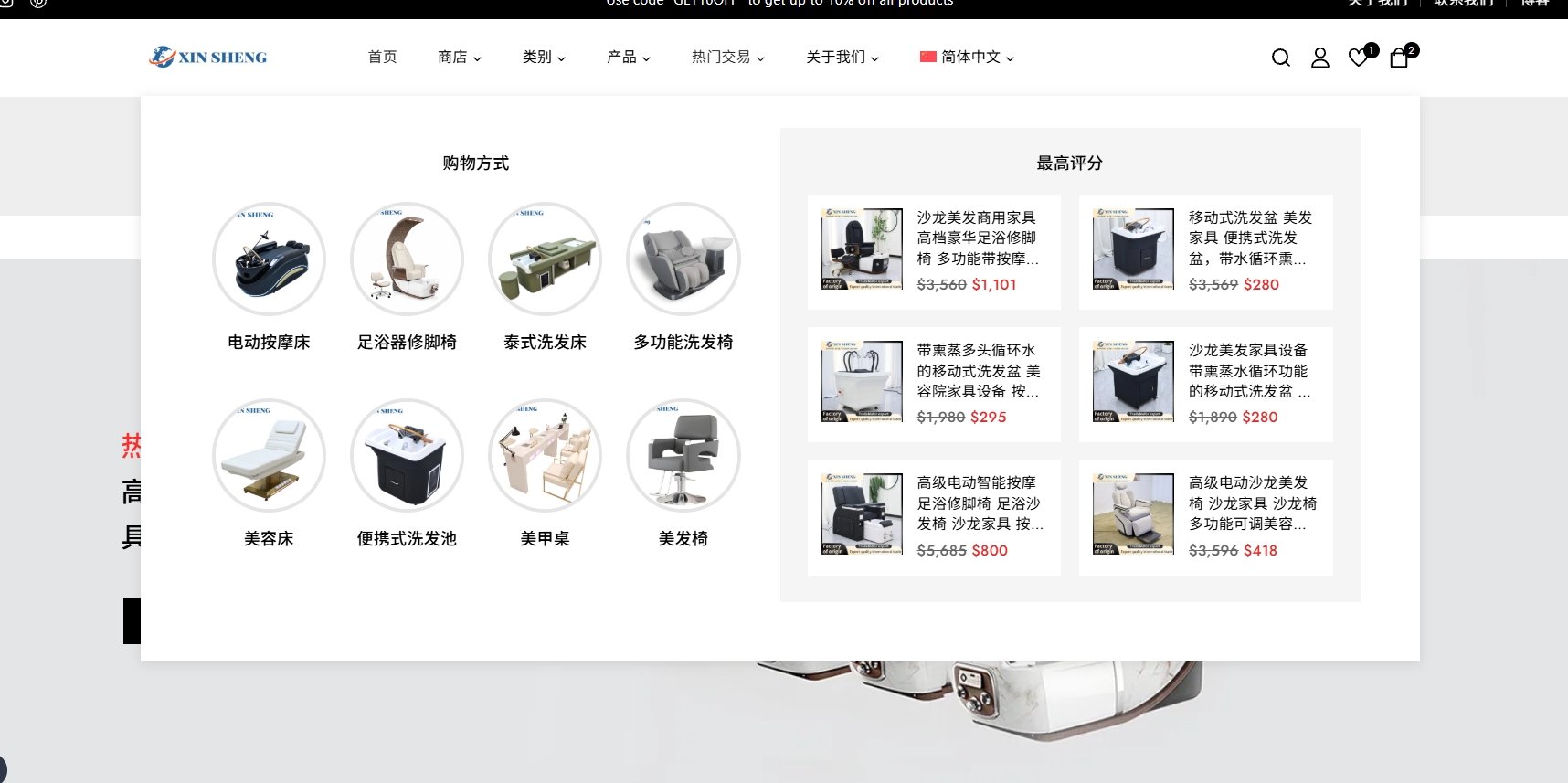

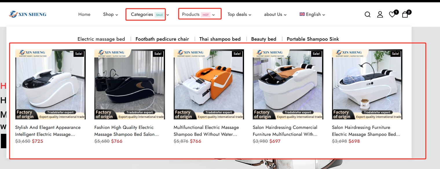

Now, when you refresh the translated pages, you will see that the translated menu works. Please see the attached screenshot, ok-on-the-front.jpg.
Please follow these steps and confirm that the problem is fixed.

July 31, 2025 at 8:52 am #17284278
zaimianz

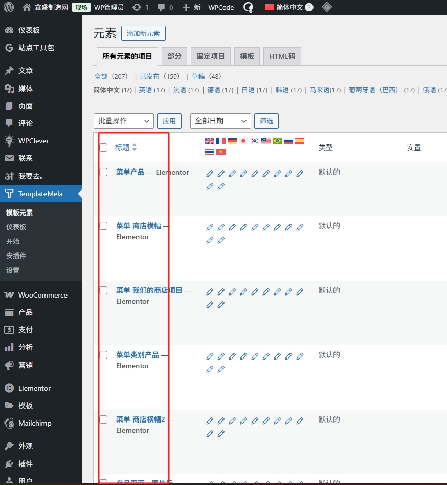

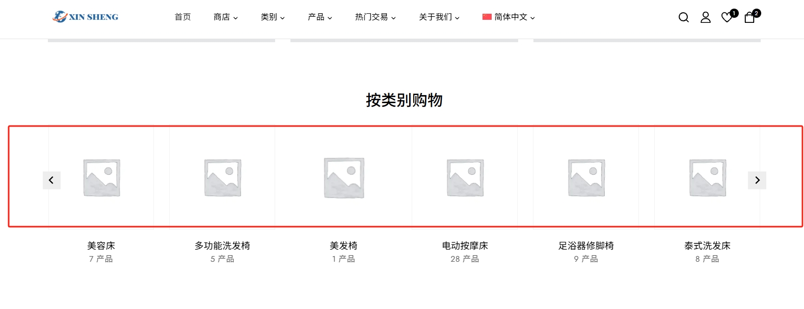

I have successfully solved the problem according to your method, thank you very much, now we will continue to solve other problems, as shown in the picture, these contents still cannot be translated, I don't know how to translate them
