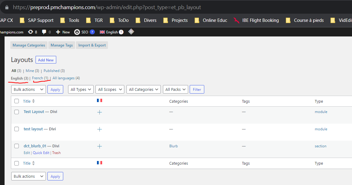

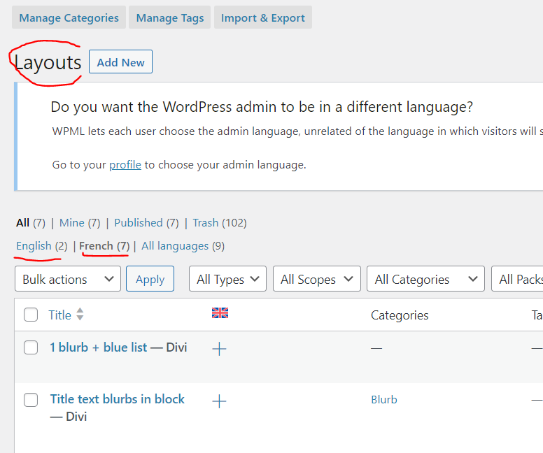

Thank you that resolves the issue . I would like also to exclude the Divi Library from translation. So I want that the library be available for both French and English. Attached teh current divi library split by language .
Thank you

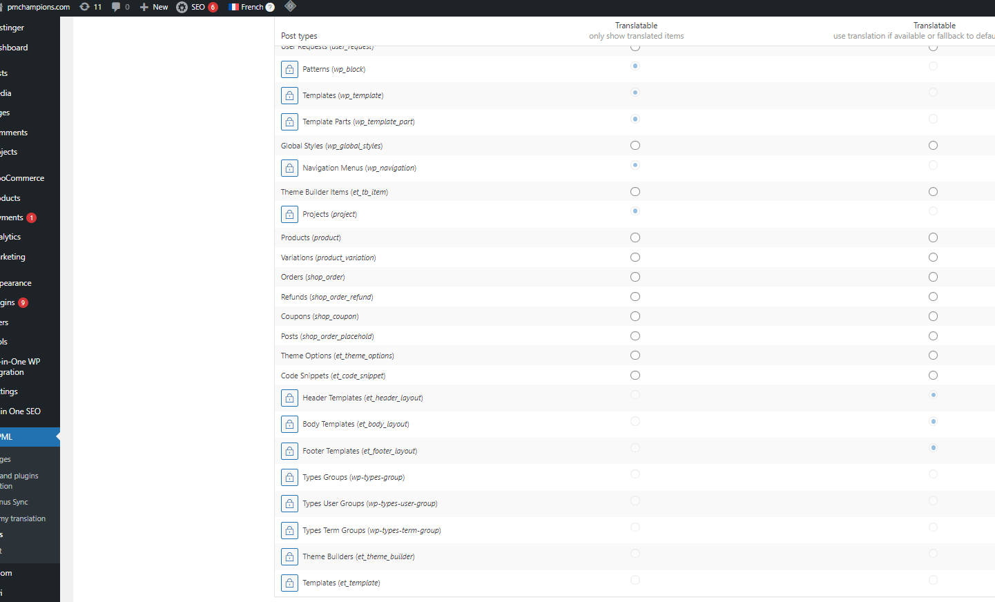

October 5, 2023 at 2:11 pm #14520965
adilB-5
Hello ,
I opened the WPML settings (Post Types) but the list does not include "Divi Library" (see attached)
October 5, 2023 at 2:33 pm #14521245
Andrey
WPML Supporter since 06/2013
It might have a different name. Please show me the URL when you are on the Layouts page.
Also, check the custom taxonomy section in WPML >> Settings.

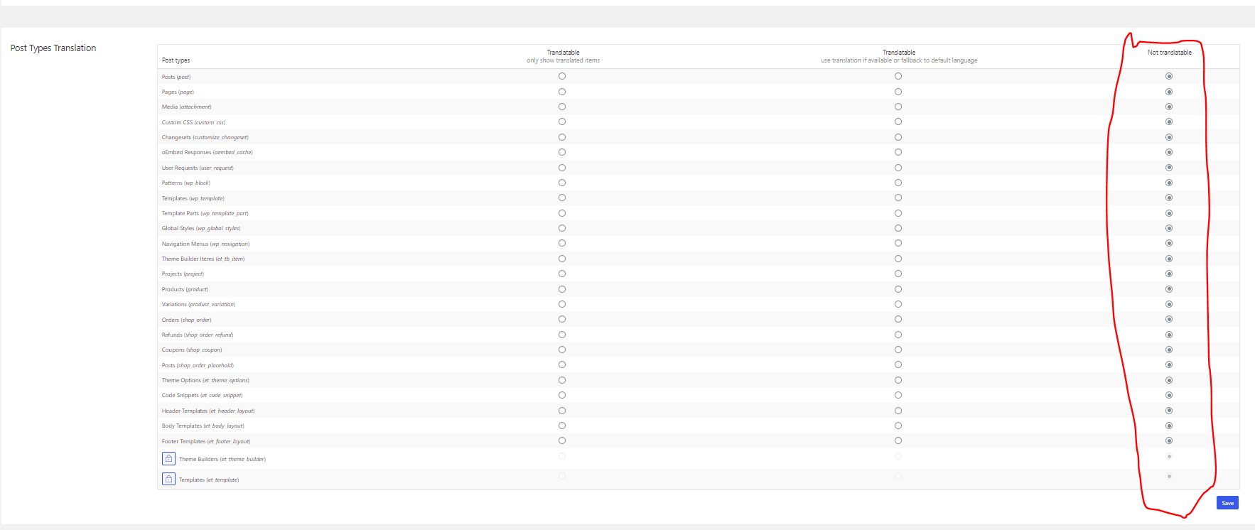

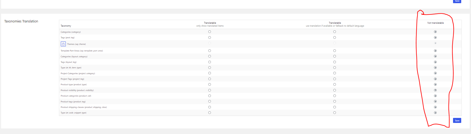

October 6, 2023 at 8:02 am #14524849
adilB-5
Here is the URL :
For Testing I moved all PostTypes and Taxonmies in WPML Setting to "Not Translatable". But I am still getting translation for the Divi Library (Layouts) (see attached)

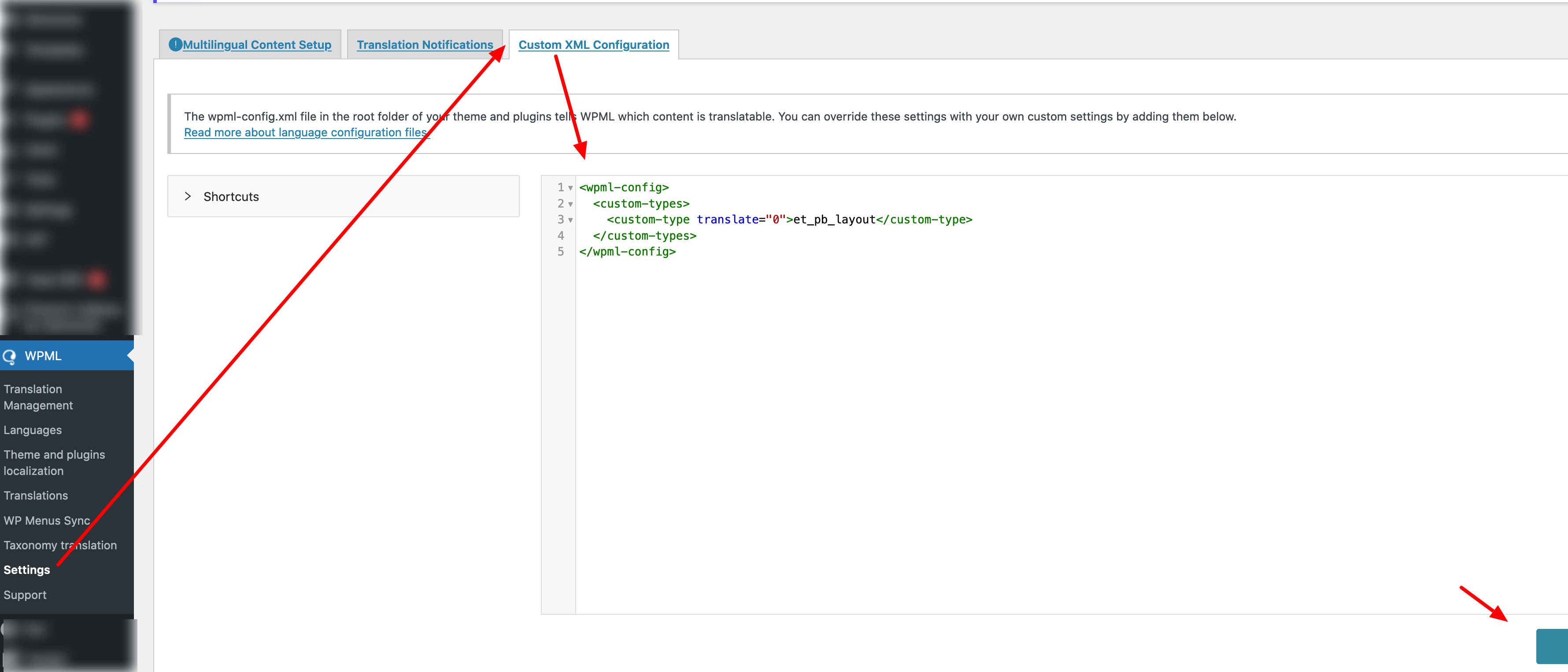

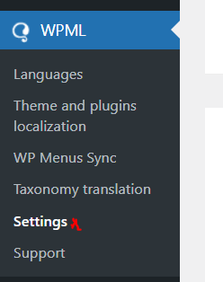

October 9, 2023 at 2:42 pm #14540731
Andrey
Please refer to the screenshot attached. Thank you.
October 10, 2023 at 8:17 am #14547105
adilB-5
I do not have the same screens (see attached)
