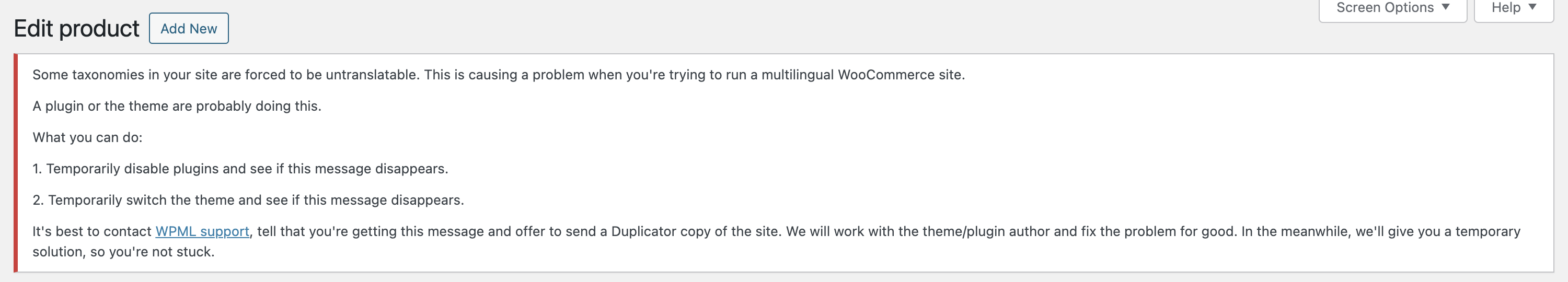

Another piece of information:
The developer of Woocommerce Advance Shipping advised me to turn off the translation for shipping classes. That seems to solve the issue of shipping classes, however I now get the attached message.
Is there a problem with turning this off? If not, can this message (which is now permanently in my admin screen) be disabled?

Thanks for your reply and I can give you access to our test-site. However, I think the main question is simple, is there a need for shipping classes to be translated? If not, is there a way to turn the message we get off?
As shipping classes are not used in the front-end, I see not need to have them translated. The shipping plugin we use can't handle translated classes. I see this as lack of compatibility with WPML, however if there is not need for translation then all I am concerned about is this messge that can't be switched off.

I when I set it to "Translatable use translation if available or fallback to default language", the message disappears but the plugin does not calculate the shipping cost correctly. Setting it back to no translation seems to mess thing up again.
I don't understand why shipping classes need translation, as they are not a front-end thing. I read you don't recommend not translating, but it does seem to work. How can we get rid of error message, which takes up half the admin screen?

Please read the the beginning of this threat again, the plugin works if the shipping classes are set to 'no translation'. They are actually applied to the orders in the other languages it seems (visible in the editor).
There is not much you can do on our site, my main question that I have asked here multiple times now, can you remove the huge error message displayed if the shipping class is not translated?

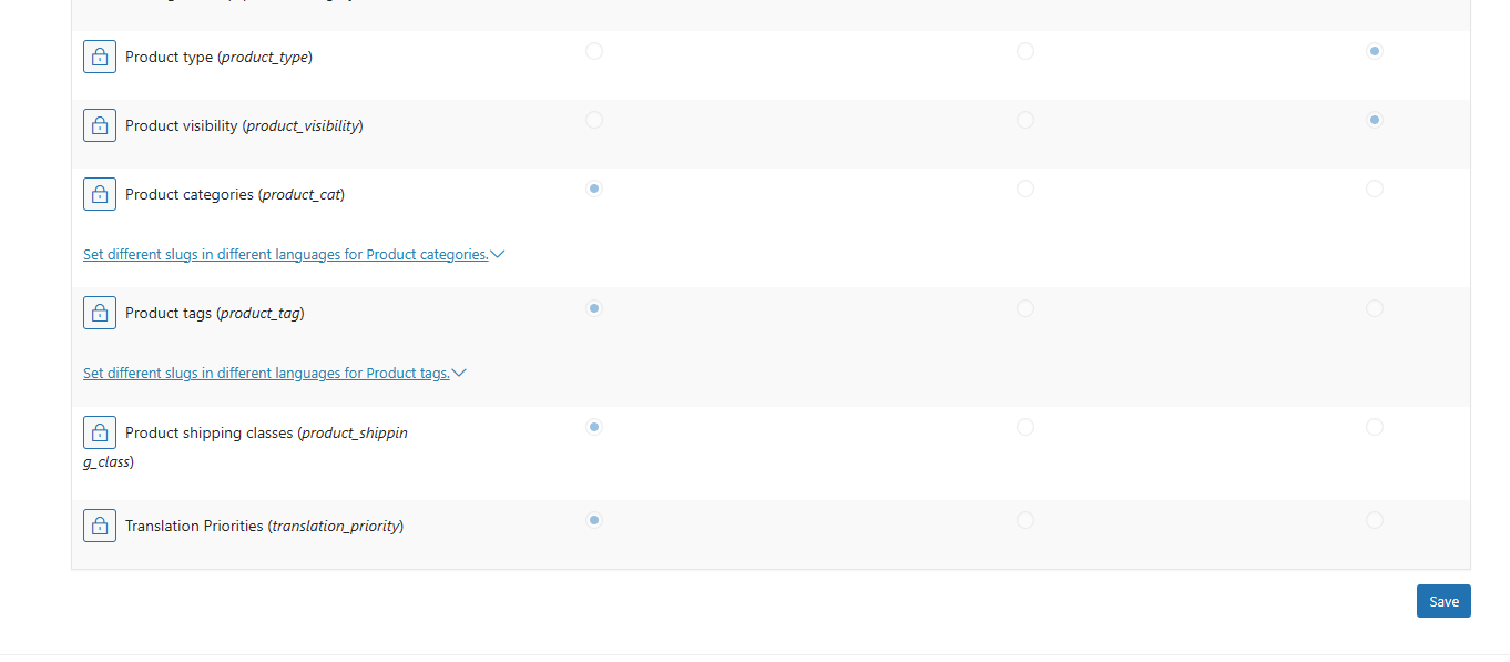

Shipping classes are by default set to "Translate" and the setting is blocked, which means that it is not supposed to be changed.
I am not sure which message you are referring to and where it is coming from. Could you please send me a screenshot of this message?

April 24, 2024 at 3:06 pm #15561454
aukev-4
I did send the attached screenshot before, it seems that as we progress this conversation you forget the beginning of it.
Your software allows me to change the translation of shipping classes, I don't understand that this option is provided if you don't support it. Also my plugin works when the shipping class translation is set to not be translated, and I can't see any use in translating shipping classes as they are not visible on the front end.
I looked at your test site but it does not contain Woocommerce and I am not going to invest the time in installing it.
I simply the attached error message not to show permanently in the admin screen.

I can force this notification banner once I set "Product shipping classes (product_shipping_class)" to an unrecommended setting.
There is sadly no way to remove this message, as it is created programmatically and not saved as an option value on the database. We display this message on purpose and do not make it dismissable as the current setting will cause unexpected issues on the site.
We recommend setting shipping classes to "Translatable" to prevent unexpected issues and this is why the option is locked once our addon "WooCommerce Multilingual & Multicurrency" is enabled. See screenshot.
