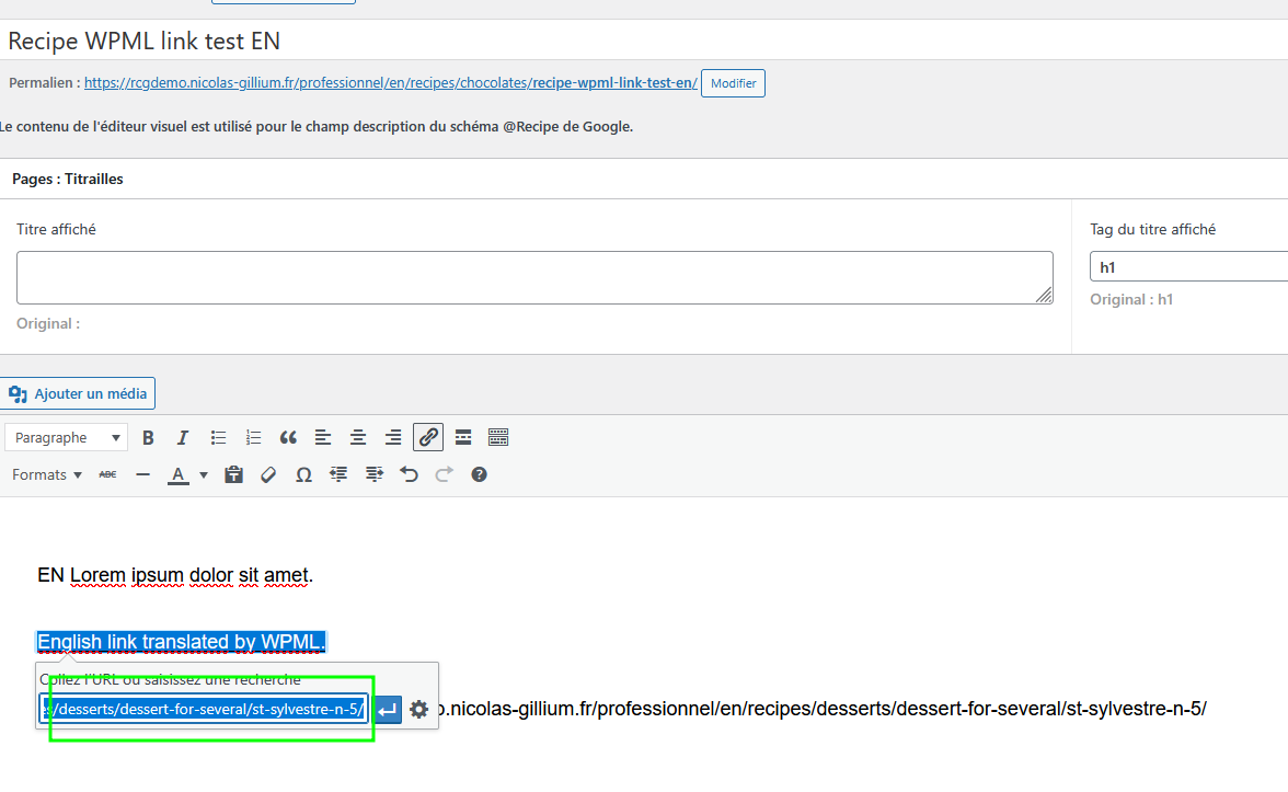

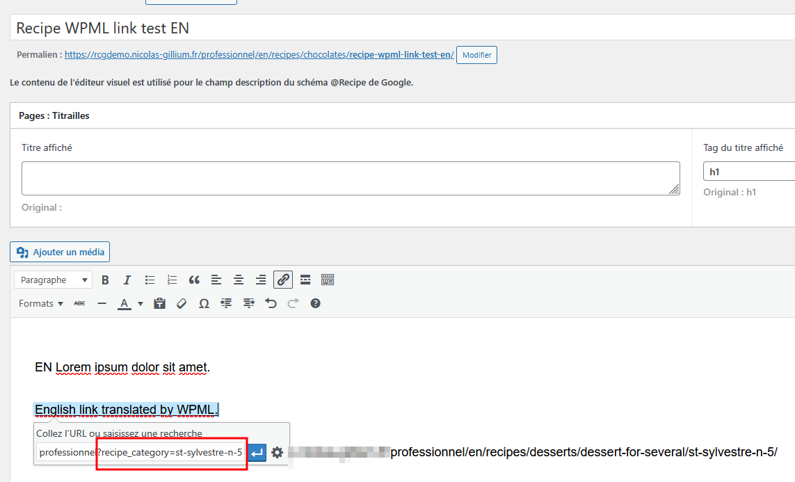

June 9, 2025 at 8:08 am #17117297
nicolasG-15
The administration is not translated for our purpose. Recipe is "Recette" in french.
You have to go in subsite administration : "Professionnels" or "Epicuriens".
Then you simply create a post (Articles) or a recipe (Recette). The label of the CPT recipe is "Recette".
I made a fake recipe for you in "Professionnels" subsite the first recipe CPT : "Recipe WPML link test" in French and the English version : Recipe WPML link test EN.
No need to check the front end part, you can create the link and update the post.

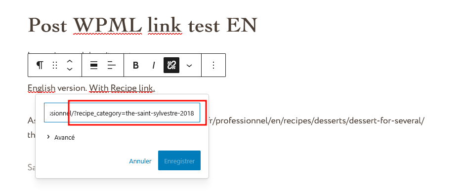

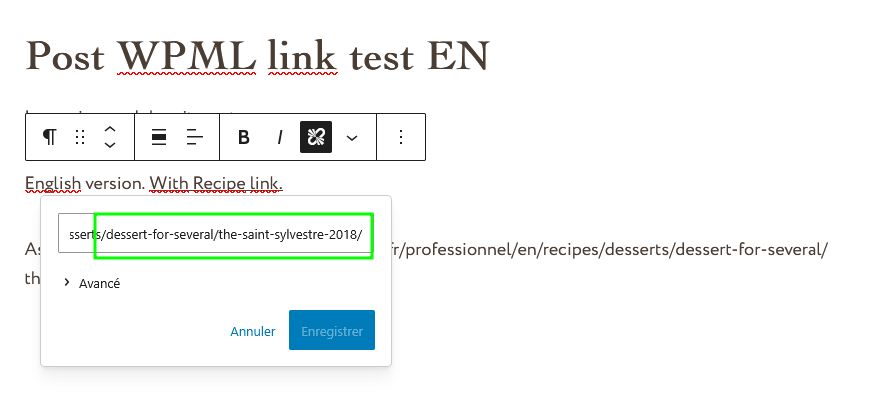

June 9, 2025 at 8:16 am #17117354
nicolasG-15
For the Gutenberg part, you can see the attached screenshot.
Look at the first post "Post WPML link test" and it's translation.
You can set a link with, update the post AND refresh the post (administration part). For this one you can see the result in front end part.

The display shows 1 modified link, but it's always wrong : ?recipe_category=... instead of /professionnel/en/recipes/...
And if I create a link in the english version - Post WPML link test EN - the part of the recipe post type in the URL is transformed again.
