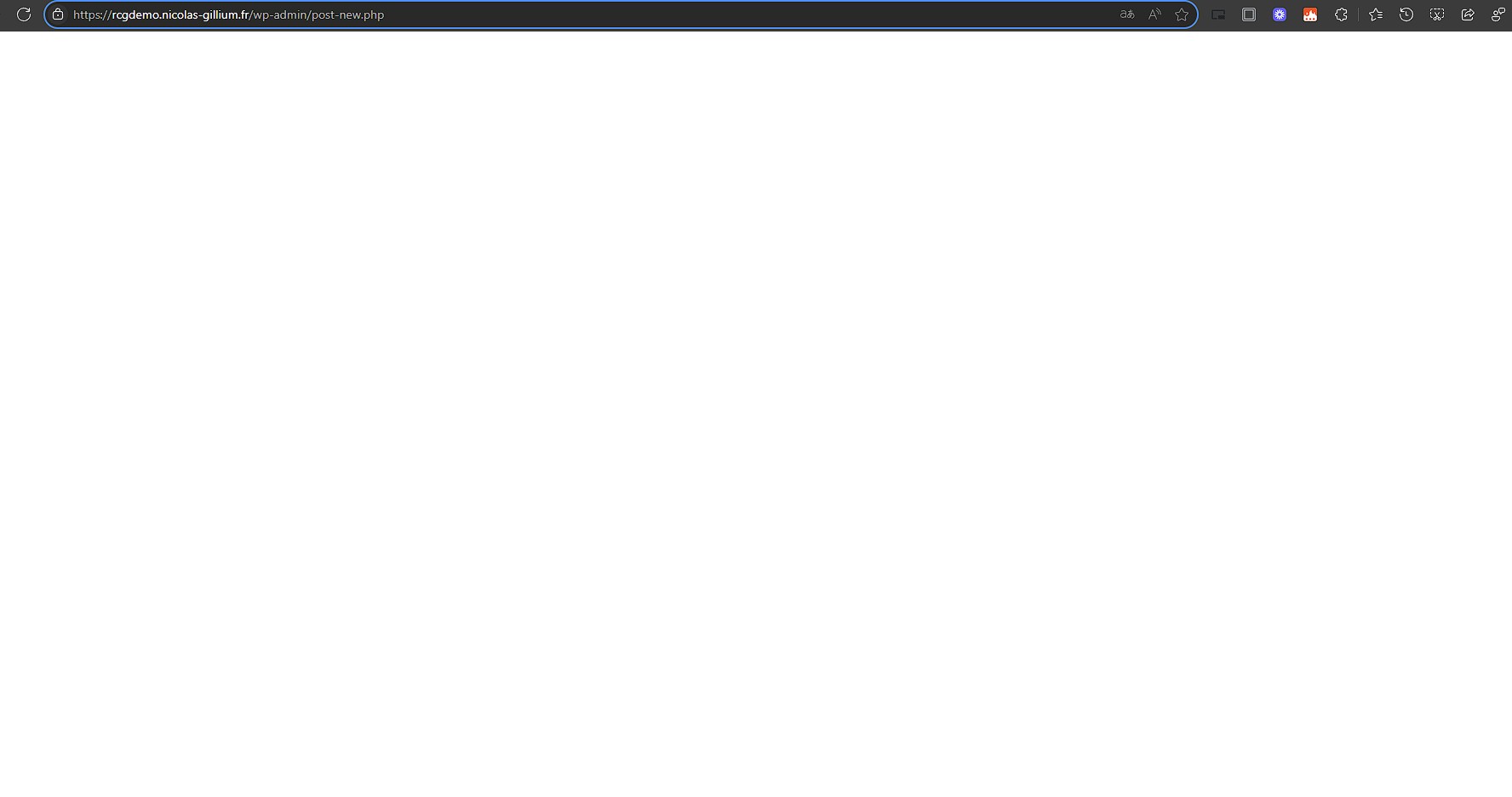

On your test site, it is currently not possible to edit or add new posts.

nicolasG-15
OK let's start from the beginning, you have to "forget" about the first subsite (RCG dispatching) it's just a HUB page for dispatch into the 2 other sites. On the first subsite indeed there is no post, no custom post type you are right.
The posts I talk earlier - and all my tests - is on the second subsite "Professionnal". Here you can do wathever you want.
Same for plugins you have super-admin access rights, I've just checked.
