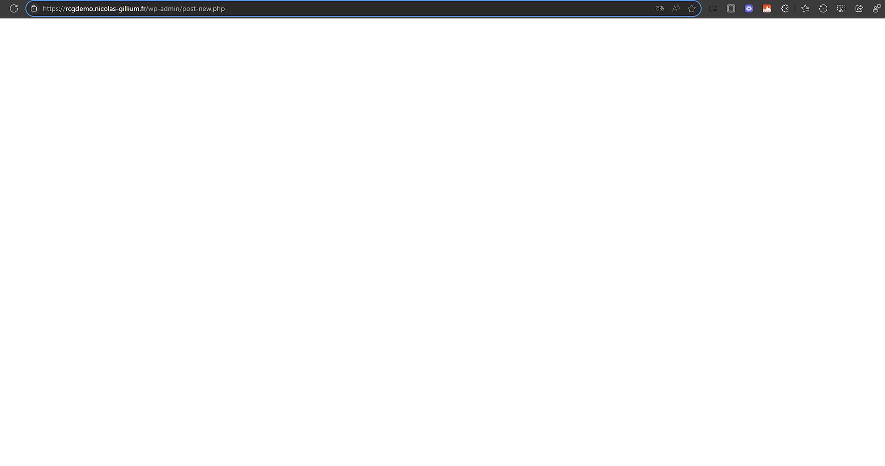

June 25, 2025 at 10:28 am #17168684
On your test site, it is currently not possible to edit or add new posts.
Is it possible to disable plugins on this Multisite Network to test what is causing this issue?

nicolasG-15
OK let's start from the beginning, you have to "forget" about the first subsite (RCG dispatching) it's just a HUB page for dispatch into the 2 other sites. On the first subsite indeed there is no post, no custom post type you are right.
The posts I talk earlier - and all my tests - is on the second subsite "Professionnal". Here you can do wathever you want.
Same for plugins you have super-admin access rights, I've just checked.
