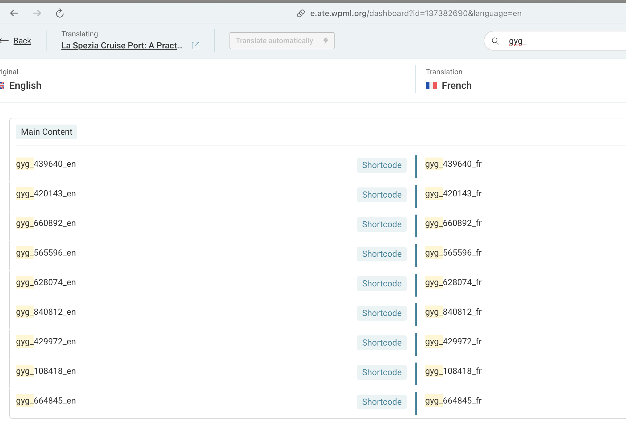

Our second-tier supporter has been investigating this issue and communicating it with our Advanced Translation Editor developer. However, he now needs another example page where this problem occurs, because the hidden link you gave as an example seems alright now. When the second-tier supporter checked this page in the Advanced Translation Editor, he could see that all the gyg_ shortcodes are translated. He shared with me the attached screenshot.
Can you please send us an example of another page where this problem occurs?
