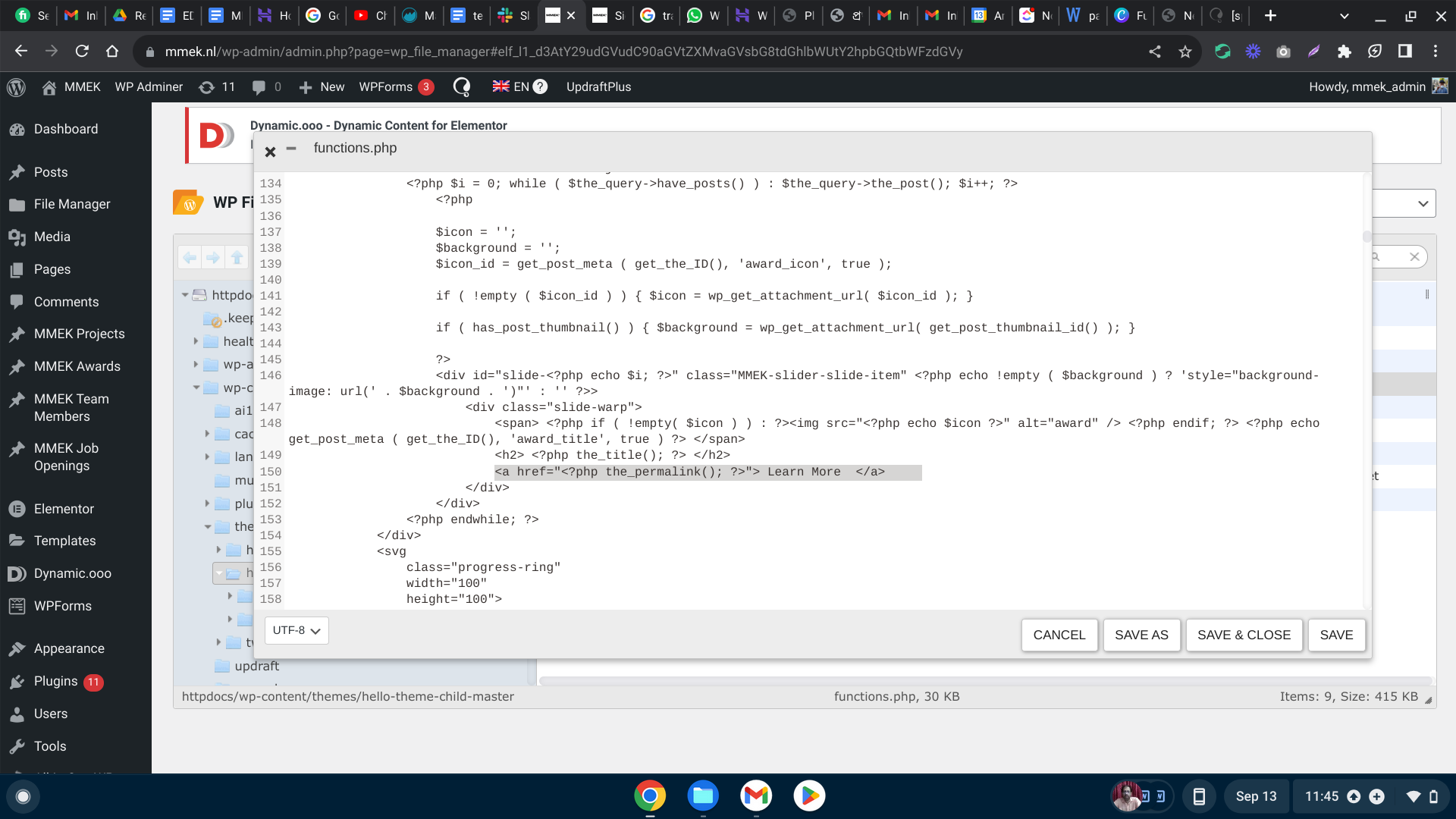

We have already resolved the translation issue of the cookie policy and now having issue to translate the text in functions.php file in the child theme. Please check the attachment to see more and help us to figure out the solution salfely.
Just wanted to let you know that we have created the slider codes before the decision of the Multilingual site. So now just wondering if it's possible to translate easily or we need to do some major coding or restructuring for this issue again.

OK, that's fairly straightforward.
Whenever you add texts in PHP files like that you need to prepare them for internationalization (known as "i18n" for short) using gettext calls. (This isn't specific to WPML.)
We describe that in our documentation here: https://wpml.org/documentation/support/translating-the-theme-you-created/#using-gettext-functions-in-php
So the line in your child theme from the screenshot that outputs the Learn more text would be wrapped in a __() function call, like so:
<a href="<?php the_permalink(); ?>"> <?php __( 'Learn More', 'mmek-theme'); ?> </a>
I used "mmek-theme" as the text-domain, as I don't think you are using a particular text-domain already.
Then you can go to WPML > Theme & Plugins localization and scan your child theme so that WPML can find such texts and make them available for translation.
You should then be able to go to WPML > String Translation and find the texts and translate them (you can filter by the text domain you used, e.g. "mmek-theme" if you use the same as my example above).

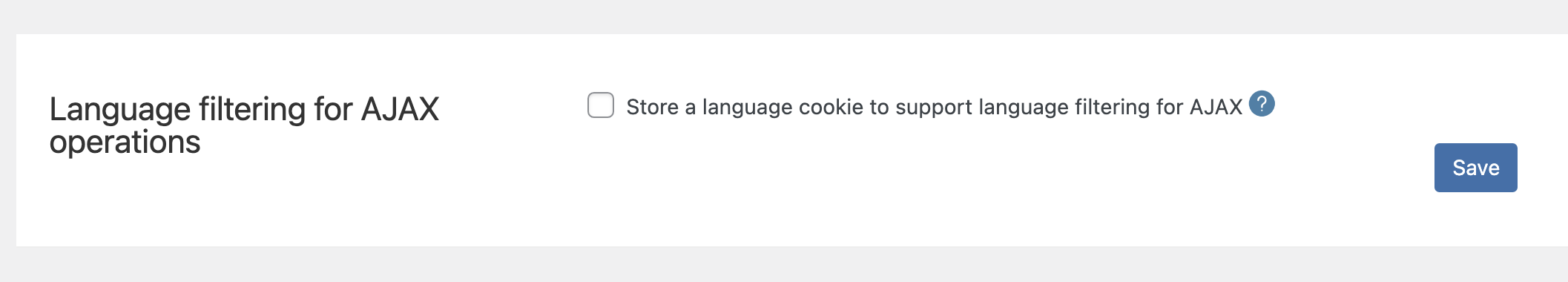

I'm not sure I can see the problem you describe in 1, but in any case it is almost certainly because you need to activate the setting for language cookies in support of ajax requests (screenshot). I have set that for you, so hopefully you should now get the expected behaviour on the Dutch page.
