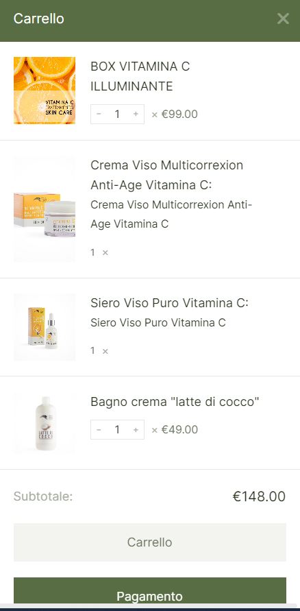

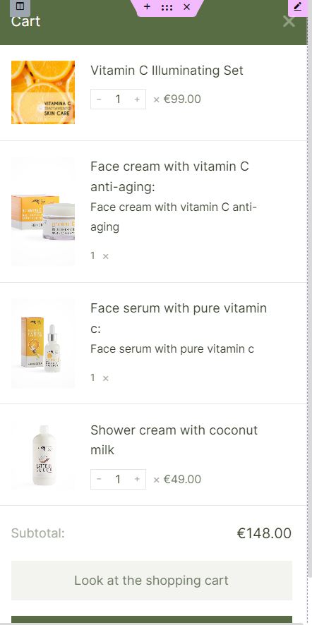

1. this is the video of the checkout when i try to switch languages.
2.Actually, the mini-cart was included in the theme, thus i had not to install/set up anything.
I have done both translation in the string translation and the mini-cart translation in the saved templates, which in theory should display the correctly, but it isn't.
Please inform me if you require additional details for a clearer understanding.

1. The issue happens when the composite products are in the cart apparently.
2. The theme's default language is English, so in order to translate the mini-carts content i managed to switch the languages' default. In the backend, the translations are done correctly, but they do not show in the front-end.

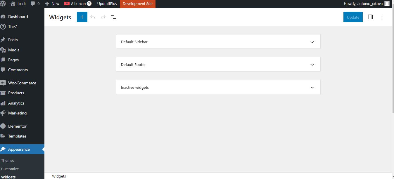

so when i try to add the following step after doing the cart reset when the language is switched: Showing the list of items cleared from the cart
these are the widgets available...

Following the link you shared in our previous conversation, I successfully managed to implement the step of resetting the cart when switching languages. However, I'm currently facing difficulty with the next phase - showing the list of items that were cleared from the cart. The photo I provided previously showcases all my available widgets.
Could you please guide me on how to proceed in order to align with the instructions provided in your link? Your assistance in navigating this step would be greatly appreciated.

The screenshot you shared shows the widget areas. You need to add the widget in the desired area to display the products that were removed from the cart. In this link you will find the official guide from WordPress to manage the widgets on your site: https://wordpress.org/documentation/article/manage-wordpress-widgets/
