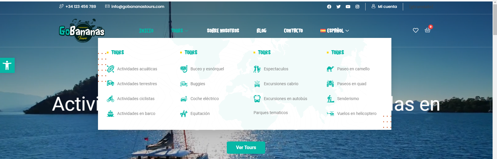

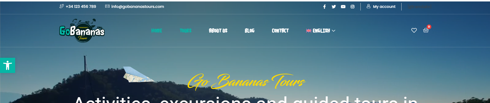

Here's the problem again:
the translated navigation menu on all pages doesn't have the dropdown menu I created on the original nav menu using elementskit. I'll attach a screenshot of the original and what I get on the translation pages.
I tried to enable the megamenu content for the translation menu all to no avail

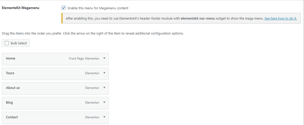

the main menu was created using the normal Appearance -> Menu. I've had the main menu translated and it displays.
However, the dropdown was custom created using elementskit megamenu. This doesn't translate with the menu and therefore the menu shows as having no dropdown.

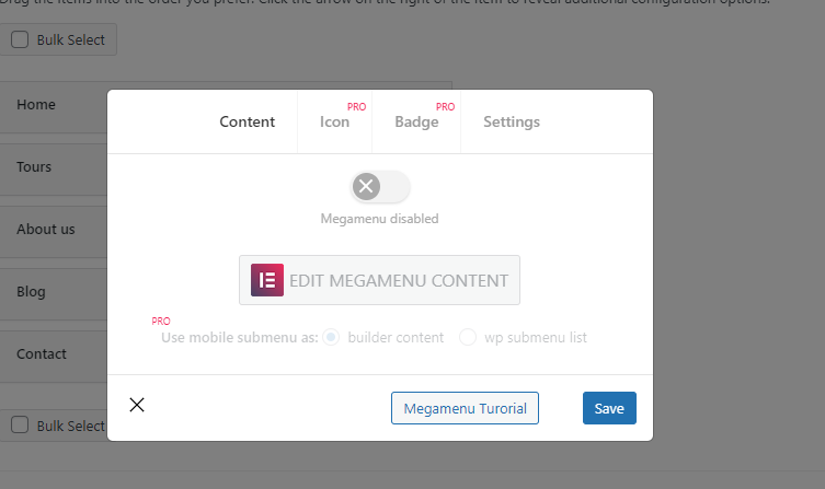

I try to do this manually, however when I click on enable megamenu and try to edit the content, I'm presented with
'{"code":"rest_no_route","message":"No route was found matching the URL and request method.","data":{"status":404}}'
If I try to save, it keeps loading and actually don't save.
This is not so on the original language menu.

I was able for Elementor to open by settings language URL as per their docs, but still settings don't save.

our 2nd tier checked and found that you have enabled the mode "Track where strings appear on the site" in the WPML String translation.
When disabled, the mega menu mode is saved and working fine.
You can continue to build your mega menu for 2nd language and save.

Actually; unticking 'track where strings appear' didn't fix it
I got a solution of changing the permalink structure from another supporter which worked.
However, I have to create each mega menu for each of the language I'm trying to translate manually.
Also, the menu images I added with the plugin 'menu image' didn't also duplicate and I have to do those manually as well.
