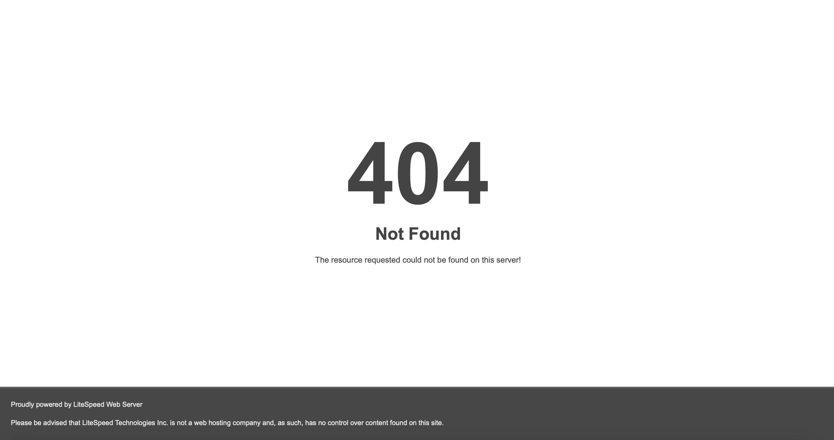

Now it's better, thank you and all the images are there again. However, there's is two issues persisting. For example, when you change the language and go to "our rooms" in the menu, now it's ok but if you refresh da page it goes to a 404 error. The other one, that it's not new, is about the checkout cart. You can make a complete an order in Portuguese, but in any other languages when you should go from the Amelia reservation to the woo commerce checkout it gives another 404 error page. I noticed the there is two pages for each language of the checkout page. (you can make all the reservations you need to test because you have the option to pay on location - "pagamento na entrega"

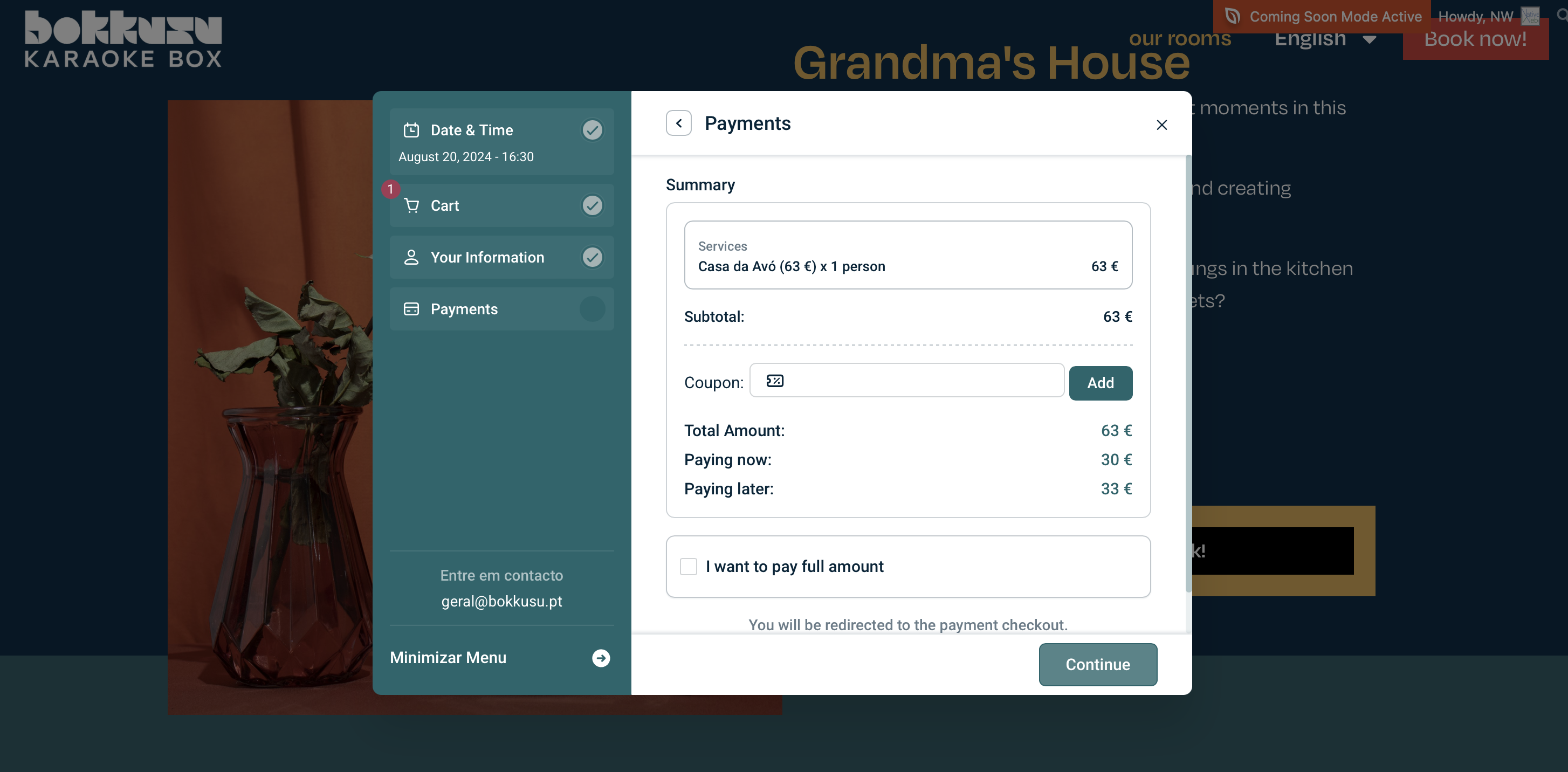

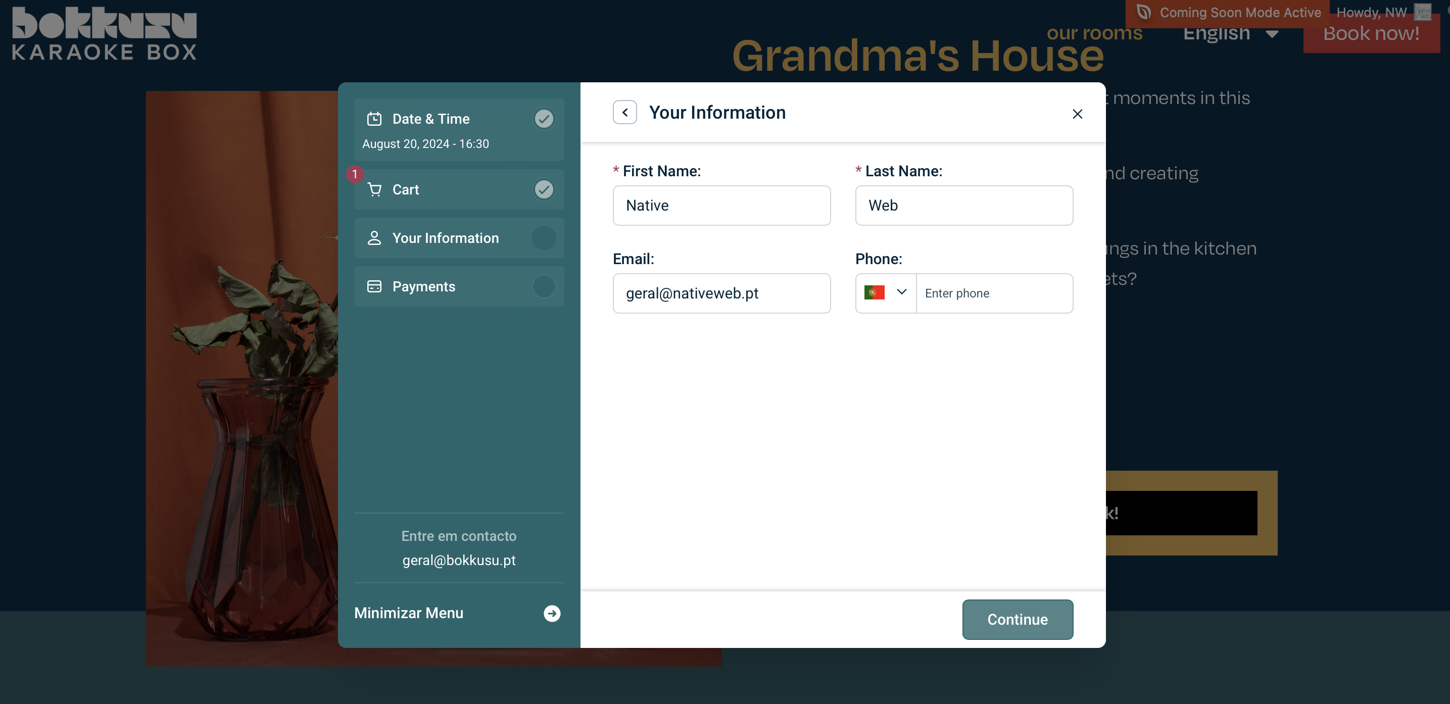

Yes, the design is ok. I made a backup restore and follow some of your previous advices (memory limit and elementor content translation) and now seems the design is working well. Related to the 404 error is still there and it is difficult to understand because it works just in portuguese, so it seems the server shouldn't be the problem. I did what you recommend, erase all the duplicate pages not used and even change the slug to the original but continues to give the 404 error when it should goes to the checkout page. I don't know how to make a staging website. I will upload some prints to explain the 404 error in English for example.
I'm not an expert but I feel like is something related to cache or something related to Amelia and woo commerce communication by wpml translations of endpoints maybe?
Because if you try no go directly by url to the checkout page in any language Bokkusu.pt/checkout it opens the page correctly but when you finish the purchase it gives another error agains instead of come back to the finish page of Amelia like it does in the original language, Portuguese.

After contacting the server supplier he replied the problem was with bad configuration of wpml plugin because of the automatic rules written in htaccess file because de rules are changing with the language and it's not supposed. In this way, if we change again a language, because of the rules have changed with the previous language alteration, it will give the 404 error. The rules surfing the website are always over written so changing manually doesn't solve.

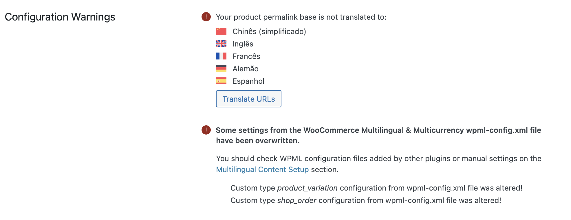

Finally, I want to check with you if the two warnings in the status (image above) of woo commerce multilingual are ok or is something missing because when I look at endpoints they seem all translated.
August 16, 2024 at 2:10 am #16076542
Right, those WCML config issues needed to be fixed and I have been able to fix a few of them now.
The issue that remains is that it seems that the product permalink base is not translatable. I tried translating it, but no success.
This would mean, that for example in German the products would use (reserve) as slug base, instead of "produto".
This is something and need to be investigated further and needs proper testing.
