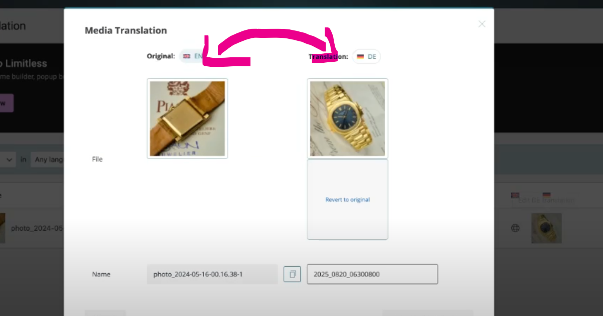

we have checked and seems this is expected and can happen when WPML translated image is different, which is done via WPML Media addon. by your or some other user.
So you have now a default image which is a correct and then translated image for DE. If you want to remove that you can go to WPML media and revert the changes, for example as I did here:
- hidden link
Video: hidden link
Then it will show same image when WPML enabled or disabled.
Drazen
September 9, 2025 at 2:27 pm #17387496
julianM-23
thanks for checking!
It's very strange because definitely nobody would set a totally different translated image for a product. That wouldn't make sense for potential customers.
It's even stranger because those exact affected images were those who didn't and still don't appear in the library...
And while I understand the logic behind the translated media stuff, this doesn't seem to match. If we stick to our post "Patek Philippe Nautilus ref. 3800/1". Why would we change the translated image for the image that shouldn't be there in the first place? Like the image "photo_2024-05-16-00.16.38-1.jpeg" you edit at 00:03 - 00:07. That's definitely not an image that's there by default. The images for that post look completely different. Wouldn't you edit the EXACT opposite (see screenshot)?
Another hint for that is your refresh at 00:10. All the product images were correct because I guess you disabled all WPML plugins before. Now you refresh after having them enabled and after changing that translated media image but that media translation you just unset is wrong anyway. You see it's a completely different watch.
And now that you edited that specific image for example it *completely* appears to be attached to that post. Even if I disable all WPML plugins it's still in that post. It's also visible in the frontend which was never the case even though the images in the backend didn't match...
Maybe we're on the right path but for me this doesn't seem to match.

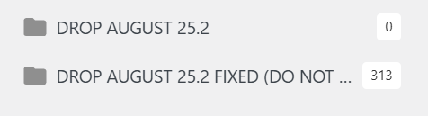

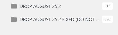

September 11, 2025 at 1:06 am #17392424
julianM-23
I did as I said and went ahead and downloaded all images that were affected by the upload bug in the first place (see https://wpml.org/forums/topic/wpml-replaces-uploaded-images/) with WPML disabled and then reuploaded them with WPML enabled.
My folder shows 313 images but when I disable WPML it shows 626. It duplicated every image (luckily no random images from one year ago).
Is that normal behavior because I have 2 languages?
I attached all the images.
