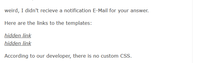

If you are still having the problem, please fill in the private details fields after a full site backup. I would like to access the admin area of your site for further checking. Refer to the following links for more details about our private information sharing policies.
Please note that the links shared in the tickets are only visible to the person who created the ticket and forum moderators like us. Refer to the attached images for more details
