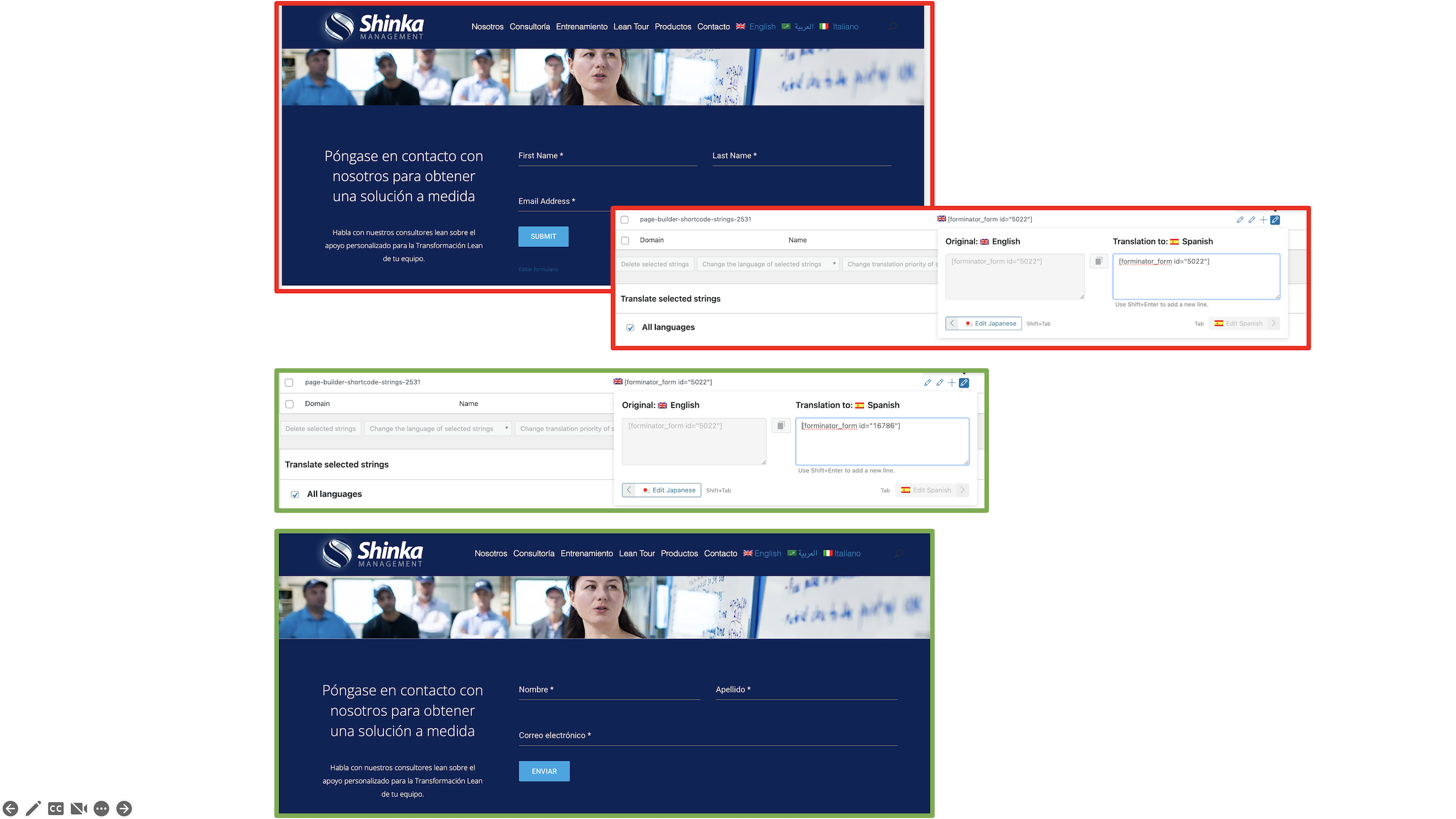

September 17, 2024 at 4:51 pm #16189991
paulS-91
I am trying to translate a form from English to Spanish using WPML on my site hidden link. Specifically, I am translating [forminator_form id="5022"] (ENG form) to [forminator_form id="16786"] (SPA form).
The translation works for a moment but then reverts back to the original English form [forminator_form id="5022"].
Why does the translated form revert back to the original English form?
How can I ensure the translation remains stable and does not revert?
September 17, 2024 at 9:10 pm #16190708
It looks like this shortcode is coming from WP Bakery and you can not translate it directly on WPML String Translation, as the translations are coming from a page that is translated with the WPML Translation Editor.
The WPML Translation Editor (here Advanced Translation Editor) does not yet allow to translate such shortcodes.
We do have a workaround for this purpose, which would allow you to translate the ID of the form with the translation editor, but you would need a Child Theme to be able to implement it.
Would it be possible for you to implement a Child Theme for The7 Theme on your site?

September 20, 2024 at 12:48 am #16201002
Hello Juan,
Please give it a try.
First, at WPML > Settings > Custom XML Configuration (tab) enter this XML markup to make the shortcode translatable:

Now, edit the form shortcode on the original content and open ATE. If you can not directly see the ID please try to search for it inside the search bar on top.
Now, when translating your content, translate the ID and replace it with the correct ID of the translated form. (each form has its proper ID)
I hope this will solve the issue for you. Take note, that this will not be solvable with automatic translation. You will need to adapt the IDs manually inside ATE.
