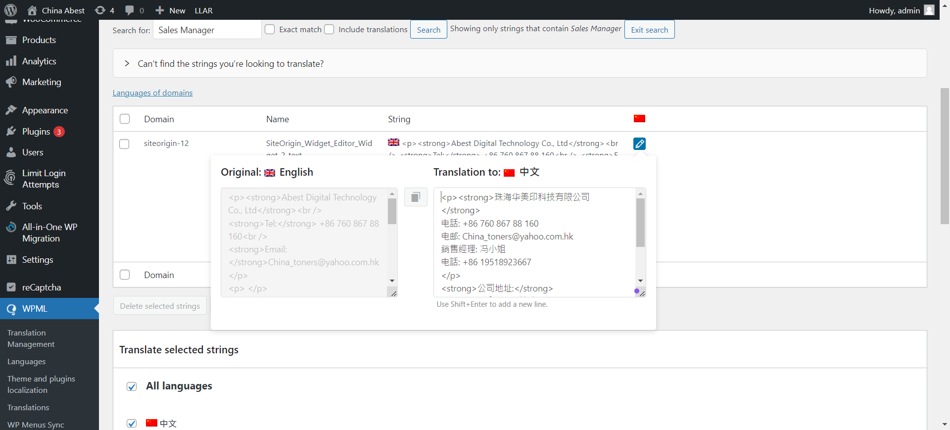

May 1, 2024 at 4:33 am #15583029
kevinT-10
Hi Anreas
Thank you for your help on this matter.
You mentioned this way I readed and knew how to translate, another WPML supporter colleague - Lauren helped us on yesterday.

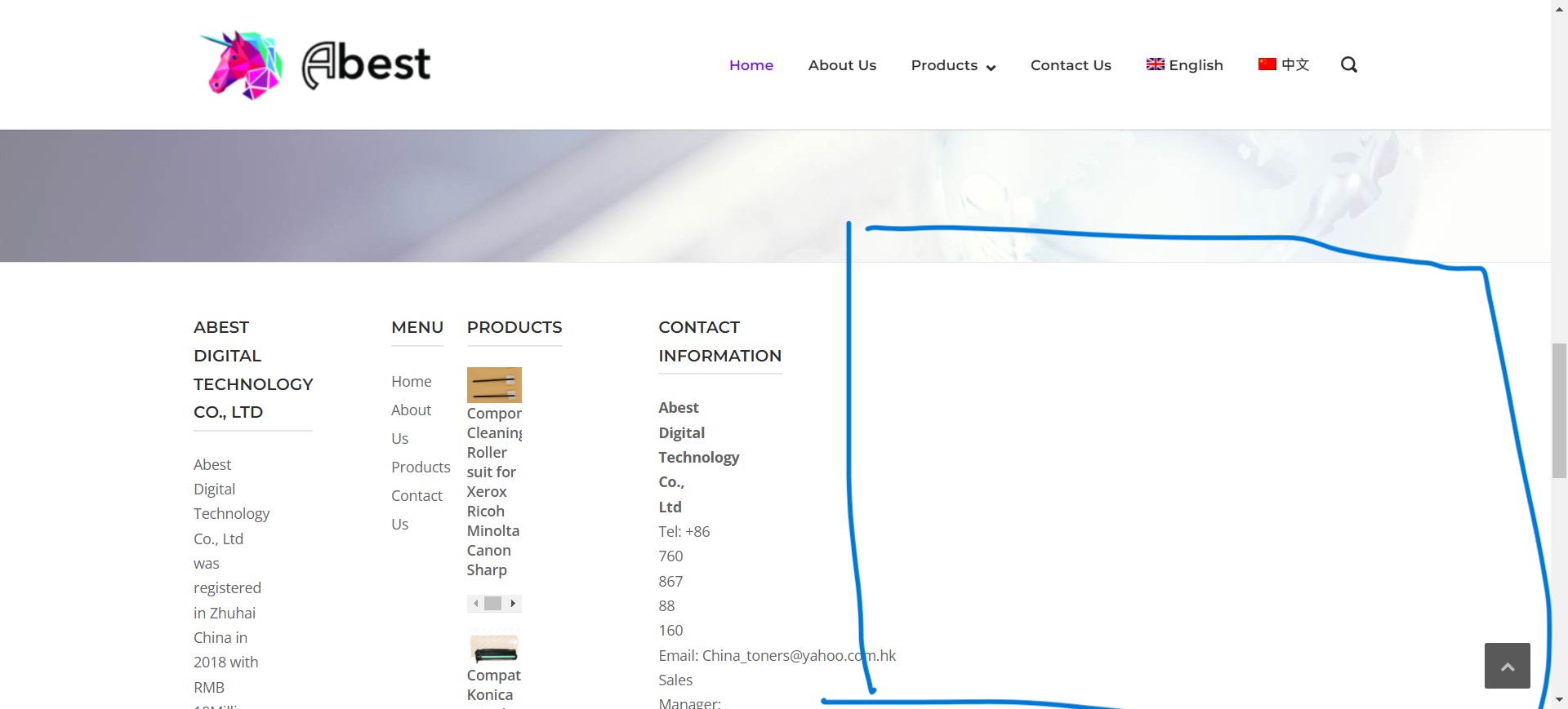

We found that the string translation unable to work or update.
Fortunatly, we checked the content text have been updated suddenly today, but the title text still not to be updated.
(Image1 - the content suddenly to be updated)
(Image 2 - Title unable to be updated )
I think some WPML String data is unable to update properly. Any idea it can be clear or flush in WPML string translation.
Thanks and regards
Kevin
May 1, 2024 at 4:37 am #15583058
kevinT-10
Updated message.
You can see the screen capture - we successfully update the content text, but the next moment, the content text jump back to english.
Please see update the url - hidden link
I think this this is a bug or error in wpml, any idea to be fixed.
Thanks and regards

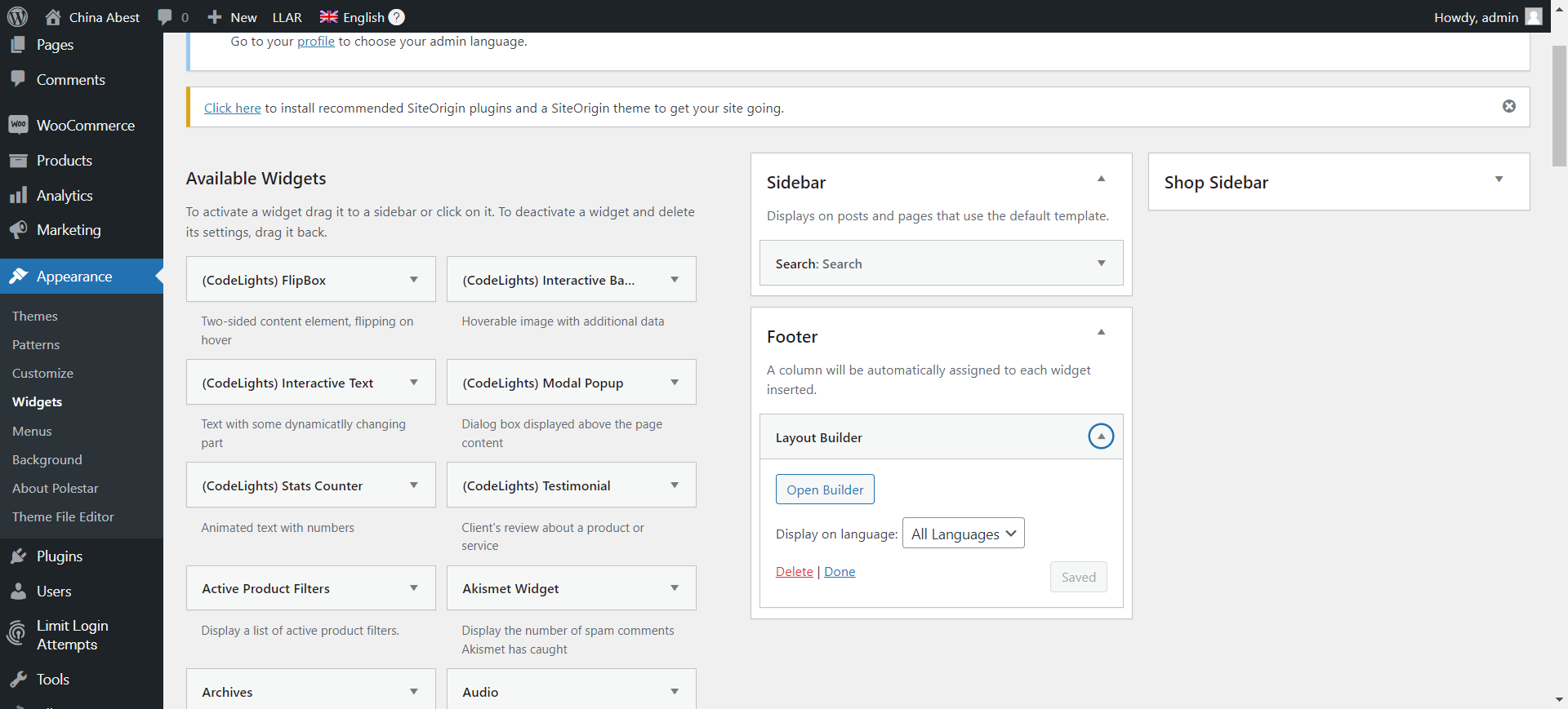

May 2, 2024 at 3:00 pm #15588206
One way would be to use one widget and translate it with String Translation.
Another way would be to create one widget per language. Did you give this a try already?
Guide: https://wpml.org/documentation/getting-started-guide/translating-widgets/#using-different-widgets-for-different-languages

It looks like translating Site Original with String Translation is not a working solution in this case. As I mentioned earlier, any page builder content is not supposed to be translated with String Translation and you are using a SiteOrigin Page Builder Layout on this footer.
I have now assigned the widget to English and created a second widget for Chinese.
Please build a layout for Chinese now, which should solve the issue.
If this is not an acceptable solution please let me know.

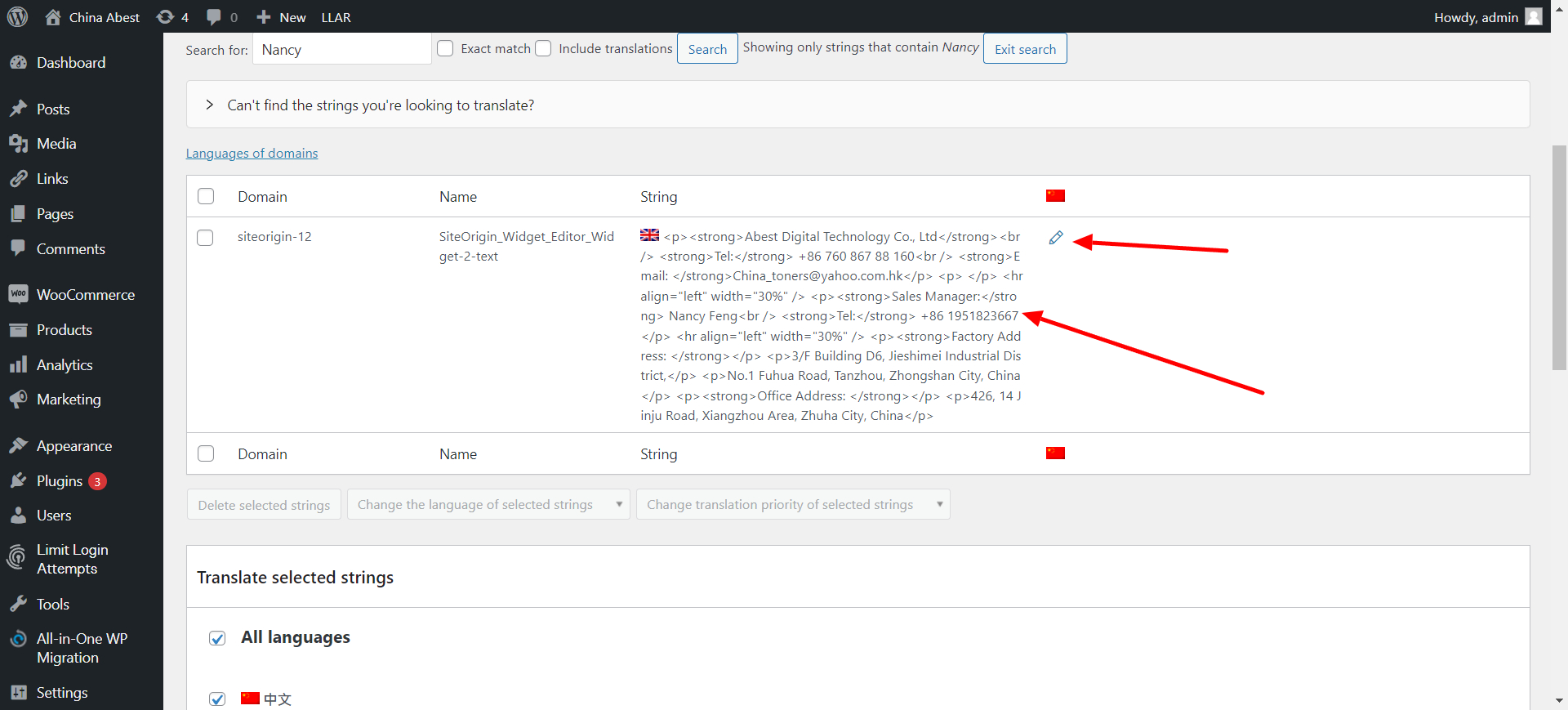

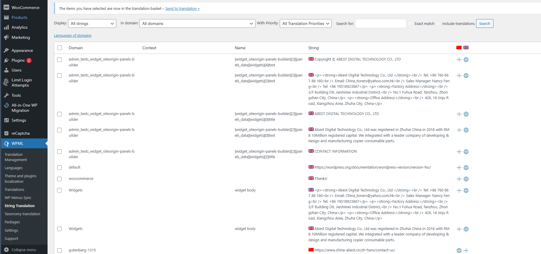

My apologies, it seems that creating one widget per language is not a solution in this case.
I was now able to locate the strings for these widgets at WPML > String Translation > Translate texts in admin screens (link at the bottom of the page) and added them to the String Translation module.
Please test the translation again now.

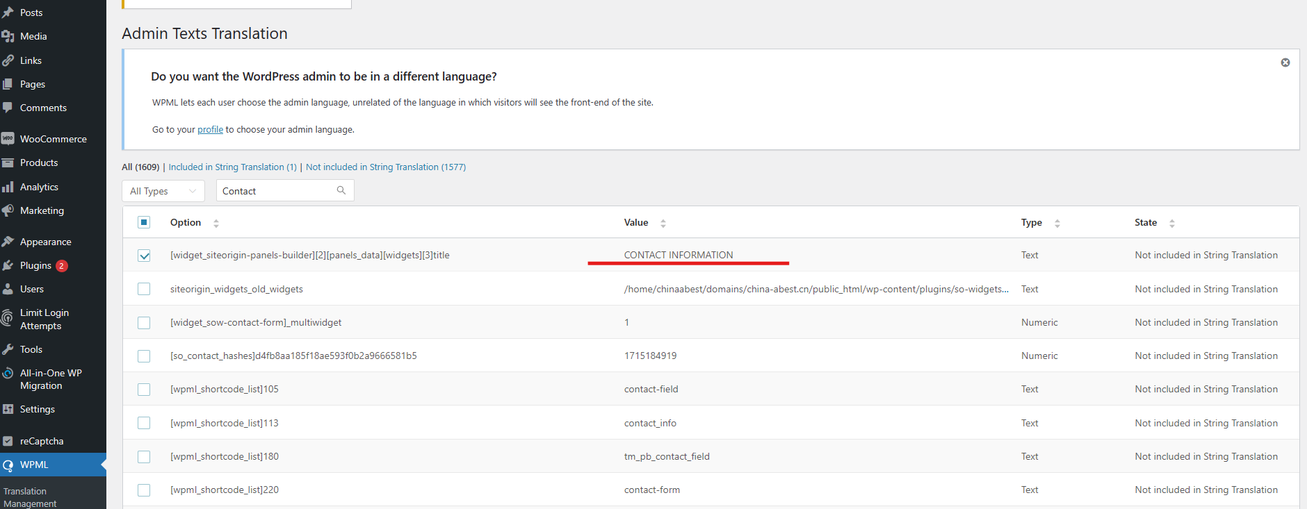

May 13, 2024 at 4:43 am #15618392

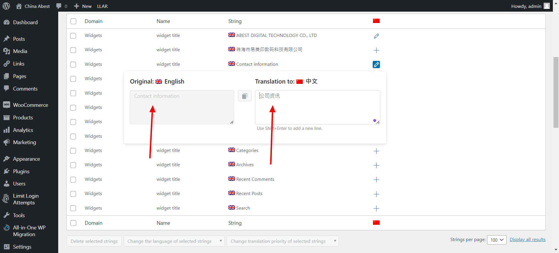

kevinT-10
Hi Andreas
Thank you for your help,
Now we can translate the widget body text to chinese, however, the widget title still cannot be located.
this few days, I tried to add string text title, but still faliure.
Could you help me to check again. thanks
Kevin

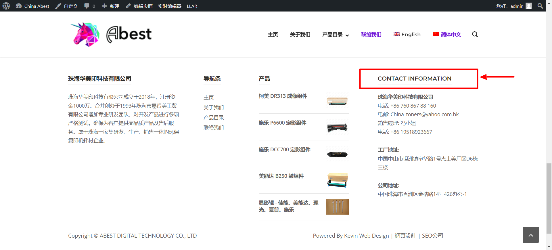

May 14, 2024 at 2:46 pm #15626111
Hello Kevin,
I have saved a custom config at WPML > Settings > Custom XML Configuration which seems to solve the issue.
Guide: https://wpml.org/documentation/support/language-configuration-files/translate-strings-in-wp-options-table/
Best regards
Andreas
May 16, 2024 at 2:44 am #15632610
kevinT-10
Thank you Andreas, the issue is fixed.
