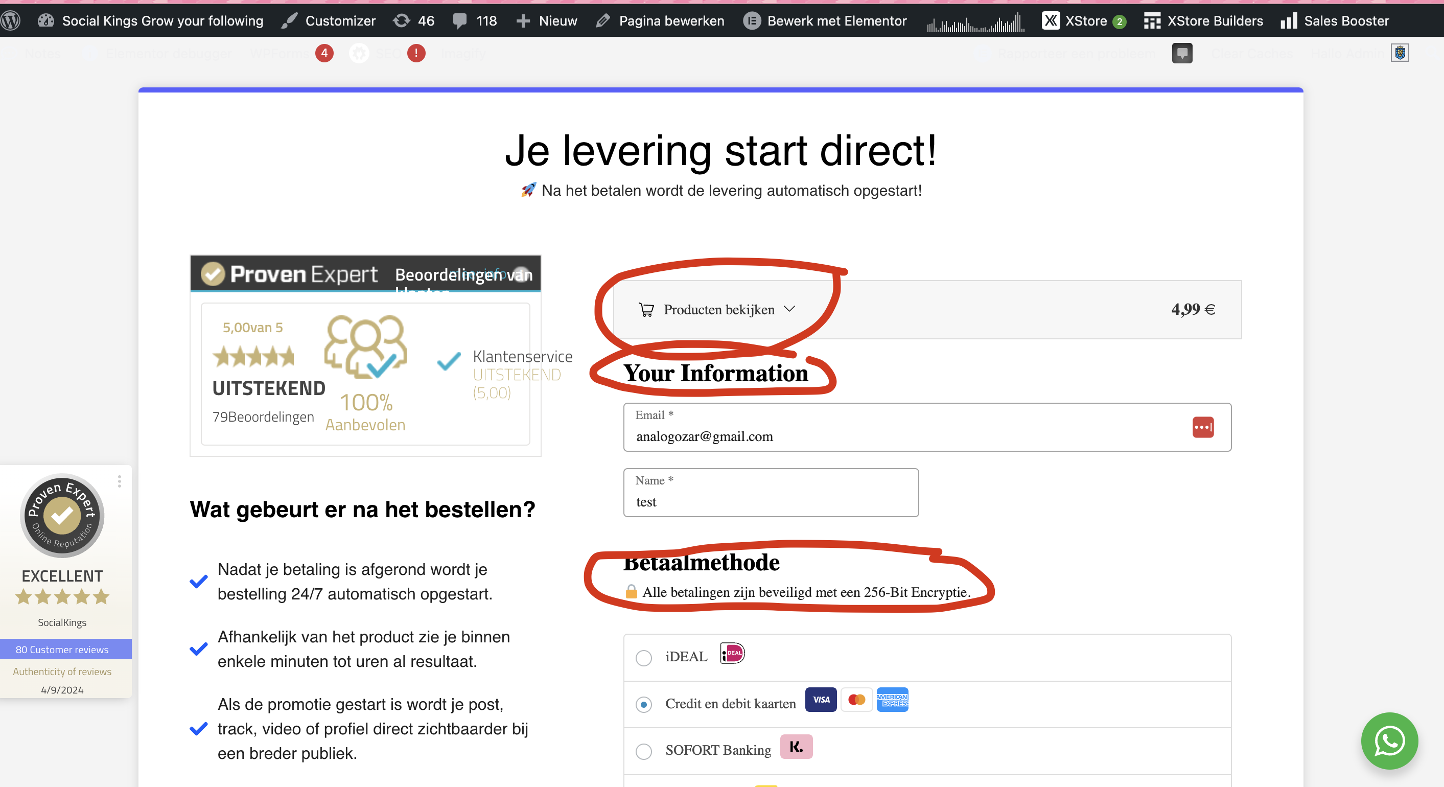

I am trying to translate the woofunnel checkout but the translation strings are not appearing. I tried all the steps described in https://wpml.org/documentation/getting-started-guide/string-translation/finding-strings-that-dont-appear-on-the-string-translation-page/.
I tried several times but they are still not showing.
Can you help me please?

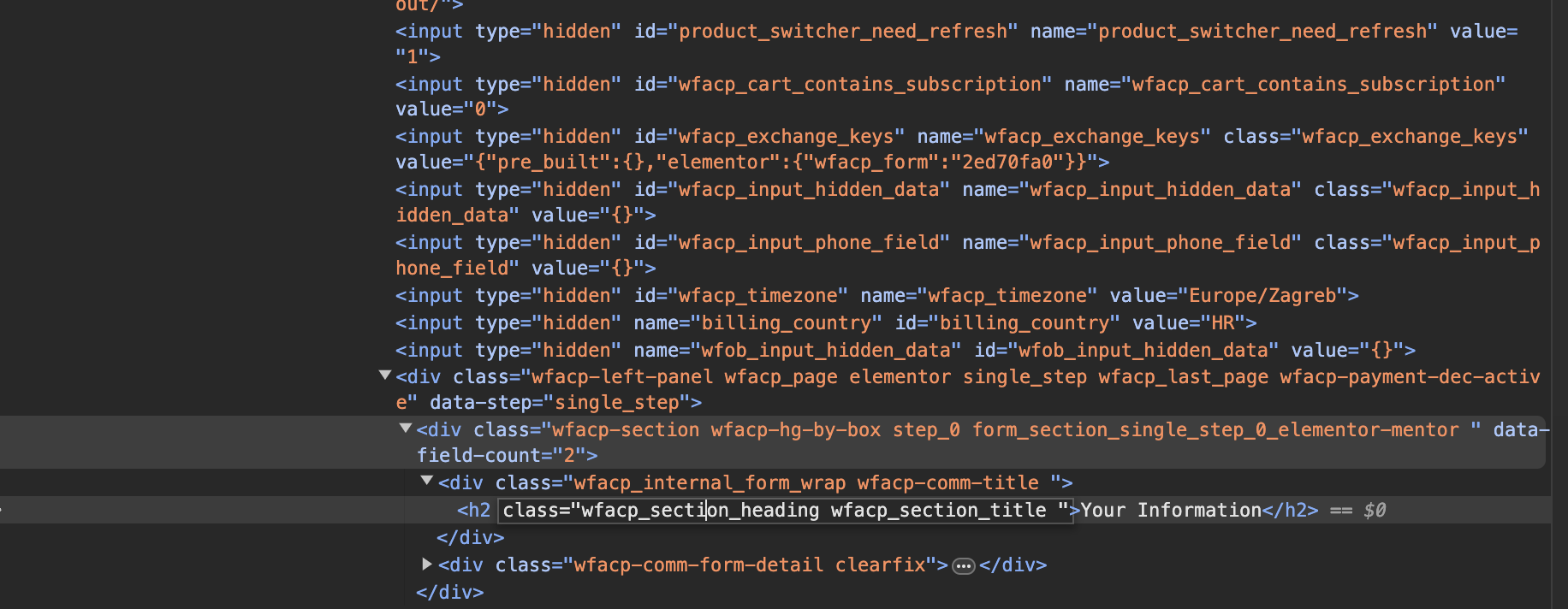

You indicated in your previous message that the Texts are included through dynamic fields. It's possible that the translation setting for those fields hasn't been configured to "Translatable." Could you please provide a screenshot showing where you're adding these texts?
To delve even deeper, you could use your browser's inspection tool to inspect the field and determine its ID. With this ID in hand, you can go to "WPML > Settings > Custom Field Translation," search for the field by its ID, and change its setting to 'Translatable' if you find that in the result.

April 10, 2024 at 6:52 pm #15506263
anaL-5
I added a screenshot to the first message.
I tried using the inspection tool to find the ID but I can't find anything like that in the list of domains in the string translation. I tried that is why I mentioned it is dynamic fields. They are not showing in the translation editor when I translate the rest of the elementor page, the rest is translating fine. It is only the checkout form, checkout button and text below the checkout button.

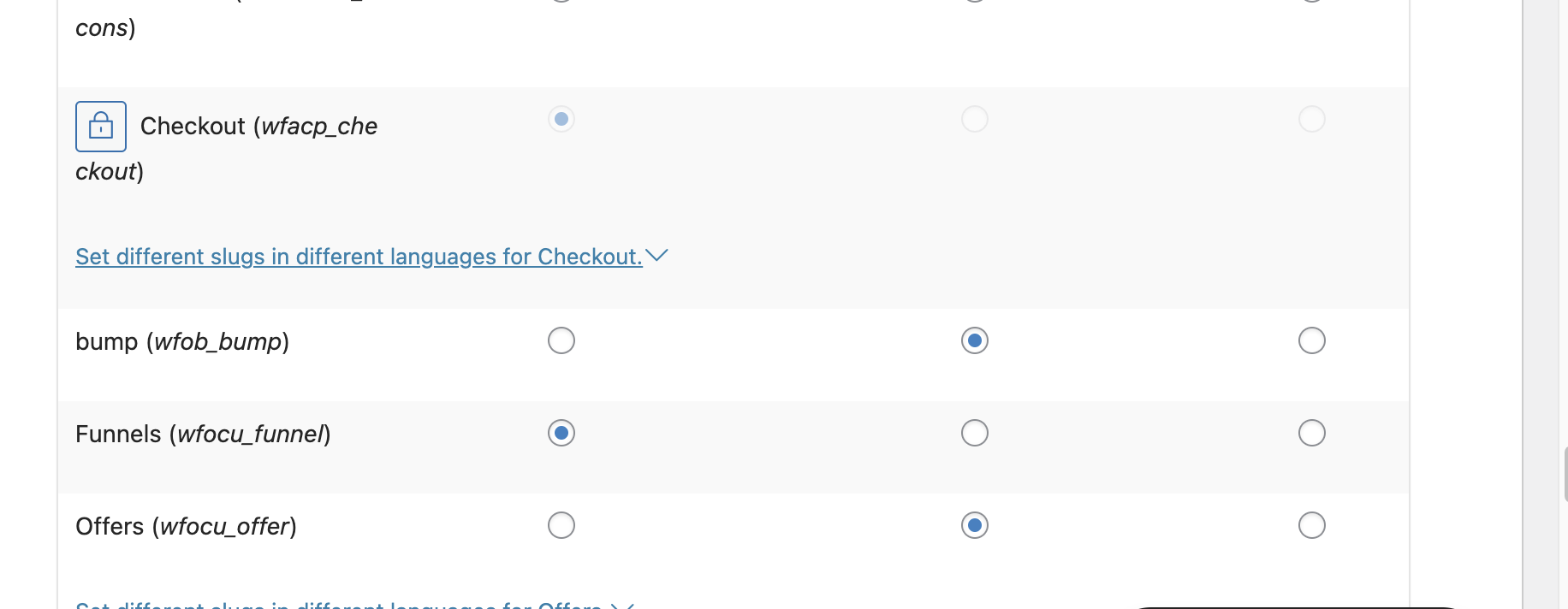

April 10, 2024 at 7:04 pm #15506303
anaL-5
also i added the post type
