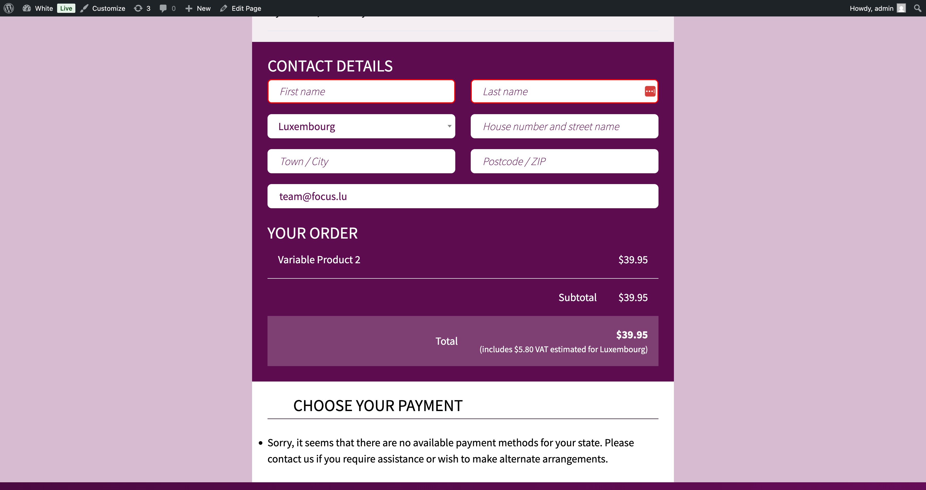

May 21, 2025 at 4:17 am #17054884
Shekhar Bhandari
WPML Supporter since 03/2015
Hello there,
I followed your steps and I can see the following on checkout page, am I missing something?

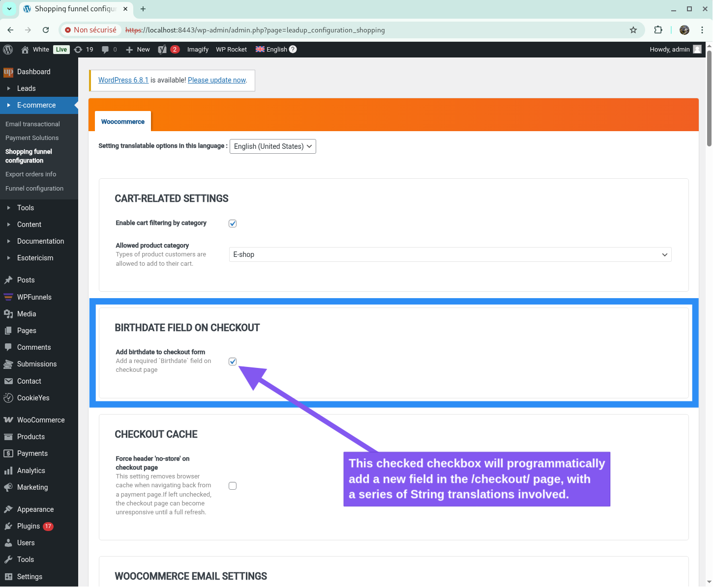

Then, can you please go on:
/wp-admin/admin.php?page=leadup_configuration_shopping
and according to my screenshot, there is a checkbox supposed to add a Birthdate field in the /checkout/ page. This field comes with a series of String translations, such as "Birthdate" under the "leadup-frontend" domain/context.
Please also translate those associated String translations.

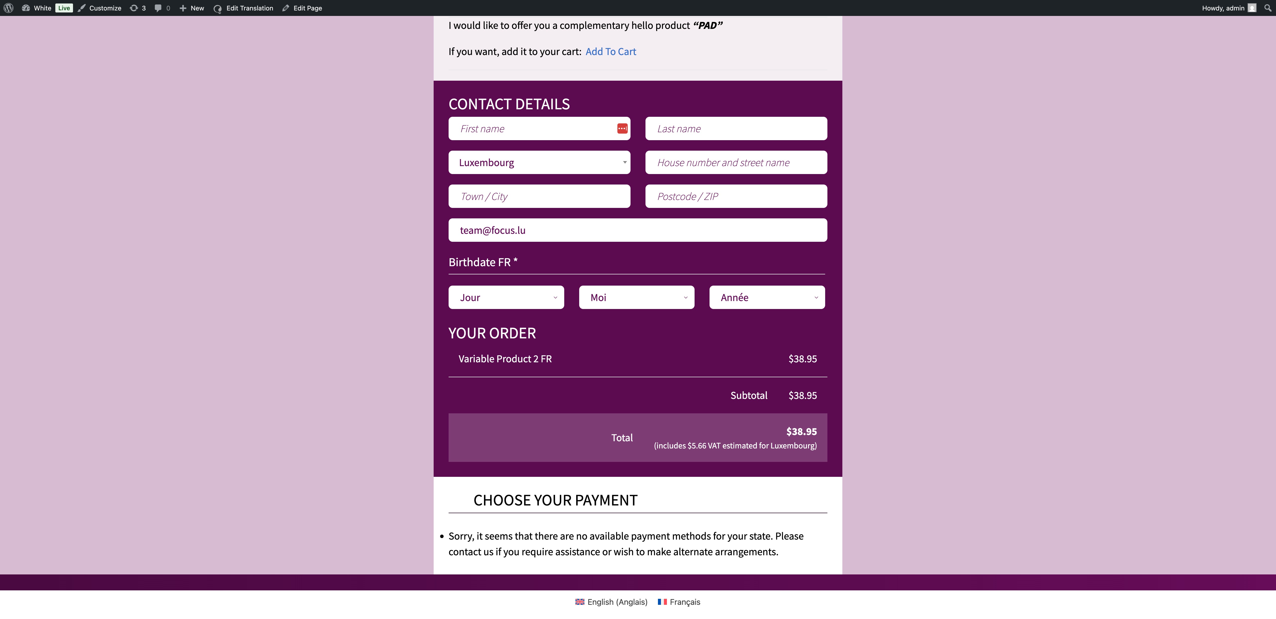

May 22, 2025 at 6:12 am #17059593
Shekhar Bhandari
I've attached screenshot in French — I only translated the birthdate to check the issue.
