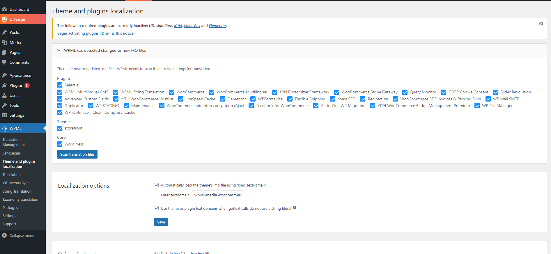

On your website first I ran the dialog to create WPML custom mo-files, which are language files needed for String Translation.
See screenshot.
This is a dynamic dialog, it will only show up when WPML detects new plugins, plugin versions or a theme change.
Then I tried to scan for strings, and it appears that WPML has an issue only when trying to do this with the UDesign theme and its core plugin.

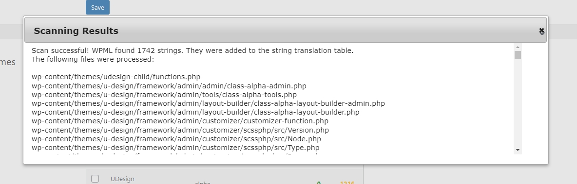

I've installed and registered UDesign theme and all required plugins + a demo site on the test site you provided, then I ran the WPML setup wizard and scanned the theme: the scan is completed correctly. (attached screenshot).

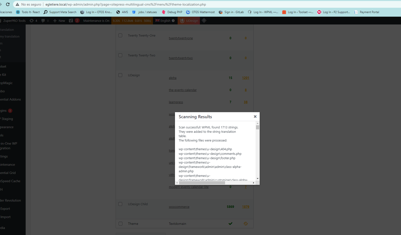

I saw the issue on your site even with other plugins that use a higher amount of strings.
For example, when scanning the Child Theme, which has few strings, there was no issue.
It seems to me to be an issue when a given high amount of strings is about to get scanned.
The odd part is that I can no longer confirm the issue on localhost. (See screenshot)

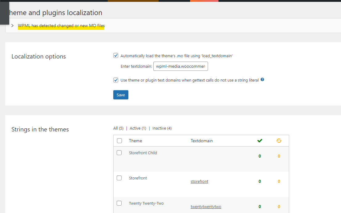

I have connected myself to your staging site, disabled anything but WPML and String Translation, and scanned the UDesign Theme after completing the dialog for creating new mo-files at WPML > Theme & Plugin Localization (See Screenshot).
The error keeps occurring:
theme-plugin-localization.js?ver=3.2.1:228
Uncaught TypeError: Cannot read properties of undefined (reading 'files_processed')

March 16, 2022 at 10:05 pm #10807353
I am not sure if the eval() function could be the root of that issue but according to the PHP info found on the staging site, the function remains disabled.
Did the hosting support also clear the server cache?
See screenshot.

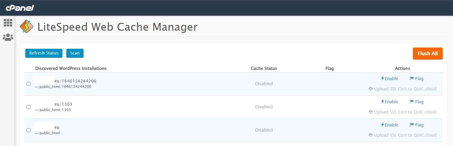

Hosting support replied:
- they cleared the Litespeed cache
- they whitelisted an ip that was blocked by the firewall
'referer' => 'hidden link',
- they disabled ModSecurity and Bitninja's WAF
- no other errors
The scan still won't complete on my side.

It seems that did the trick, as the hosting was blocking:
On the staging, the scan was successful now.
See Screenshot.
