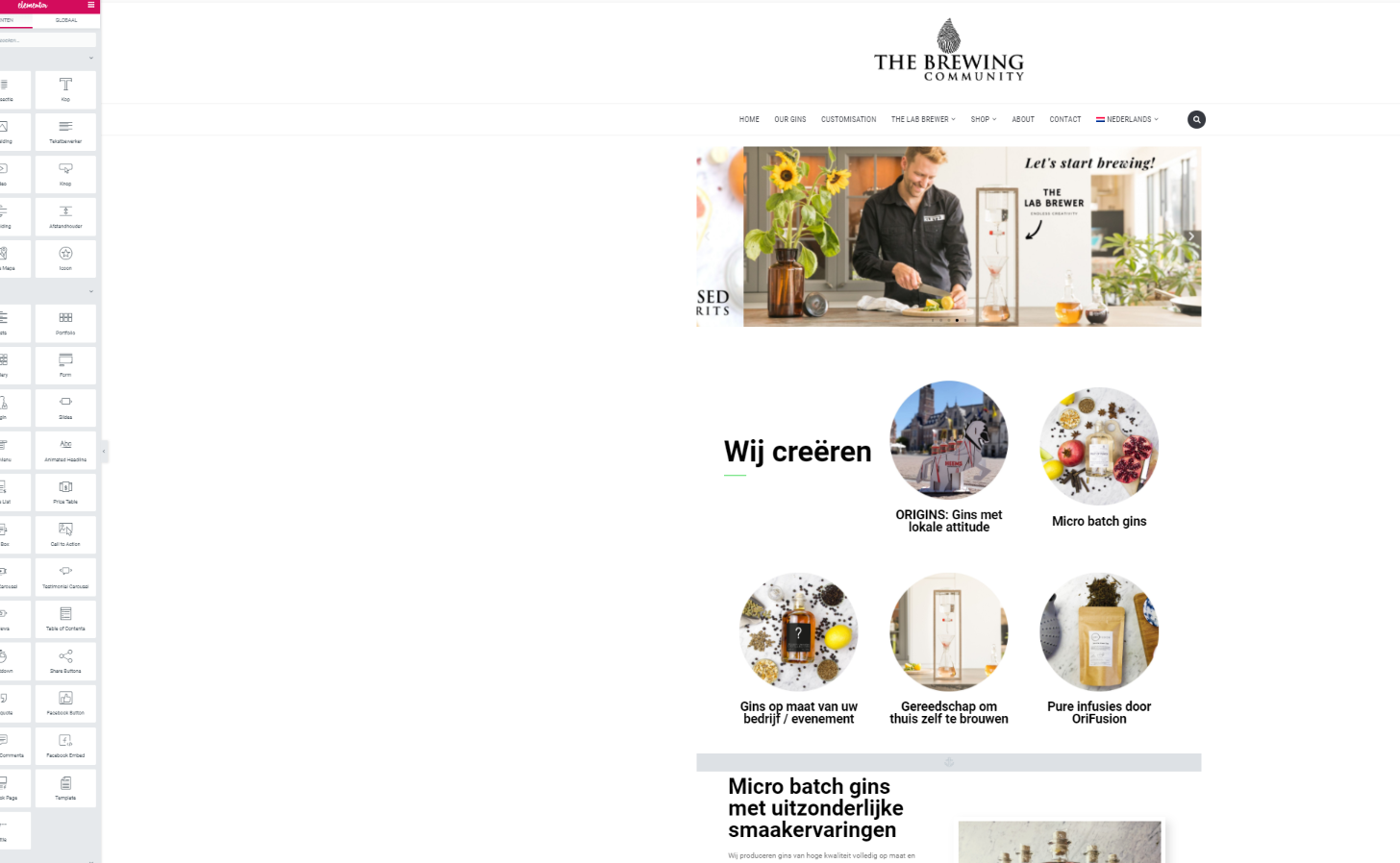

When I open the translated pages with elementor, the style is perfect. But when I publish, non of it is visual.
See printscreens.

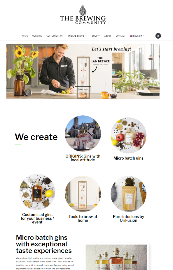

image: Style in ENGLISH --> original home page in ENGLISH
image: Translated page in dutch --> translated page from the original in language DUTCH. Style and banner are missing
image: translated page in dutch in ELEMENTOR --> visual when editing the translated page with elementor. The style is correct, but not on published site.

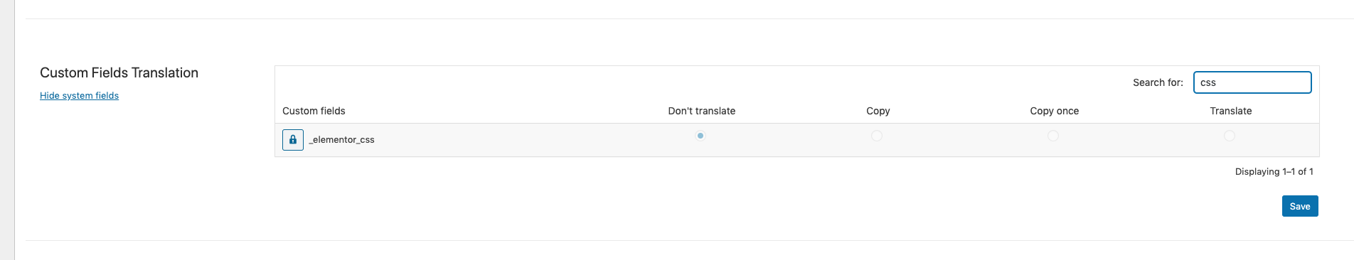

From what I can see, there's a custom field for the Elementor's custom styling that is set to "not translate" for the moment. This might be the custom field that carries over the custom styling to the translated pages so you would need to set that to "copy" (check my screenshot).
Related documentation:
https://wpml.org/documentation/getting-started-guide/translating-custom-fields/
You can go to WPML > Settings > "Custom Fields" section > Show system fields > search for "css" > set it to copy (click the lock first) and then save.
Now go to the default language homepage and make a small change then save it.
After that, go to the translated page, make a small edit and save it.
See if the custom CSS (styling) is now carried over.
I will be waiting for your confirmation.

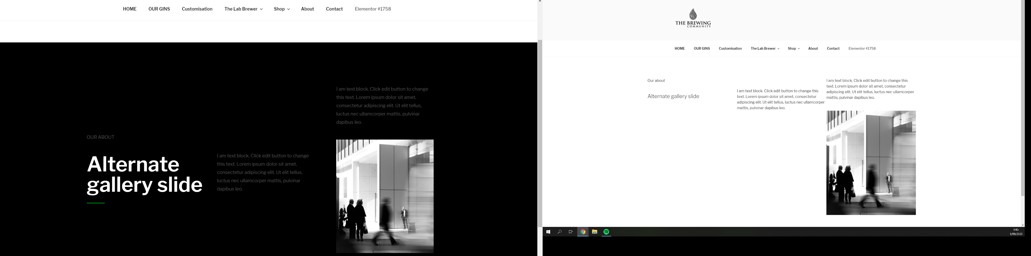

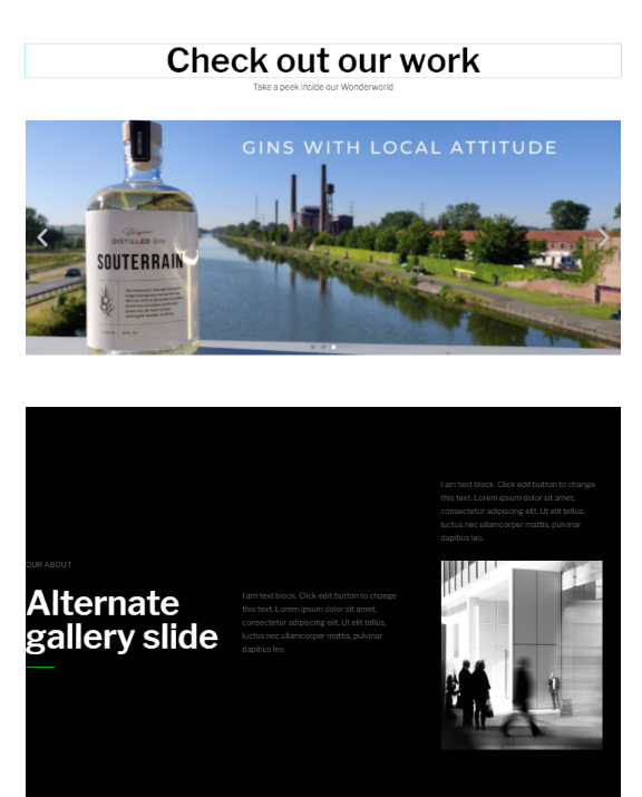

Ok, I made a new page with blocks I picked from the template library from elementor.
See attachment 1 and 2
2 = how it looks in ELEMENTOR when creating the blocks
1 = how the page looks published. (no slider, no colors, no fonts, ...)
This is the preview page.
All the pages I made before installation of WPML contain the desired style when published.
Every page I made after installation and every translated page WPML created is without style.

I realy don't understand it anymore.

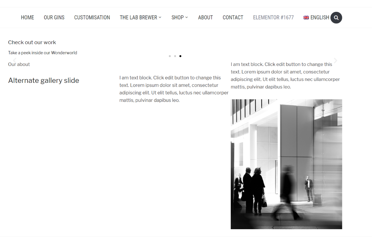

I changed theme to WP theme Twenty Seventeen

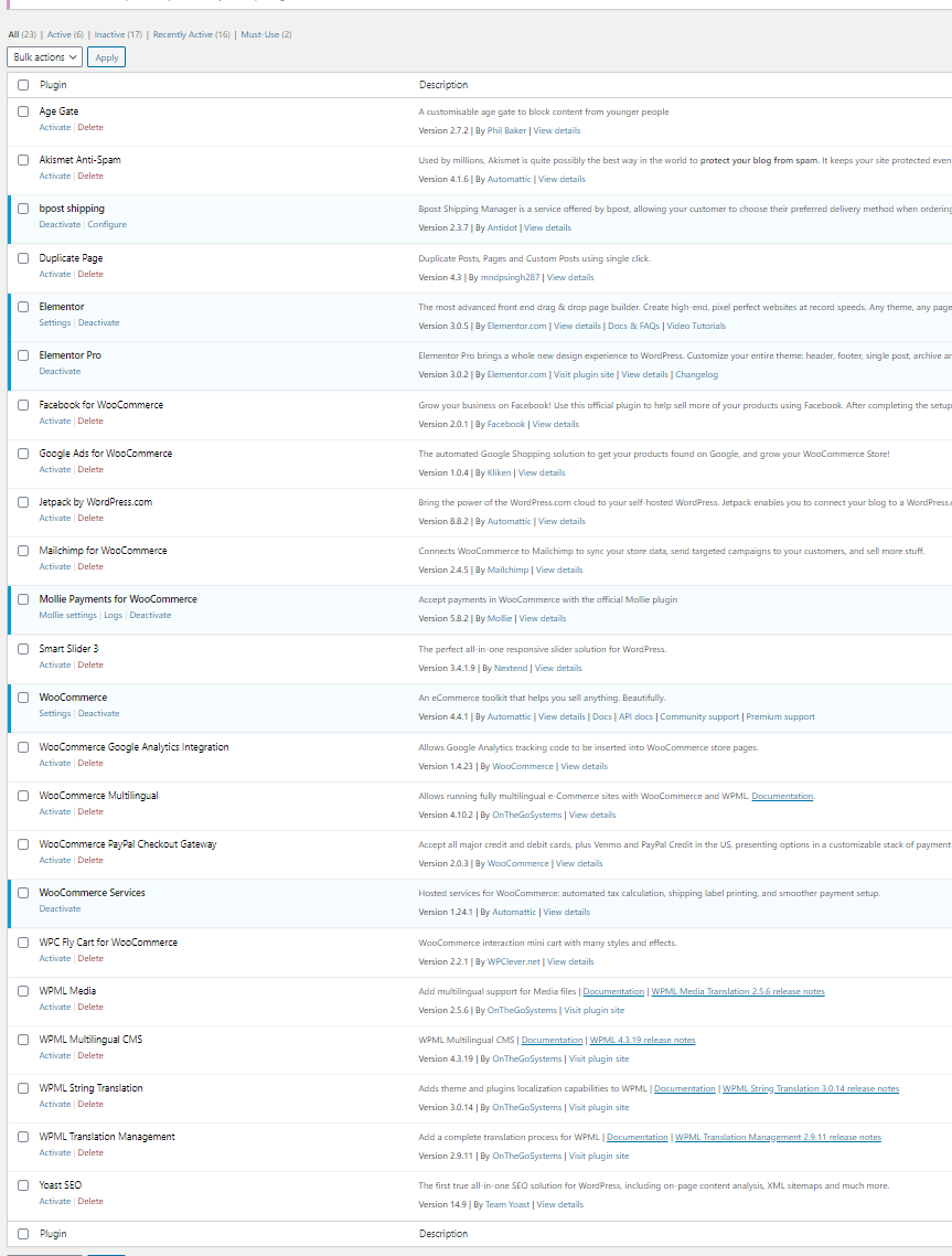

I deactivated plugin after plugin. And each time created a new page with just one stylish elementor block. Published and watched the result. each time the result was the same. Style visible in elementor, but not published.
I am now at the stage where I deactivated almost all plugins. Only woocommerce, mollie payments, elementor, and bpost shipping are activated and the problem still occurs.
See pictures attached
I can not deactivate the active plugins since they are crucial?
I don't know what to do next.
