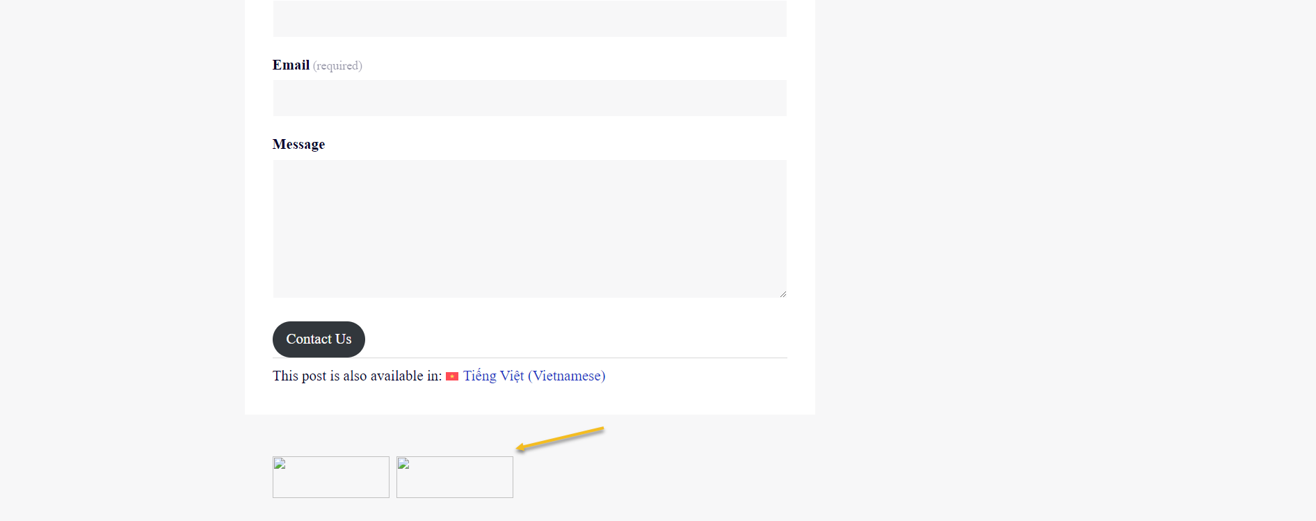

I am trying to: insert svg in footer widget
I expected to see: SVG show in my footer widget in frontend
Instead, I got: SVG don't show in my footer widget in frontend

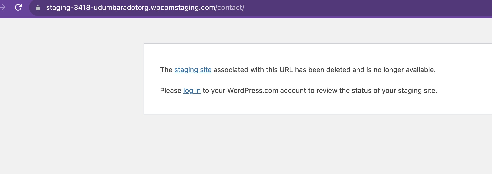

Sorry, your Website no longer works. hidden link .
I'm getting the error shown in the attached screenshot.

I've checked and I can see the issue you had there. Looks like the media translation plugin is causing issues with the SVG file as it seemed to work when I deactivated it.
