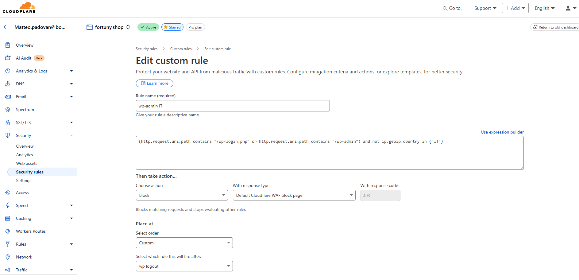

April 22, 2025 at 10:13 am #16954322
FortunyShop
So here's a recording of what's happening including the console error, however it's not consistent as the second time I tested the switcher worked fine:
As you can see the language won't switch. However it works in the opposite way, from a translated language to English.
I am attaching a Cloudflare firewall rule that may be responsible for this, which basically blocks every attempt to acces a page containing the url "wp-admin" if NOT coming from Italy, our headquarters. Anyway it's strange because this rule is there since years, and this issue is something quite new.
Thanks for your help
Matteo
April 22, 2025 at 10:46 am #16954609
Carlos Rojas
WPML Supporter since 03/2017
Hi Matteo,
Thank you very much for sharing the screencast
I can see the 403 error in the console, and I suspect this might be caused by the firewall. Can you deactivate the firewall and double-check if the issue has disappeared?
Also, please go to WPML -> Languages -> And make sure the Ajax cookie is active.
