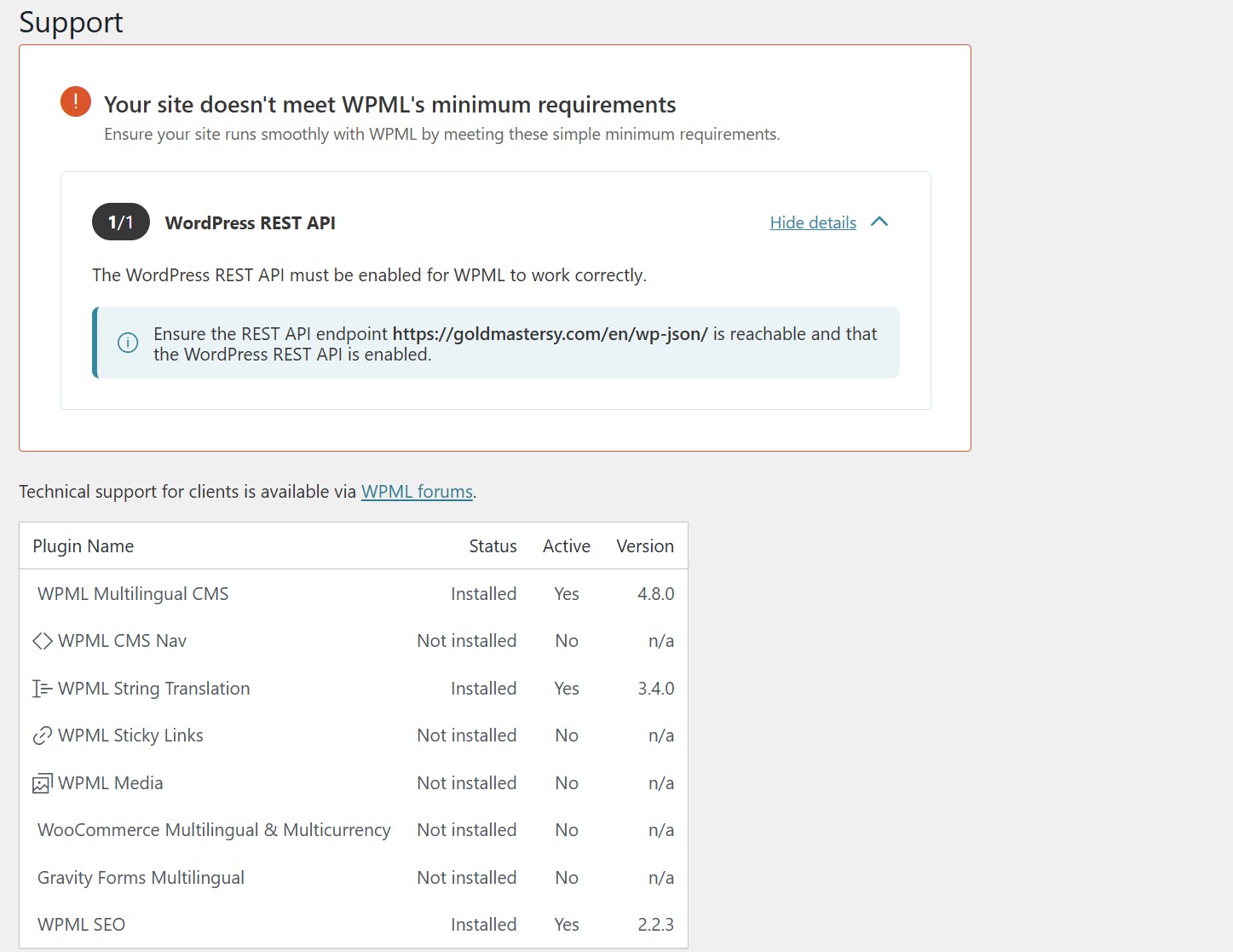

I am trying to switch the site language from Arabic to English or Turkish on my website. I have confirmed that all server and WordPress requirements are met, and the REST API endpoint is reachable. The URL for the REST API endpoint is hidden link.
When I switch the site language, I see the message: "Your site doesn't meet WPML's minimum requirements. The WordPress REST API must be enabled for WPML to work correctly." Additionally, when I save a translated page or post, I get the error message: "There has been a critical error on this website." However, the changes appear to be saved. This issue only occurs with translated content.
Why am I seeing a message about WPML's minimum requirements when switching languages?

August 29, 2025 at 1:53 am #17356566
Note that the REST API is not available in language directories like /en in second languages.
You can only access it at:
To access the English data, use a language parameter:

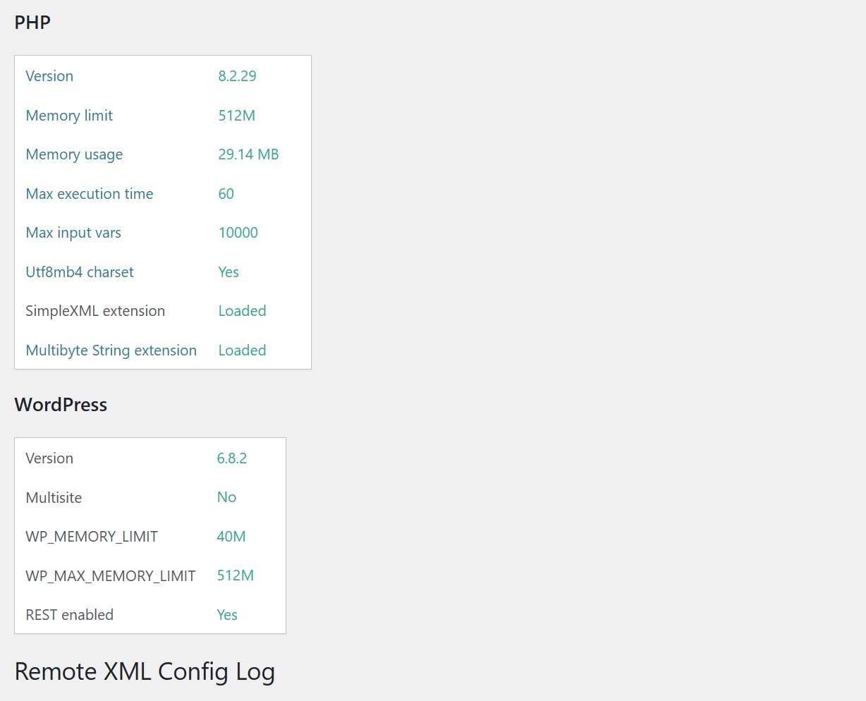

About the error:
1) It seems the minimum requirements on the server are not met:
https://wpml.org/en/home/minimum-requirements/
Could you please increase the WordPress memory limit (WP Memory Limit) to at least 256 MB? WPML requires at least 128 MB.
Your current values ​​are:
PHP Memory Limit 512 MB
WP Memory Limit 40 MB
To do this, you need to connect to your website's server and open the wp-config.php file in a text editor. The file is located in the WordPress root directory.
Add this code to the wp-config.php file to increase WordPress memory:
define ('WP_MEMORY_LIMIT', '256M');
Add this just before this comment:
// That's all, stop editing! Happy blogging.
The current values ​​can be viewed under WPML > Support > WordPress.
These settings can be restricted directly by your hosting provider. Therefore, I recommend contacting them and asking them to change them directly if the changes are not applied immediately.
2) Now, please edit the original post or page, save it again and complete the translation again. Do you still get the same error?
If so, does the error disappear if you disable "EWWW Image Optimizer" and test again?
Also, please make sure ot run WPML > Settings > Media Translation > Start. This dialog will sync the media into all languages inside the media library. Then test again.

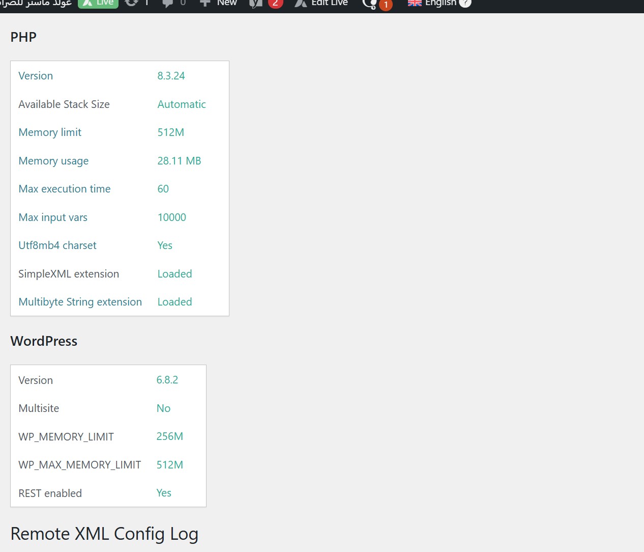

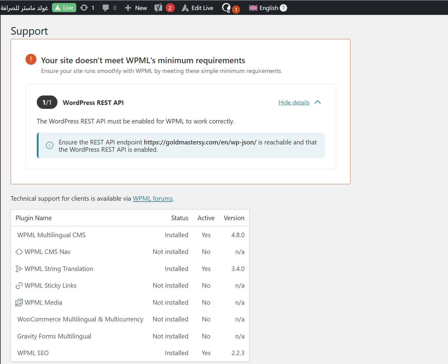

August 29, 2025 at 8:48 am #17357155
mulhamZ-2
Dear Andreas,
Thank you for your reply and suggestions.
Here is what I have done so far:
I increased the WordPress memory limit to 256 MB as advised.
I edited and saved the original page, then tried saving the translated page again, but the same critical error occurred.
I deactivated the EWWW Image Optimizer plugin and also ran the Media Translation > Start synchronization process, but unfortunately the issue still persists.
The problem remains the same: translated pages trigger the critical error upon saving, while standalone pages work without issues.
Please advise on the next steps.
Mulham
