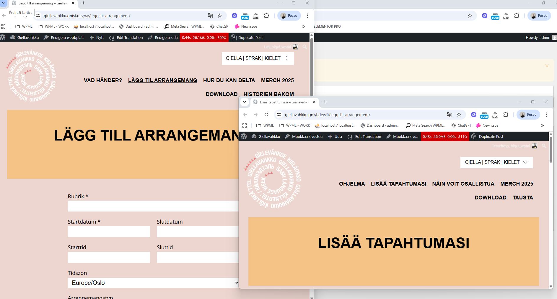

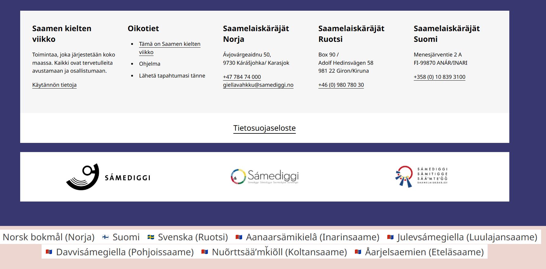

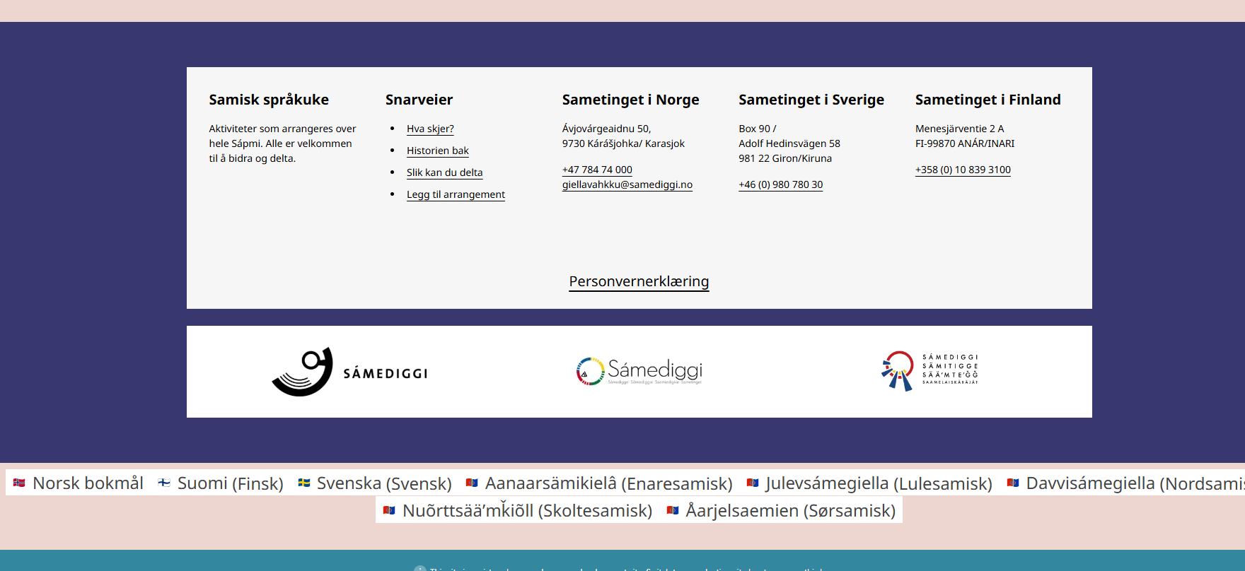

I am trying to translate the header and footer of my Full Site Editing (FSE) theme into multiple languages using WPML. I have successfully applied translations for all other languages on the site. The issue can be seen on this page: hidden link. The main page is hidden link.
When switching to Finnish, the header looks different compared to what I configured. On certain Finnish pages, such as hidden link, the header and footer disappear completely. All other languages work flawlessly, and I followed the exact same process for Finnish.
Why does the header look different when switching to Finnish?
Why do the header and footer disappear on certain Finnish pages?

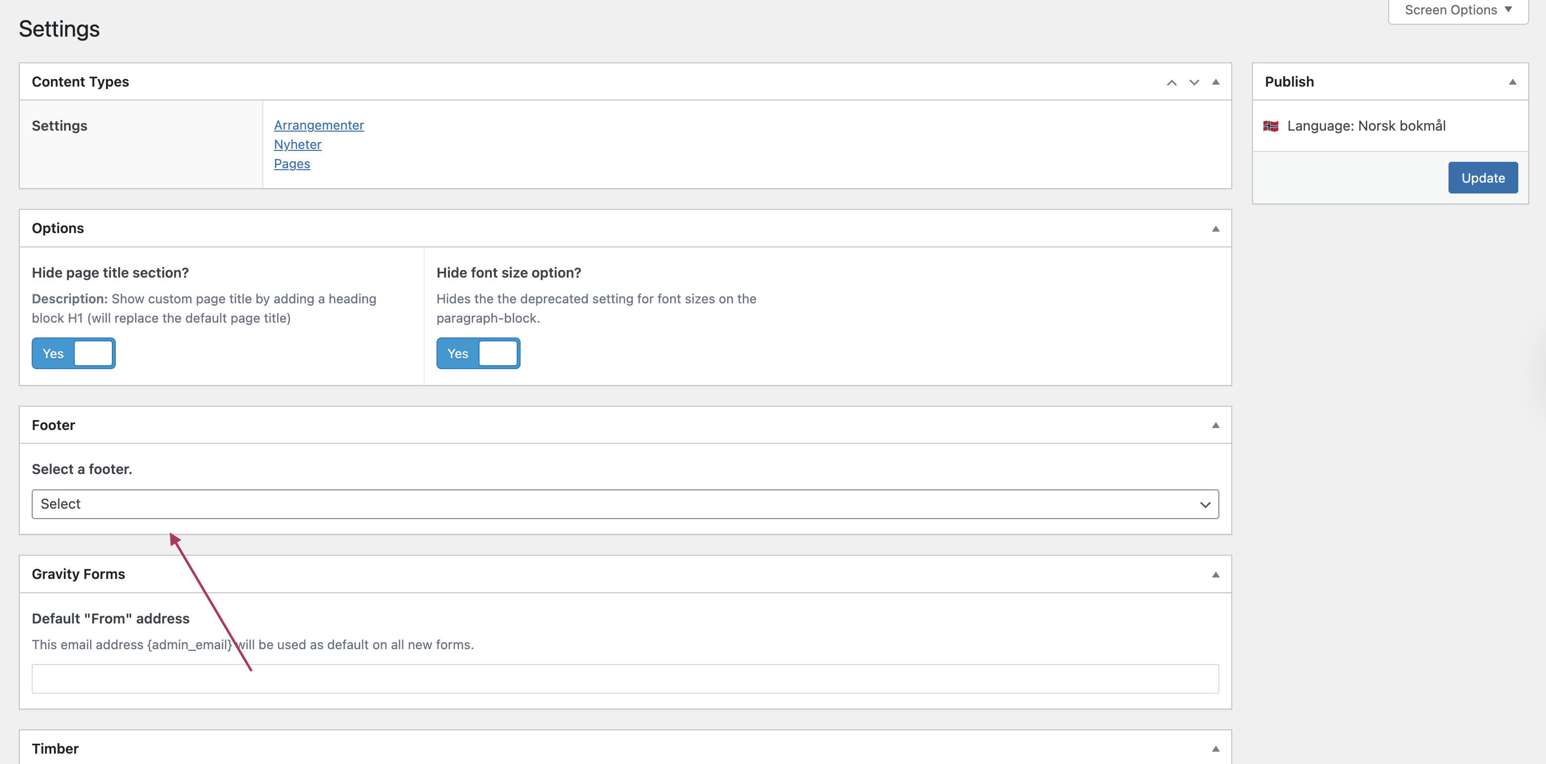

  • Header and footer management
    • How are you currently managing the site’s header and footer?
    • I noticed the footer template listed under Advanced → Footer, but it is not selected in the Settings (please see the attached images for reference).
    • Could you please share more details about your header and footer settings? This information will help us identify the issue more clearly.

September 15, 2025 at 10:27 am #17401497
Gnist Design
I've done the things and still have issues.
This is a block theme developed by us, using the full site editor. The footer editor is not used, and we're using the full site editor footer template.
To actually make the header & footer display on multiple languages, the header and footer FSE template needs to be translated (weird). The place to edit this is in the default WordPress full site editor.
I've tried to both duplicate the header template, and manually translate the FSE gutenberg strings, neither updates on the finnish language, but on all other langauges.

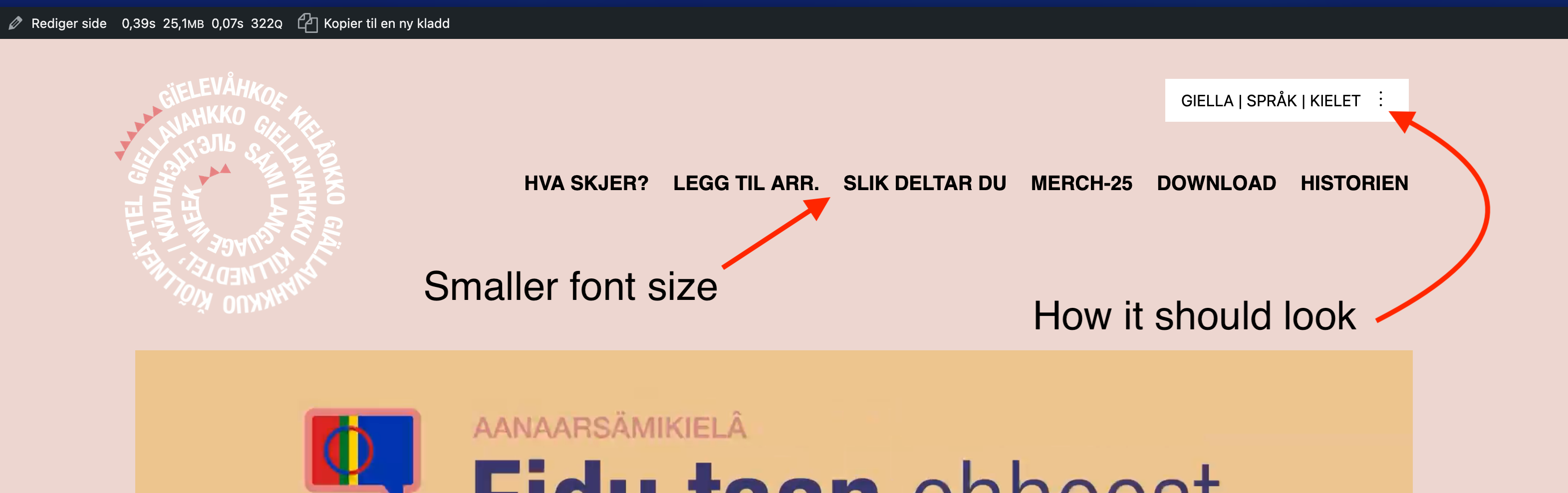

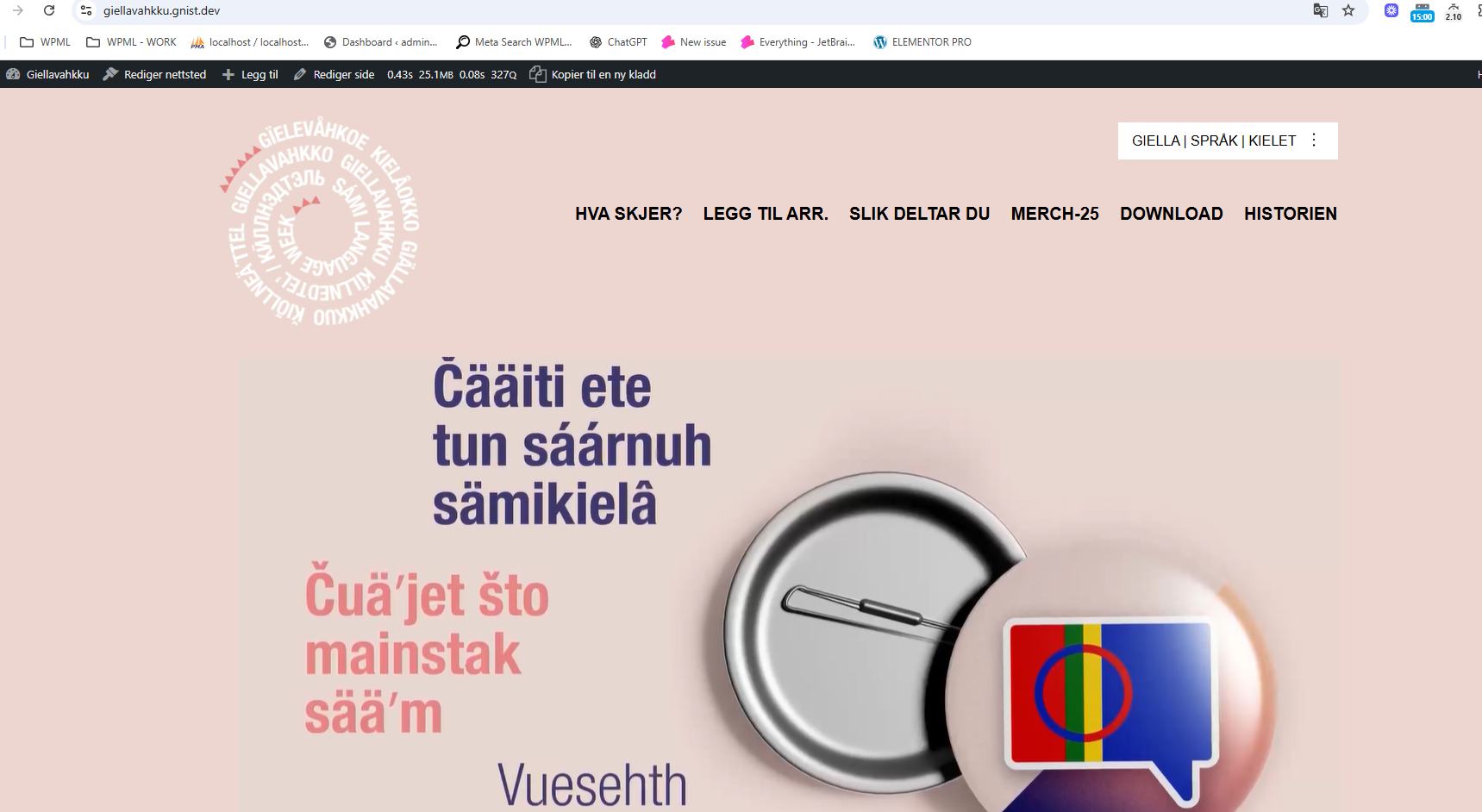

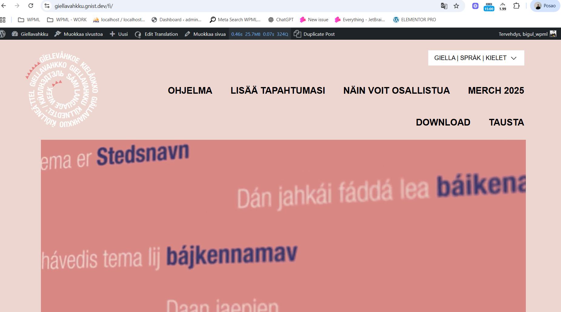

September 30, 2025 at 8:45 am #17443228
Gnist Design
It seems like the header is back on the pages, that's good.
However, the header menu does not update on the finish language, you can verify this by clicking the language switcher on any other language (the button top right on the navigation bar), where it works on any other language, and it does not work, and look different on the finish version.
Also the styling changes, e.g. font-size, logo size, etc does not update on the finish header version, even when I duplicate the FSE templates.
Steps I've tried to solve this issue:
- Duplicate the header from the source language (Norwegian), to Finnish. (Both the header template, and the navigation template).
- Manually translate the Finnish language, by copy-pasting the fields, and marking all the translations as complete, and accepting the translation
I've done this by going to Translation Dashboard -> selecting the chosen templates (Header, Sidetoppmeny, sekundærmeny) and sending them to either translation, or duplicating.
Please ask any clarifying question if I'm missing some important information you need to understand what I've done 🙂
