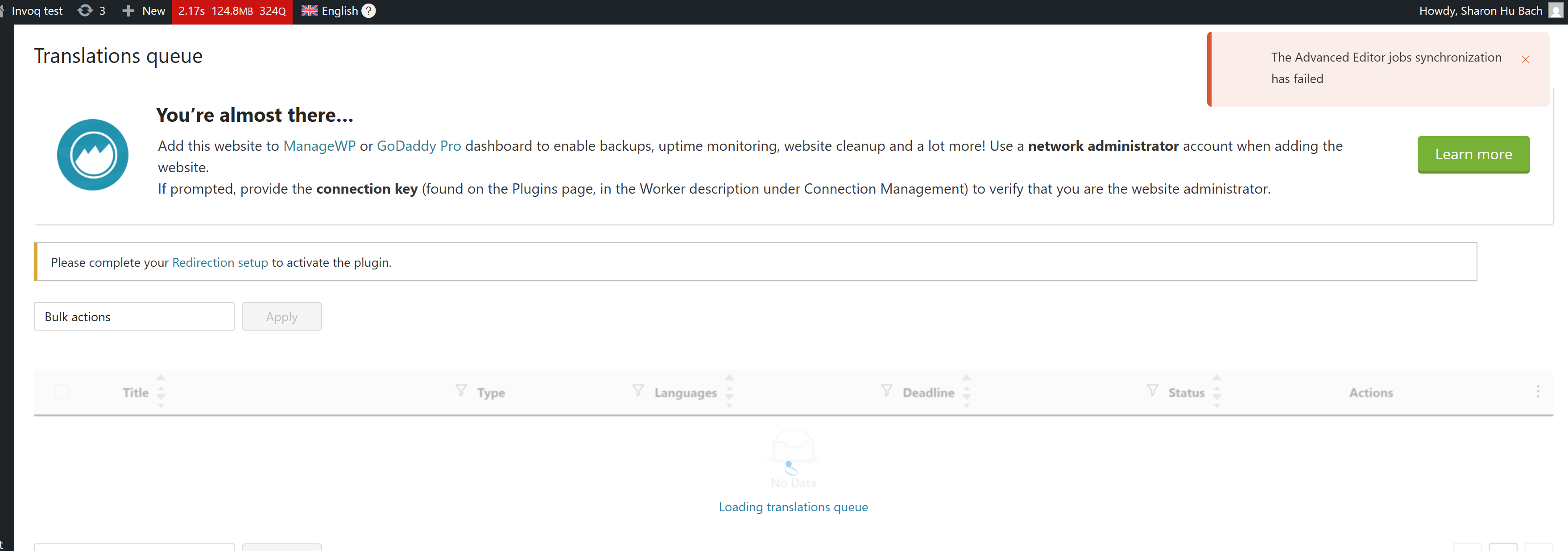

I am trying to translate a page for testing using WPML. The issue can be seen on this page: hidden link
I received a message saying 'The Advanced Editor jobs synchronization has failed' and I am redirected to the Translations queue instead of seeing the translation tool.
Why did the Advanced Editor jobs synchronization fail?
How can I access the translation tool instead of being redirected to the Translations queue?
