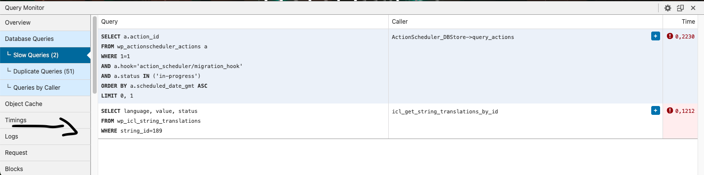

While checking further, I noticed two entries listed under “Slow Queries” in Query Monitor.
One of them is related to:
SELECT language, value, status FROM wp_icl_string_translations WHERE string_id=...
Could you please clarify what this query does and whether it could be optimized or prevented from recurring?
Also, since you're already familiar with the site’s structure, would you personally recommend any additional adjustments (plugins, DB cleanups, WPML tweaks, etc.) to improve speed or reduce backend load?
Thanks again for your help and support.
Josef

Here are the comments from our second-tier supporters on the “Slow Queries” you presented. He wrote:
I checked the site backend.
For me, the query (seems related to RankMath and the titles of the site?)
WHERE string_id=189
takes 0.0006sec.
Why the user is taking more - should be diagnosed probably by the user's hosting provider, or if he has access to the server, he should check for load during the time when he tested.
The query about the action scheduler is either by RankMath or by WooCommerce.
It may indicate that something is wrong in the database tables(WooCommerce issue) for the action scheduler or an action that is not working properly (MailPoet, RankMath, WP Rocket, or some other plugin too!)
If it is the table's issue, then there might be missing indexes there as well.
Running:
SELECT * FROM `wp_actionscheduler_actions` WHERE `status` = 'in-progress'
via adminer, shows rocket_preload_job_check_finished, which is an action by WP Rocket for preloading cache.
Probably something is wrong there? Or maybe it is just normal. The client should contact WP Rocket support for assistance.
I hope this information is helpful to you.
Itamar.

Hi Itamar,
Thank you so much for the detailed explanation and for checking everything so thoroughly.
Everything seems to be working correctly now, and your insights were very helpful in narrowing things down. I’ve also contacted WP Rocket support as suggested, and I’m continuing to monitor performance on the hosting side.
I really appreciate your time and support — thank you again!
