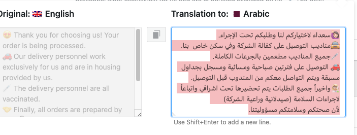

August 17, 2023 at 10:36 am #14245105
mohamede-39
Works fine, but the translated text does not appear on arabic email
