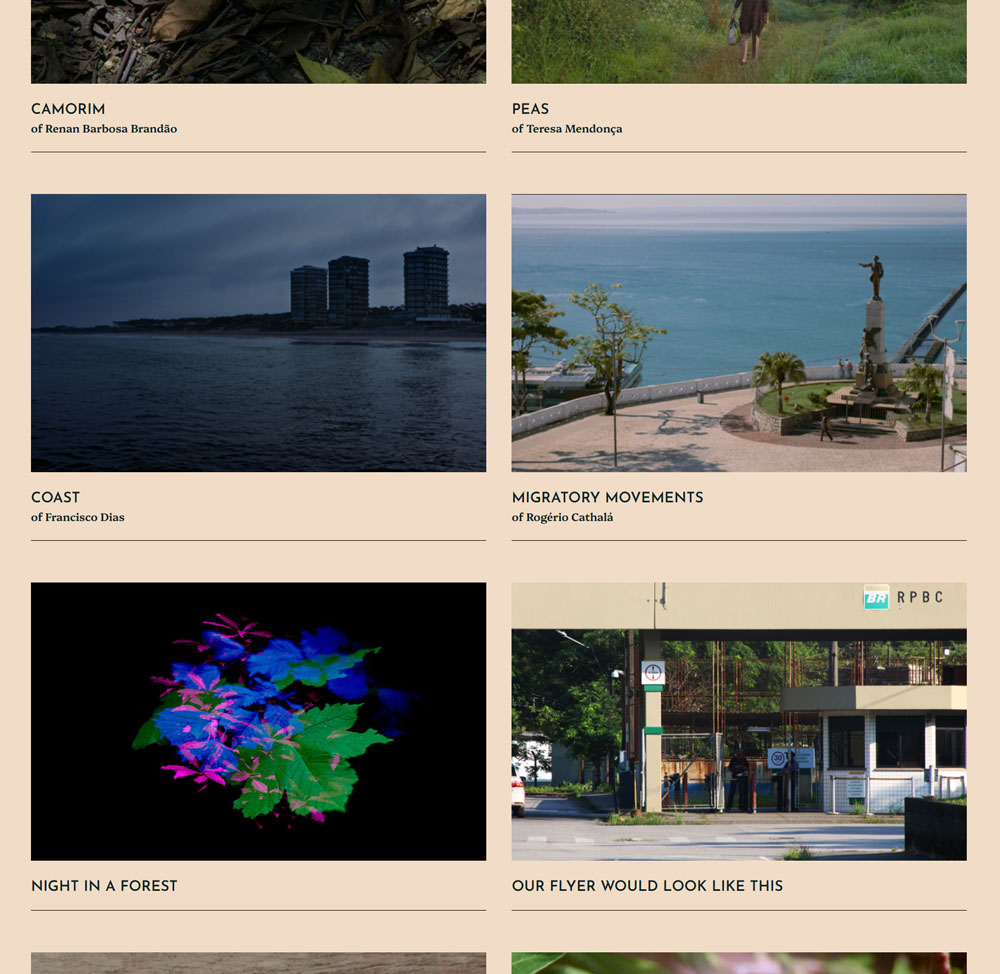

As you can see in the uploaded image, some of the listed posts require updates to display the complete information (for example, the text line for the film author). I was able to update a few of them, but then it stopped working.
Here’s an example of one such post that we need to update:

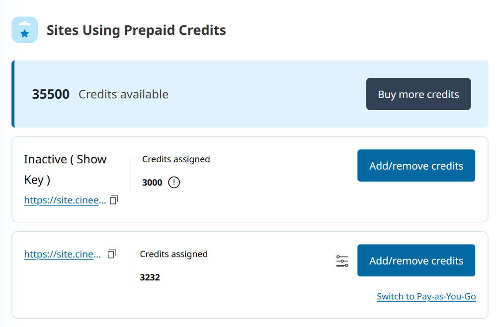

Could this be a credits or license issue? I took a screenshot of my account. I don't know why it says inactive. I don't know what happened...
Thank you

Thank you for the updates. The post has been fully translated using the Advanced Translation Editor, but it has not been delivered yet.
So, after taking a full site backup (mandatory), please try the following steps and check if the issue still exists:
1. Visit your account page at https://wpml.org/account/sites/
2. Delete the existing key for your site (hidden link)
3. Navigate to Plugins>>Add New>>Commercial tab.
4. Click on "Unregister WPML from this site".
5. Refresh the page.
6. Click on "Get a key for this site".
7. Copy the newly generated code.
8. Return to Plugins>>Add New>>Commercial tab.
9. Register the site with the new key.
10. Upgrade to the latest version of plugins (especially Elementor plugins)
Then update the post in the original language to refresh the translation settings and update the translation.
Thanks!
