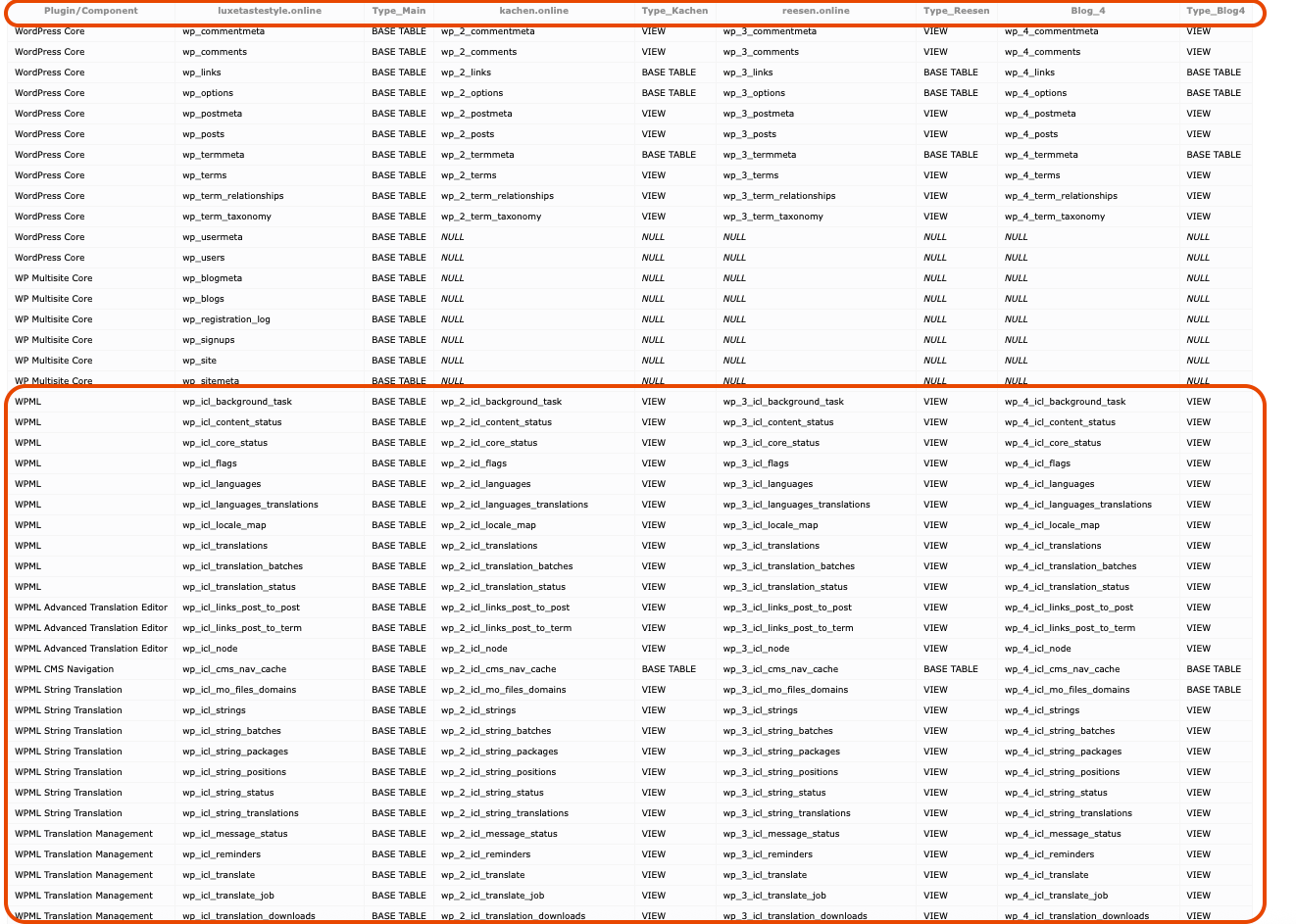

Consider that our wordpress is a multisite with 4 blogs. Most of the tables for the secundary blogs (also the "icl" set) have been replaced by views. WPML is active on each website but the task automation are supposed to be executed only on the main blog.
Maybe is better to clarify this architectural aspect before making test.
Let me know if this is clear and how we can proceed
September 22, 2025 at 9:29 am #17420596
maurizioM-27
these are the TABLES / VIEWS for WPML

BUT, more specifically about the current error we are detecting, in debug mode, wordpress clearly reports
[08-Oct-2025 08:00:58 UTC] WordPress database error 'bnyfsmdrmf.wp_4_icl_strings' is not of type 'BASE TABLE' for query ALTER TABLE wp_4_icl_strings ADD INDEX `context` ( `context` ) made by require_once('wp-load.php'), require_once('wp-config.php'), require_once('wp-settings.php'), do_action('plugins_loaded'), WP_Hook->do_action, WP_Hook->apply_filters, SitePress->init, do_action('wpml_loaded'), WP_Hook->do_action, WP_Hook->apply_filters, WPML_Upgrade_Loader->wpml_upgrade, WPML_Upgrade->run, WPML_Upgrade->run_admin, WPML_Upgrade->run_commands, WPML_Upgrade->run_command, WPML_Upgrade->maybe_run_admin, WPML_Upgrade_Run_All->run_admin, WPML\Upgrade\Commands\AddIndexToTable->run, WPML_Upgrade_Schema->add_index
[08-Oct-2025 08:00:58 UTC] WordPress database error 'bnyfsmdrmf.wp_4_icl_string_translations' is not of type 'BASE TABLE' for query ALTER TABLE wp_4_icl_string_translations ADD INDEX `status` ( `status` ) made by require_once('wp-load.php'), require_once('wp-config.php'), require_once('wp-settings.php'), do_action('plugins_loaded'), WP_Hook->do_action, WP_Hook->apply_filters, SitePress->init, do_action('wpml_loaded'), WP_Hook->do_action, WP_Hook->apply_filters, WPML_Upgrade_Loader->wpml_upgrade, WPML_Upgrade->run, WPML_Upgrade->run_admin, WPML_Upgrade->run_commands, WPML_Upgrade->run_command, WPML_Upgrade->maybe_run_admin, WPML_Upgrade_Run_All->run_admin, WPML\Upgrade\Commands\AddIndexToTable->run, WPML_Upgrade_Schema->add_index
[08-Oct-2025 08:00:58 UTC] WordPress database error 'bnyfsmdrmf.wp_4_icl_strings' is not of type 'BASE TABLE' for query ALTER TABLE wp_4_icl_strings ADD INDEX `string_package_id` ( `string_package_id` ) made by require_once('wp-load.php'), require_once('wp-config.php'), require_once('wp-settings.php'), do_action('plugins_loaded'), WP_Hook->do_action, WP_Hook->apply_filters, SitePress->init, do_action('wpml_loaded'), WP_Hook->do_action, WP_Hook->apply_filters, WPML_Upgrade_Loader->wpml_upgrade, WPML_Upgrade->run, WPML_Upgrade->run_admin, WPML_Upgrade->run_commands, WPML_Upgrade->run_command, WPML_Upgrade->maybe_run_admin, WPML_Upgrade_Run_All->run_admin, WPML\Upgrade\Commands\AddIndexToTable->run, WPML_Upgrade_Schema->add_index
[08-Oct-2025 08:00:58 UTC] WordPress database error 'bnyfsmdrmf.wp_4_icl_locale_map' is not of type 'BASE TABLE' for query ALTER TABLE wp_4_icl_locale_map ADD PRIMARY KEY (`code`, `locale`) made by require_once('wp-load.php'), require_once('wp-config.php'), require_once('wp-settings.php'), do_action('plugins_loaded'), WP_Hook->do_action, WP_Hook->apply_filters, SitePress->init, do_action('wpml_loaded'), WP_Hook->do_action, WP_Hook->apply_filters, WPML_Upgrade_Loader->wpml_upgrade, WPML_Upgrade->run, WPML_Upgrade->run_admin, WPML_Upgrade->run_commands, WPML_Upgrade->run_command, WPML_Upgrade->maybe_run_admin, WPML_Upgrade_Run_All->run_admin, WPML\Upgrade\Commands\AddPrimaryKeyToTable->run, WPML_Upgrade_Schema->add_primary_key
ADD INDEX `icl_strings_name` (`name` ASC);
made by require_once('wp-load.php'), require_once('wp-config.php'), require_once('wp-settings.php'), do_action('plugins_loaded'), WP_Hook->do_action, WP_Hook->apply_filters, SitePress->init, do_action('wpml_loaded'), WP_Hook->do_action, WP_Hook->apply_filters, wpml_tm_load, WPML_Translation_Management->load, do_action('wpml_tm_loaded'), WP_Hook->do_action, WP_Hook->apply_filters, WPML_String_Translation->load, WPML_ST_Upgrade->run, WPML_ST_Upgrade->run_admin, WPML_ST_Upgrade->maybe_run, WPML_ST_Upgrade_DB_String_Name_Index->run
MODIFY COLUMN `value` LONGTEXT NOT NULL;
made by require_once('wp-load.php'), require_once('wp-config.php'), require_once('wp-settings.php'), do_action('plugins_loaded'), WP_Hook->do_action, WP_Hook->apply_filters, SitePress->init, do_action('wpml_loaded'), WP_Hook->do_action, WP_Hook->apply_filters, wpml_tm_load, WPML_Translation_Management->load, do_action('wpml_tm_loaded'), WP_Hook->do_action, WP_Hook->apply_filters, WPML_String_Translation->load, WPML_ST_Upgrade->run, WPML_ST_Upgrade->run_admin, WPML_ST_Upgrade->maybe_run, WPML_ST_Upgrade_DB_Longtext_String_Value->run
MODIFY COLUMN `value` LONGTEXT NULL DEFAULT NULL,
MODIFY COLUMN `mo_string` LONGTEXT NULL DEFAULT NULL;
ADD INDEX `icl_strings_translation_priority` ( `translation_priority` ASC )
made by require_once('wp-load.php'), require_once('wp-config.php'), require_once('wp-settings.php'), do_action('plugins_loaded'), WP_Hook->do_action, WP_Hook->apply_filters, SitePress->init, do_action('wpml_loaded'), WP_Hook->do_action, WP_Hook->apply_filters, wpml_tm_load, WPML_Translation_Management->load, do_action('wpml_tm_loaded'), WP_Hook->do_action, WP_Hook->apply_filters, WPML_String_Translation->load, WPML_ST_Upgrade->run, WPML_ST_Upgrade->run_admin, WPML_ST_Upgrade->maybe_run, WPML_ST_Upgrade_DB_Strings_Add_Translation_Priority_Field->run
and this is due to the fact the "icl" tables for the secondary blogs 2, 3 and 4 are VIEWS and is NOT possible to ALTER VIEWS as woocommerce/WPML is trying.
ALTER TABLE is possible ONLY on the main tables.
Did you consider this report in the debug.log ?
In my opinion this is the reason for the message presented by WPML.

while eating for a solution, I analysed your code, found the reason for the warning and patched/update the database. The message is now off.
Thank you for your support, even if there was no quick solution
