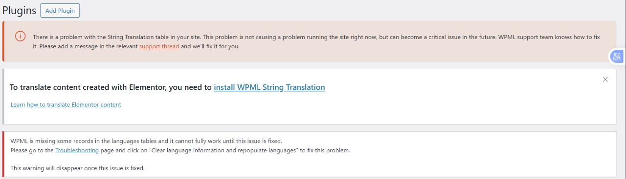

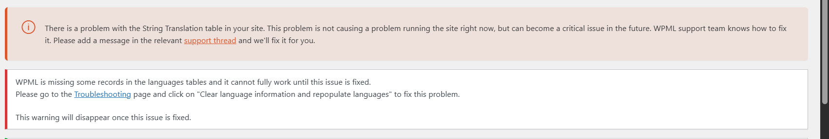

alrowadit
I am trying to activate the WPML plugin on my site.
There is a problem with the String Translation table in my site. This problem is not causing a problem running the site right now, but can become a critical issue in the future.
How can I fix the String Translation table issue?
What steps should I take to prevent this from becoming a critical issue?

July 26, 2025 at 9:19 pm #17272729
alrowadit
all steps done but still not working I'm take a full backup from me site you can solve it in my site please?

July 27, 2025 at 9:25 am #17272876
Bigul
WPML Supporter since 01/2013
Thank you for the updates. Please check it now. I was able to configure WPML as expected after the steps suggested here: https://wpml.org/forums/topic/there-is-a-problem-with-the-string-translation-table-in-your-site-this-problem-is-not-causing-a-pro-8/#post-17268698
Please check it now and let us know your feedback.
