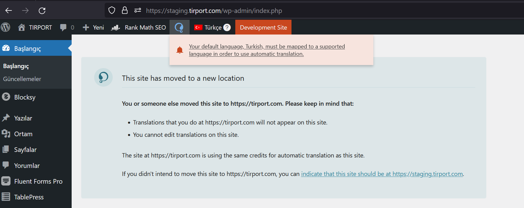

I am trying to: Add content at the staging environment.
I expected to see: Normal admin page.
Instead, I got: This repetitive error: "This site has moved to a new location"
We have had a tour with dear Alejandro recently. He had given us some workarounds (deleting some database rows) to overcome this issue.
Question 1: Are we going to repeat this everytime we push a new version to staging?
This is frustrating.
Question 2: There has been a new warning everytime we push a staging to from production environment after latest WPML update. The warning says: "Your default language, Turkish, must be mapped to a supported language in order to use automatic translation." You can see it in the screenshot also. What does it mean? I could not see any reasonable option to go forth with this warning also.

This issue could be happening because of 2 reasons (and we can help you have them fixed if you tell us which situation is the one you're facing).
1) you selected the option in the banner that mentions that you are MOVING the site from one domain to another (instead of the version that mentions that the site is a COPY).
2) similar to option 1 but this time you are returning to the staging site. you had "moved" the site before so now you're stuck with this banner.
Before we proceed, can you tell us which option sounds more like your situation? because to avoid this issue in the future, i suggest that you always select the "copy" option, tht way you can move freely from one site to another, make migrations, pushes and more without this banner blocking you everytime (you will still see it but it will give you options about what to do).

And the answer is 2.
Updated content and created a .wpress backup. Then recovered that backup at the production domain.

I talked to our developers and it seems that the problem will indeed keep appearing and you'd have to apply the workaround i mentioned before.
We're actually working on something that will make this go away, it's almost done planning so it should be coming in the following months. for now please use the same workaround as before and i'll try to see if our developers can give me another solution to this before the final one is deployed on one of our plugin's releases

Quick question, though. if you are pushing the database from staging to production, it should be safe for you to just click the ""indicate that this site should be at" aaa.com"
Because in the end you'll be making all the changes in the staging site, isn't that correct? if that's the case, then while it's true you won't be able to use ATE on production, it seems like you wouldn't do it anyway because otherwise, the staging push would still overwrite those changes.
This is the "intended" solution of this workflow and it's done exactly so you don't have both sites working in parallel with ATE with the risk of losing credit or translation memory in the future.

Oh by the way the notification you mentioned: "Your default language, Turkish, must be mapped to a supported language in order to use automatic translation."
this issue happens when you have the migration banner active and it happens because while the banner is still active, it doesn't know how you want to move forward and this mapping feature requires you to have an active ATE Account which you don't have until you go through the migration procedure.
