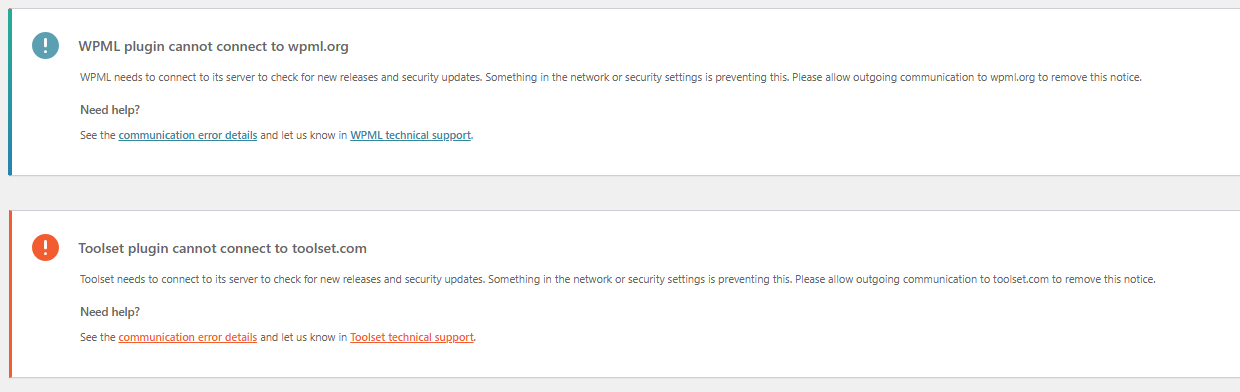

I was trying to resolve a warning message that says 'Toolset plugin cannot connect to toolset.com' even though the Toolset plugin is not installed.
'Toolset plugin cannot connect to toolset.com' warning displays even if Toolset is not installed.
Why am I seeing a warning about the Toolset plugin when it is not installed?
How can I stop the 'Toolset plugin cannot connect to toolset.com' warning from appearing?
Why always "WPML plugin cannot connect to wpml.org"

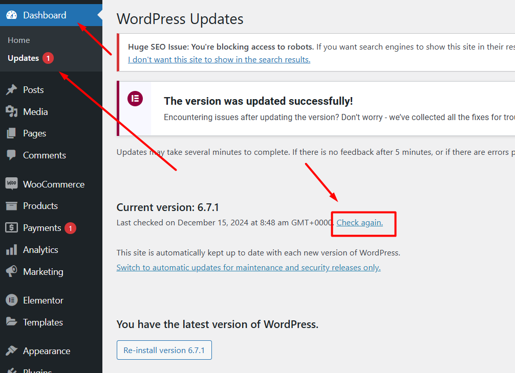

If the notifications still persists, please try the below procedure:
1. Go to WP Dashboard Menu >> Updates.
2. Press the "Check again" link as you can see in the attached screenshot
Thank you

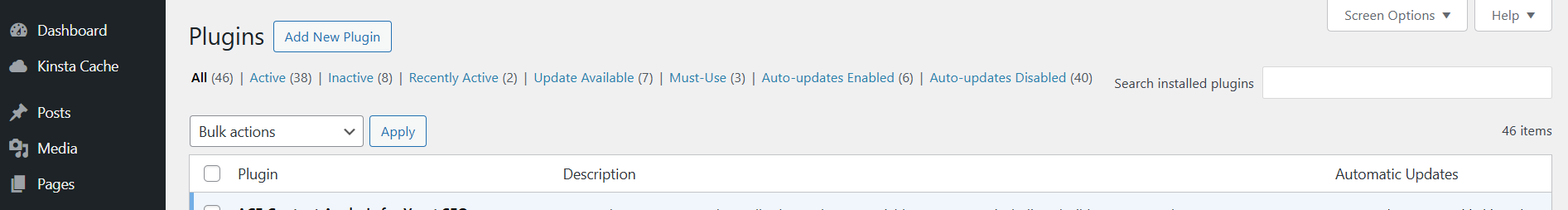

December 15, 2024 at 5:41 pm #16515173
emmaS-15
Hi Noman.
I tried the procedure you mentioned. Unfortunately, the issue still exist. Please lemme know if you need further details

December 17, 2024 at 4:51 pm #16522882
Noman
WPML Supporter since 06/2016
I followed the below steps:
1. Went to PHPMyAdmin, opened the wp_options table, and deleted the wp_installer_settings key.
2. Went to WP Dashboard >> Plugins >> Add New Plugin page.
3. Clicked the Register WPML link.
4. Clicked the Get a key for this site link.
5. Generated a key with my account for testing purposes (you may re-register with your account).
7. Copied the key, and pasted it back into the input box, and pressed the Register button.

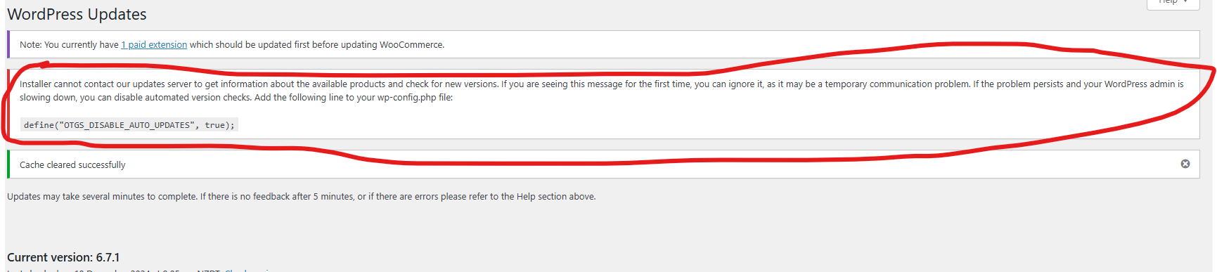

8. Went to WP Dashboard Menu >> Updates.
9. Pressed the "Check again" link
10. Cleared the cache from the admin bar as you can see in the attached screenshot.
It seems to have fixed the problem as you can see in the attached screenshot, could you please check and confirm?
Thank you

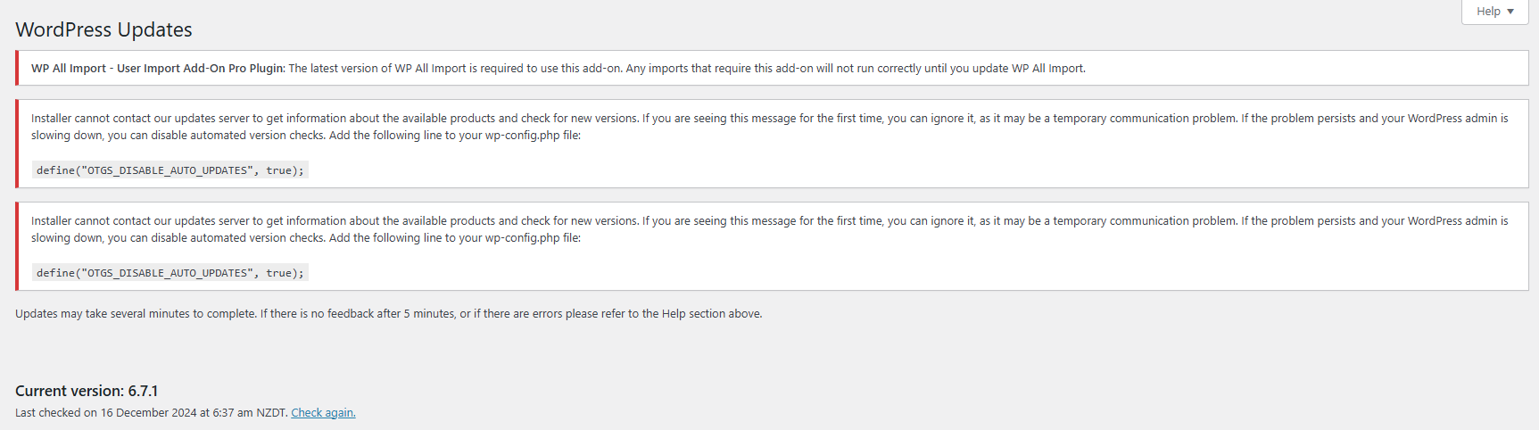

Appreciate the response. I checked and the STAGING site is fixed. I applied the same steps in the live site. Now that the Toolset error is gone and i still have the following Error/Warning. Im attaching them for your reference.

Thanks for trying the above steps on your live site. Could you please contact the hosting service provider and ask them to whitelist the URLs below:
- wpml.org
- cdn.wpml.org
- api.wpml.org
- api.toolset.com
- cloudfront.net
And see if this resolves the problem.
Here is a doc for more details:
https://wpml.org/faq/wpml-plugin-cannot-connect-to-wpml-org/
