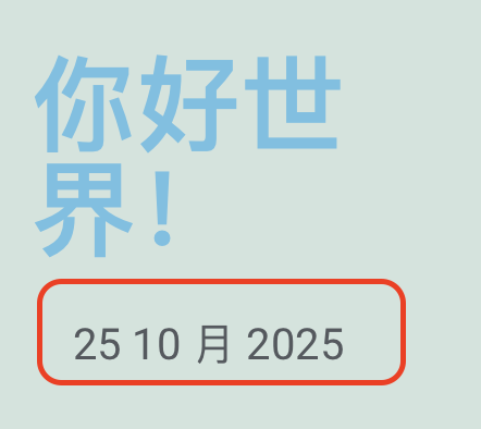

October 7, 2025 at 5:31 am #17462246
yukiS-2
Hi Otto,
I already reproduce issue with minimal steps, kindly have a check on home page for ACF field event_date, kindly advise where can translate date format for ACF field in Chinese to m月d日, Y, thank you
October 7, 2025 at 3:08 pm #17464331
Otto
Because the ACF date is inserted via an Elementor Theme Builder template as a dynamic tag, the date format cannot change per language within that single template. Elementor’s dynamic tag ignores ACF’s per-field hook return format. Therefore, with the current setup, achieving different date formats per language is not possible without changing the template approach.
Best Regards,
Otto

October 9, 2025 at 8:16 am #17469807
yukiS-2
Hi, thanks for the code. I added the code already, but the event date format does not change in chinese translation. Can you try from your end? Thank you.
October 9, 2025 at 10:51 am #17470741
Otto
It won't work in the current setup. With the Elementor set up the hook is skipped.
I created a full example using a shortcode, you can see it working here:
and
note the different date format for the field.
To use it, I added a shortcode in the page and translate it:
[acf_event_dates posts_per_page="10"]
You can check it in the test site using the WP File Manager plugin:
Otto
