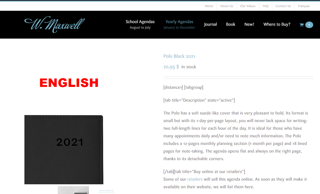

I try to create a layout for woocommerce product. Original version (french) is ok. But, translated layout (english) does'not work.
I follow this documentation (see section Translating Avada Layout Sections): https://wpml.org/documentation/theme-compatibility/using-wpml-with-the-avada-theme/#getting-started
Here is the french link
Englsih link should look like to the french one

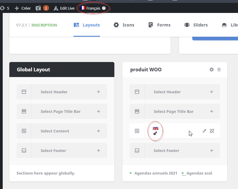

So I checked the layout under Avada > Layouts and found that it's created in English and not translated into French, so please add a french translation and check if the issue is solved, you can also use the "Language of this section" option to change it to french then add the English translation.
After adding the layout translation, make a small change to the page using that layout then update the page and the translation.

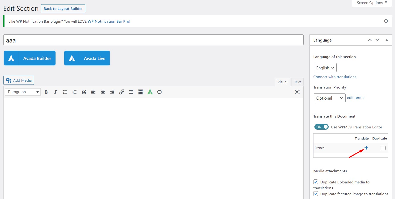

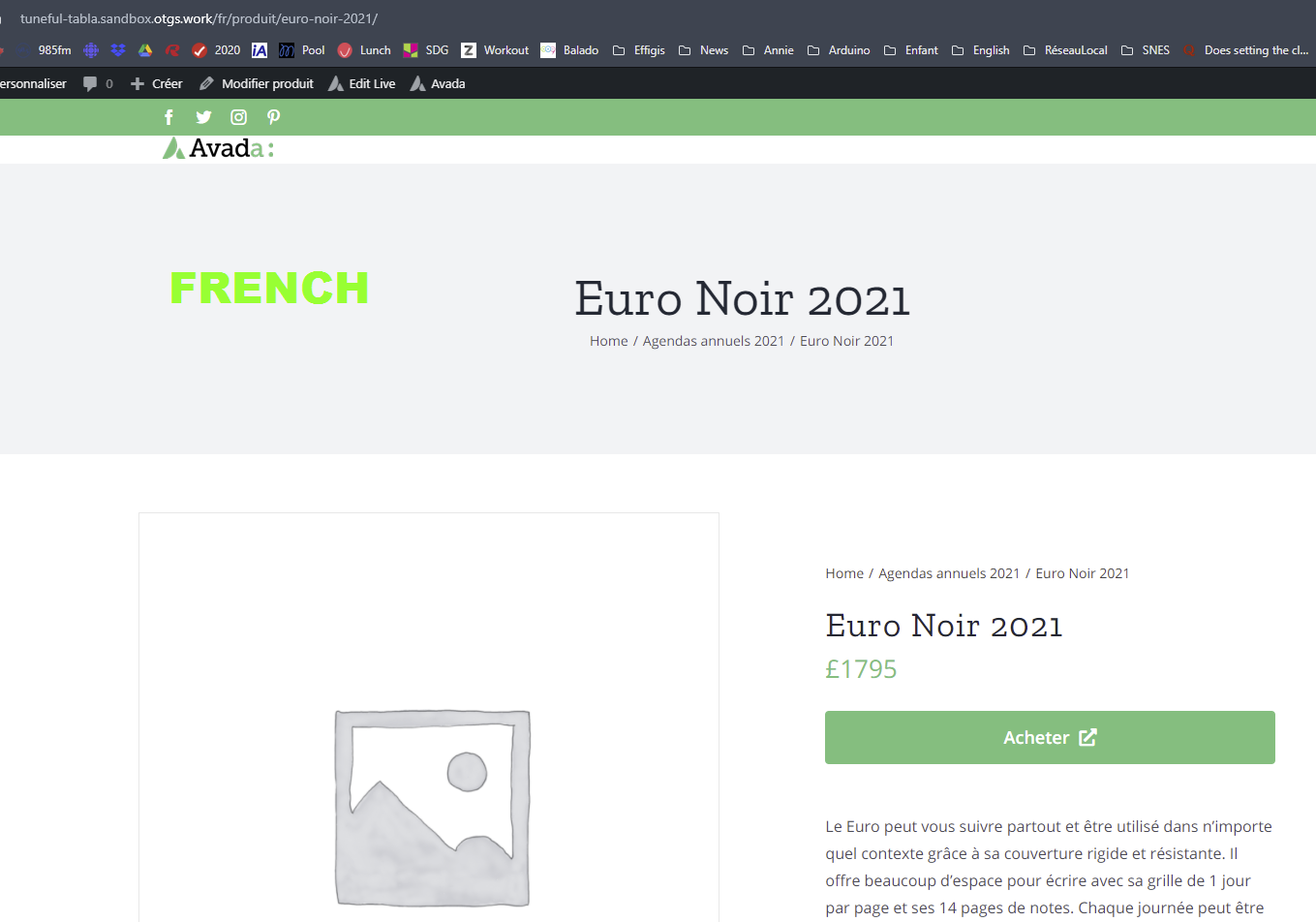

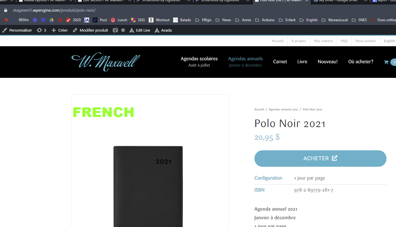

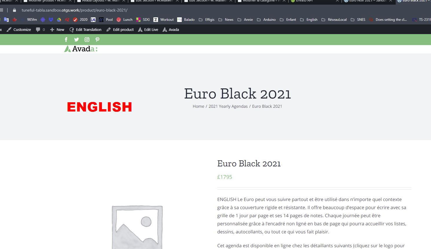

Sorry it's my fault. I changed the layout after I had made the ticket. Now it's ok and you will see my problem: french layout is the good one and english one doesn't work. It displays the default content (without button Acheter).
When I am on the english layout backend, I can't add a custom section. Exemple, if I want to add a content section, add a name (example abcdef), it is not saved after clicking on Create New Section Button.
Thanks Mohamed.

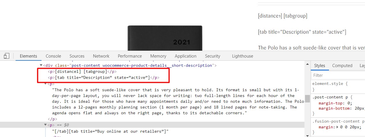

The source code of the English page shows that the shortcode is broken with p tags wrapping it (Please check the attached screenshot). So I will need to investigate this issue further on a clean installation to figure out if this is a compatibility issue with the Avada builder or it's related to the site's configuration (like how the product or the section layout is translated).

I have done everything you requested on the sandbox. I installed the Avada theme, with at least one product category and one product. I got the same bug. The french layout works. I translated the layout in english and it doesn't work (english page of a product displays the default layout). Furthermore, I cannot add a new section (example: content) in the english layout (same behaviour than on my stage environment).
