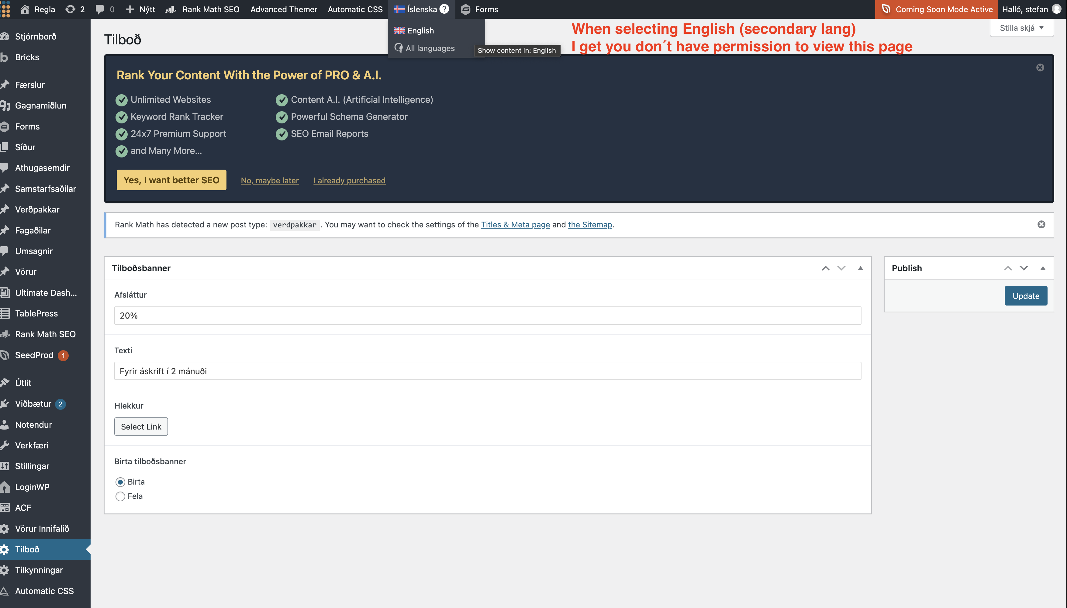

I am trying to translate option pages to the second language and following the steps in documentation. But the option pages are not showing when switching to second language in the dashboard.

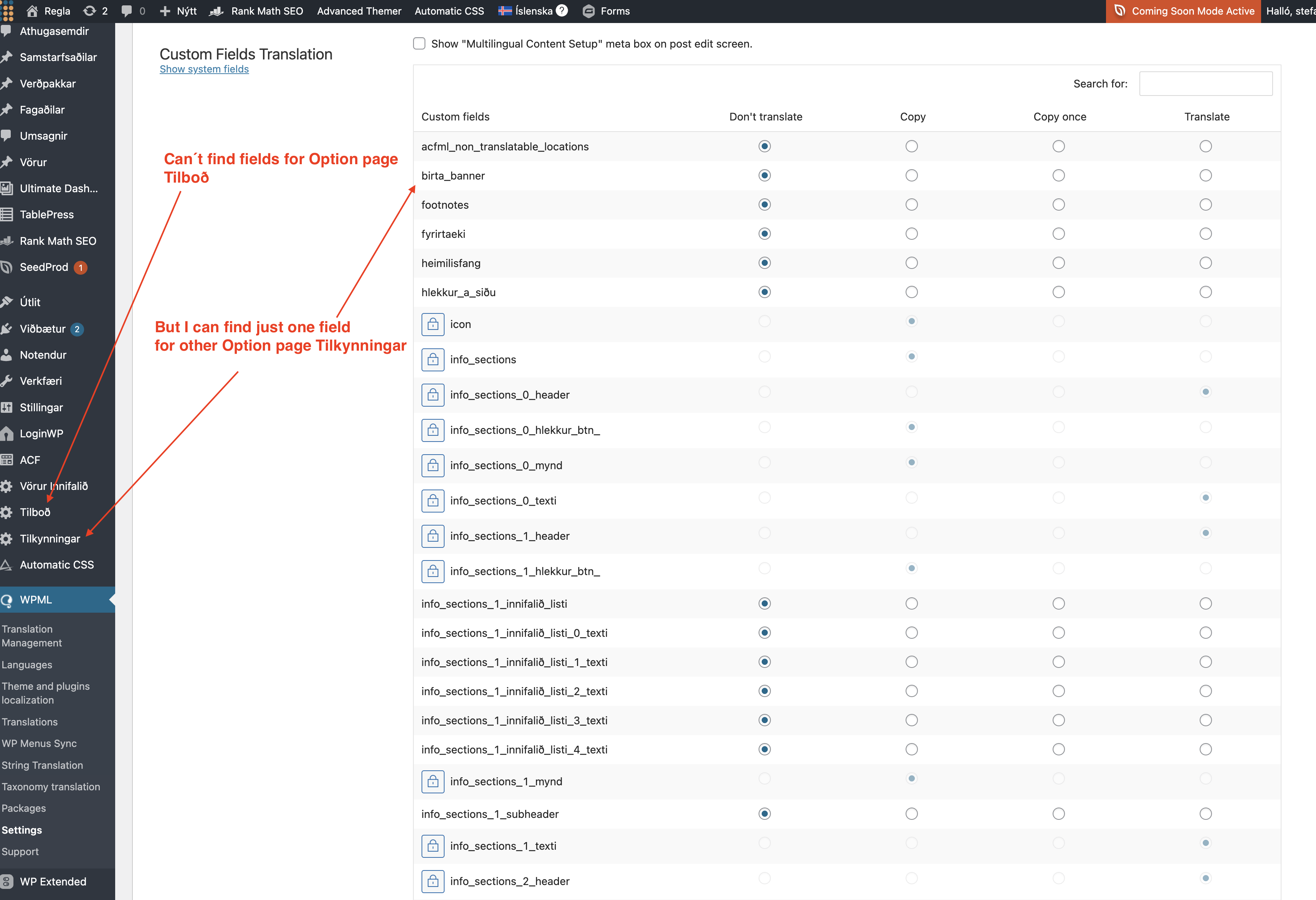

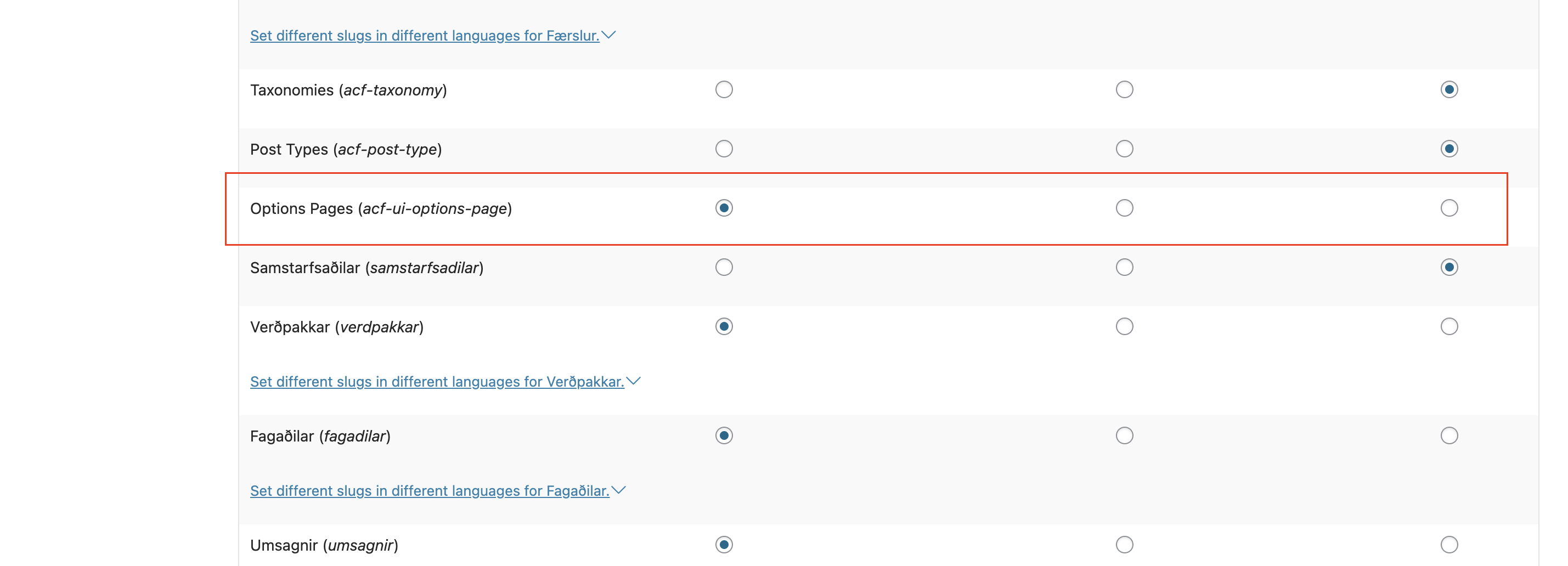

Yes ACF Pro, I have tried following the documentation without any luck. Please view attachment images with explanations. Hope it helps.

Based on the screenshots, the settings for the options page and fields appear to be correct. If you're encountering a permission error when attempting to access the options page in other languages, it might be related to an access restriction associated with your account.

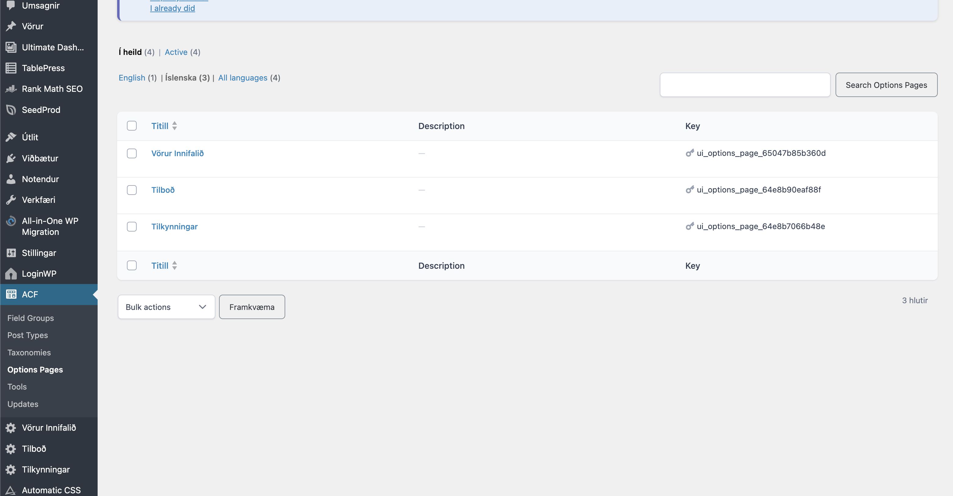

Thank you for sharing the access information. I have checked and found that the "Options pages"(ACF → Option Pages) have not been translated into English, which is mainly causing the issue. Please check this screenshot: hidden link
I translated the "Tilboð" option page by going to "ACF → Options pages → Tilboð" and it started to work properly in the English version. If you switch to English, you'll not encounter the issue again.
Kindly finish translating all the option pages, and this should resolve the issue thereafter.

Great thank you. I still don´t see the translation option in ACF (see sreenshot), and therefore cannot translate, do you know why that is?

You'll see the translation option when you edit the options pages from "ACF → Options Pages". Please check this video for a better understanding: hidden link
