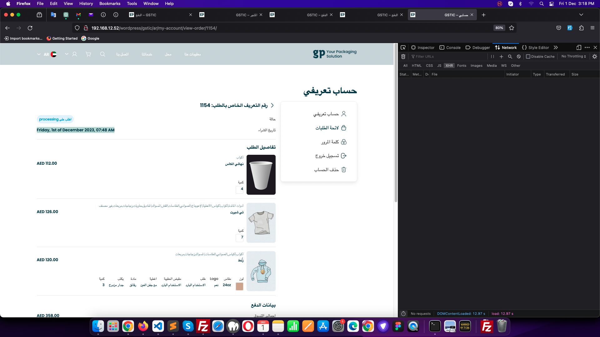

In my woocommerce project i have place order in ar language then when i go to my-account and see order listing then go to view order/order detail then there is date like:
Friday, 1st of December 2023, 07:48 AM
This not translating in ar.

Hello there,
Thanks for your contact!
Could you please try to translate this date format following our related doc? https://wpml.org/documentation/getting-started-guide/translating-your-sites-date-format-using-wpml/
If you can't find the correct string, kindly check for additional date format strings, as stated at the end of the documentation above:
Keep in mind that some themes may have their own options for date and time formats. In these cases, when you try to change the date format using the above steps it might not change on the front-end. Try searching for date format-related strings by selecting your theme from the In domain dropdown in WPML → String Translation.
Please give it a try and let us know how it goes. Thank you.
