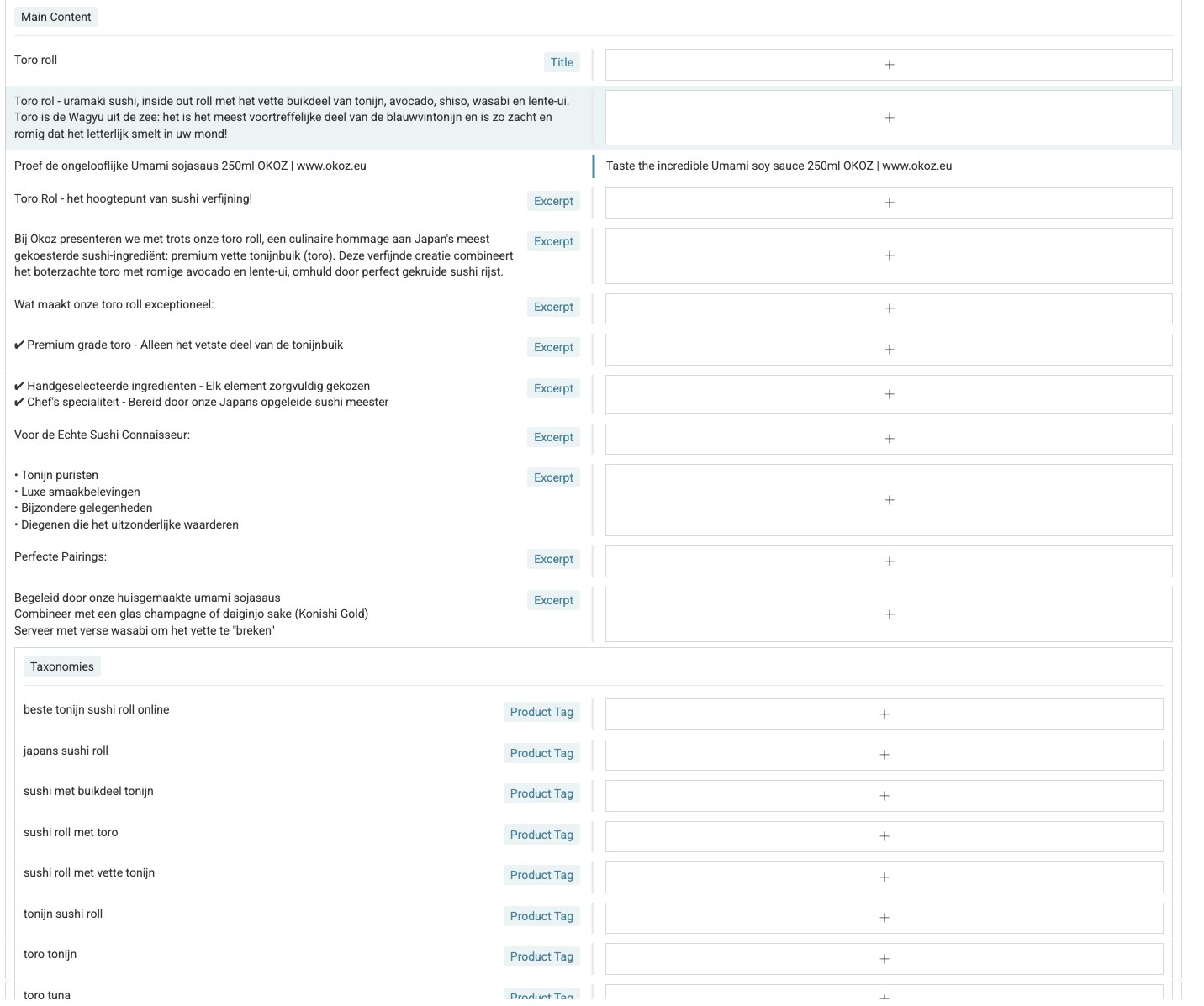

that is the case for me as that option is marked yet WPML instead of taking paragraphs at a time it takes small segments and most of the time line by line. it makes no sense to translate line by line as sometimes the languages do not align correctly together this creating a very unprofessional translation.
I hope to hear from you soon,
Victor

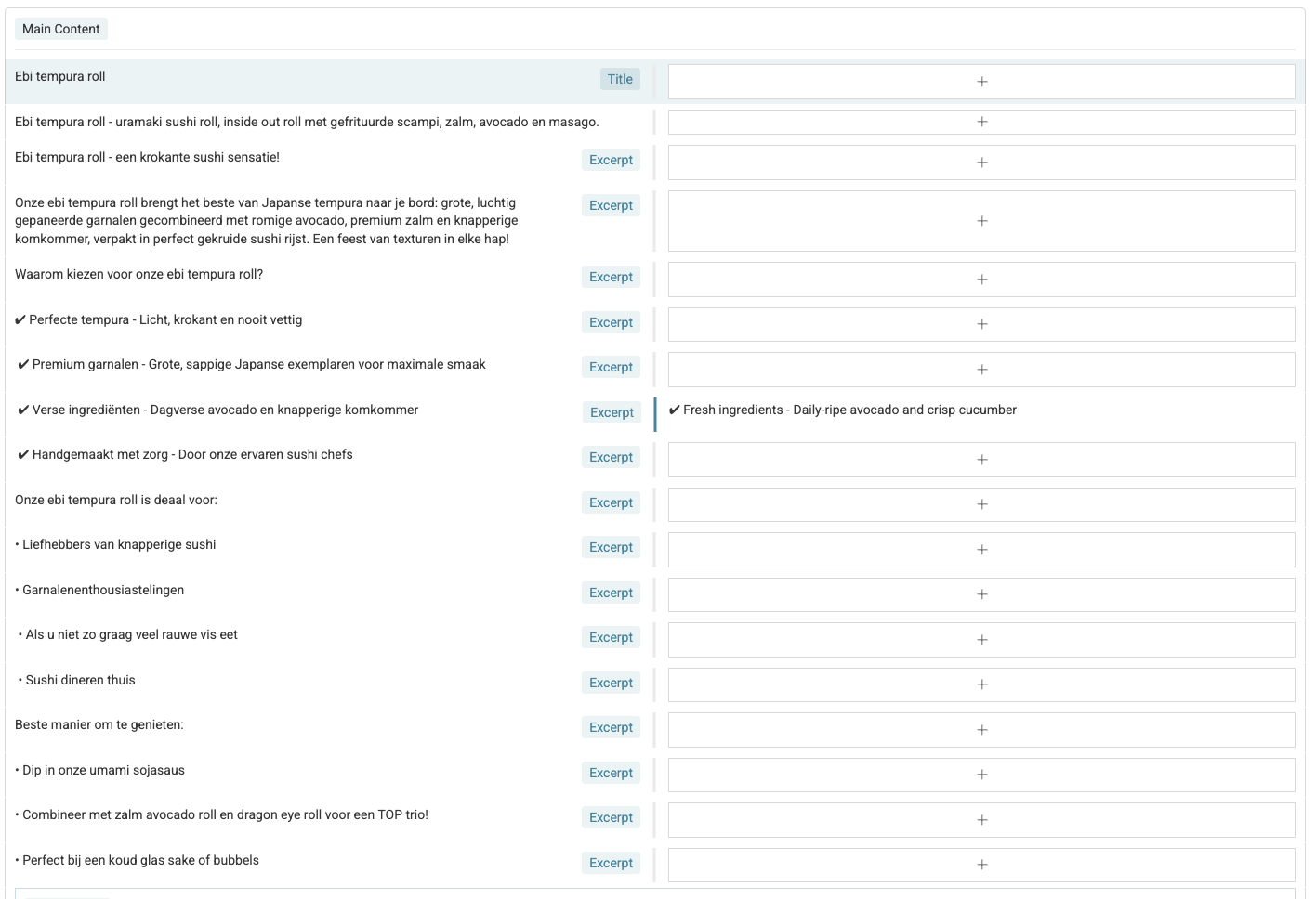

this also is for product that was translated already but when translating for the first time and its lots of text it makes no sense.
I also do not have the ability to link lines into one paragraph or make them in chunks, please see attached screenshot.
As per your enquiry about if it is all like that, what I see is that it varies but mostly line by line.
May 21, 2025 at 2:24 pm #17058090
Christopher Amirian
WPML Supporter since 07/2020
Ok from the screenshot you shared, I do see that the paragraphs are separated in the product excerpt.
This will be how ATE works and there is no joiIn those sections as ATE needs the separation to find a meaningful chunk to handle automated translations.
The second part is the taxonomies. These can be translated once and after that they should not show if the new product has the same categories.
You can always translate all product categories at once and get done with it doing the steps below:
https://wpml.org/faq/how-to-translate-all-taxonomy-terms-at-once/
Thanks.
