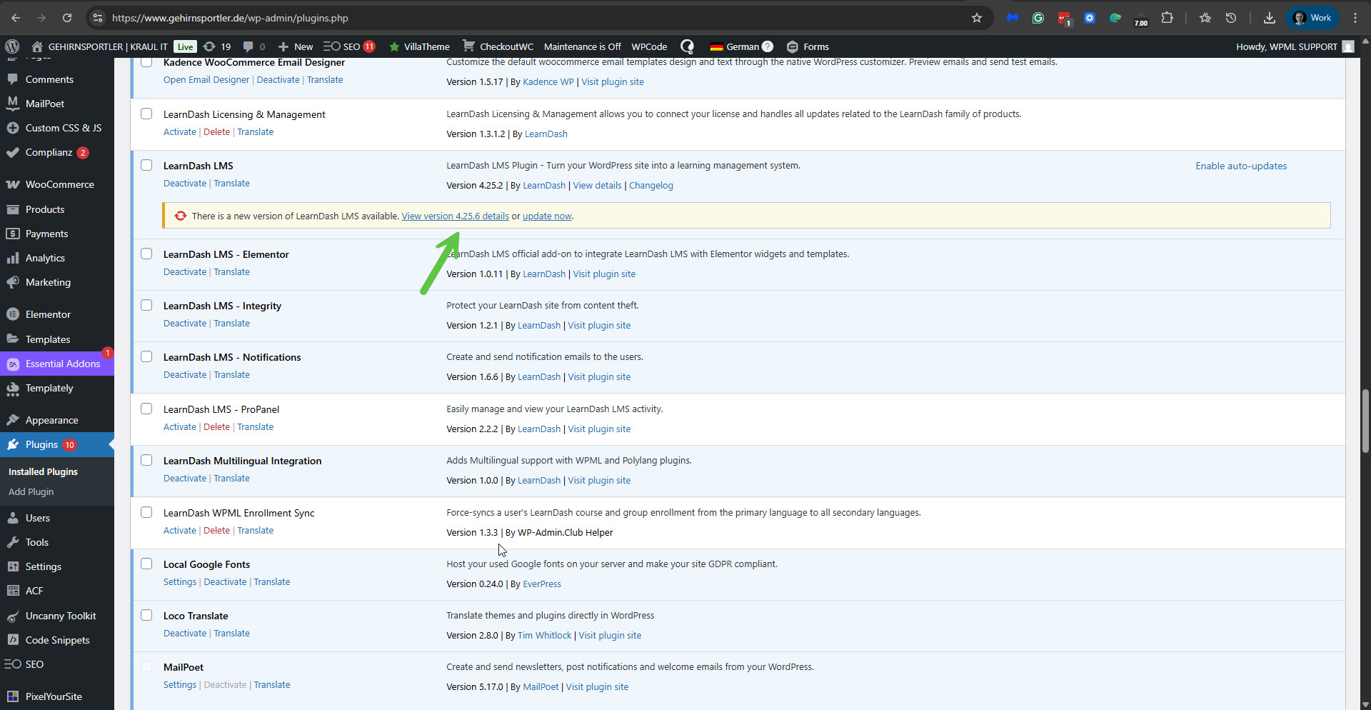

Please update the LearnDash LMS plugin on your site, as I mentioned in the chat. Please see the attached screenshot. If this does not help, please ensure you are following our guide on using the LearnDash LMS plugin: https://wpml.org/documentation/plugins-compatibility/how-to-create-multilingual-online-courses-websites-using-learndash-and-wpml/. I can also see a few translated courses in the Draft status. Please check if the problem occurs with those courses. If so, set them to Published and check again. If nothing helps, please try the following proceedure.

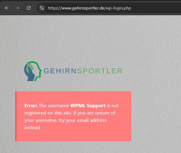

In any case, please know that I'm unable to log into your site anymore. Please see the attached screenshot.
