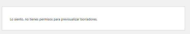

Hi Kor. Yesterday our site was down, broken, gave error not loading both in front end backend. I could have been from your team tuching something, I do not know. But nevermind, I ran a function at my hoster simply.com, called Repair WordPress installation. It did its job and or site worked again. Then I had a thought, what if this also repaired WPML? And it did! I just tested now, see clips. Sheet Editor workes now. Great. So either did your team reapir the error or eles did simplys.coms script for WP repair do it. Then I tested the old WPML error that I also mentioned for you earlier. This error is not repaired. Still there. The error consists of that a mouse click on the eye symbol in Pages gives an error going about missing rights. This is a never solved error reported by me to WPML earlier, so you can just look at our support cases and see no. 1 case, this is this. We need this fixed also. I have attached clips of the error here also. The last 2 clips. The first clips is Sheet Editor now working. Nice that the error destroying Sheet Editor is gone now! Regards Michael |

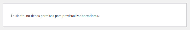

Hi Kor, Thank you! I have used the work around by changing an elements name and change it back. A click on the eye symbol then works on Blogs and Pages, but not on UX Blocks. I click on the eye in the overview page (the list of elements), not on the eye in the editor. That work fine on everything else than the UX Blocks that have an eye. See the error with UX Blocks and click on the eye i list format in attached. Could you fix the UX blocks also? Regarding the first error with a defective SheetEditor when WPML is enabled, I do not think it was a server side error. It could have been solved by a function from my hoster simply.com, called Repair WordPress installation. It manipulates my WordPress, not the server. SheetEditor still works, and that is nice! Looking forward to hear about a fix of the not working eye with UB Blocks. Thanks, Best regards, |

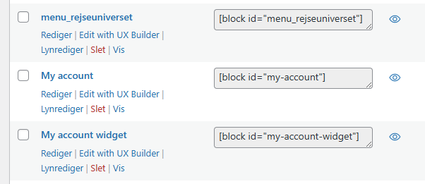

Hi Kor. Yes, go to the main menu for UX Blocks Go down to the 3 items with an eye, se clip. By me the give the error, also attached. Actualy the first with an eye here, menu_rejseuniverset, did work and go to WPML translation. I clicked "Go back" link and tried again, and then it did not work, the error came. Now all 3 gets the error. Please try. Thank you! Regards Michael |

Thanks for your reply. I can see the issue now. You need to make a minor change to the primary language page, as shown in this screen recording: hidden link |

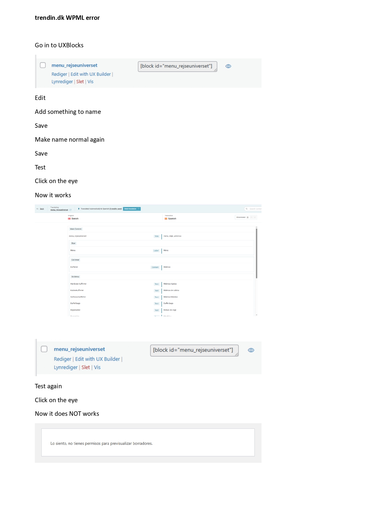

Hi again Kor. No, it does not work. See below and attached. I will start with my question from earlier, are WPML correcting this error? You did not answer this. I am using way to much time on this error, testing, replying, sending clips. WPML is a solution we pay for, so I expect to use it as a working tool, not a time consuming thing. In addition to this, as I now has spend arround 3-4 hours on the 2 errors in WPML, I would like to have a discount for a period us WPML use as a compensation. OK? And how much can you give me? Back to the error: I can be corrected, but the error is back next ime. See below and attached. Go to UXBlocks Edit Test again Please correct WPML and make it work. Please compensate my time. I am using way to much time on this error. Thank you, regards |
