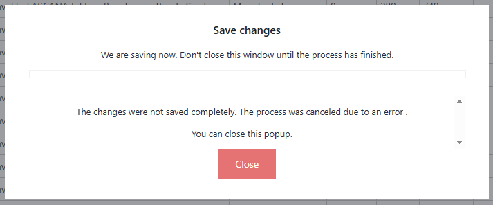

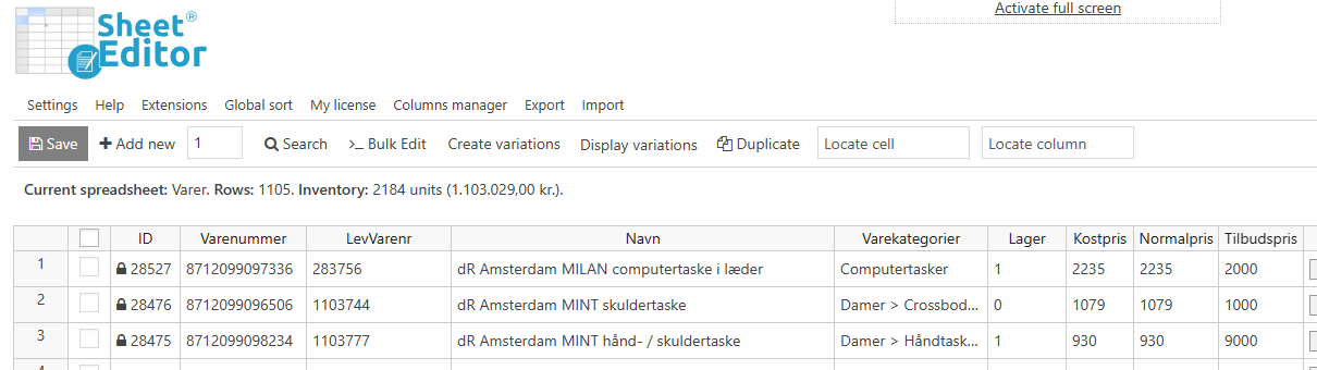

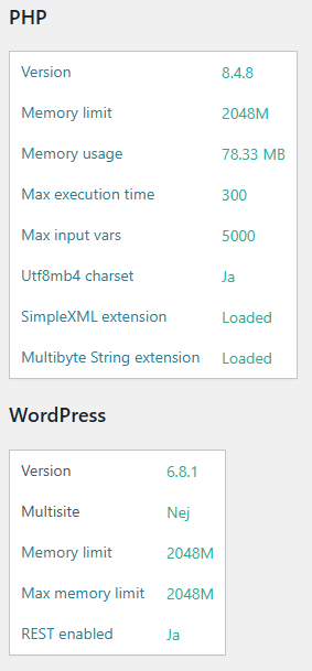

I am trying to do my work using WP Sheet Editor with products. I have noticed that it starts not being able to save data when WPML Multilingual CMS is active. I have tried deactivating cache, clearing memory, using different browsers, and even another PC, but nothing helped. The only thing that worked was deactivating WPML Multilingual CMS. I have a lot of screen clips showing the error and the environment, and you can have access to the site to check things out and make necessary changes. The issue can be seen at hidden link.
WP Sheet Editor becomes useless and cannot save data when WPML Multilingual CMS is active. The issue resolves when WPML Multilingual CMS is deactivated.
Why does WP Sheet Editor not work when WPML Multilingual CMS is active?
What changes are needed to make WP Sheet Editor work with WPML?
July 1, 2025 at 6:19 am #17186522
Thanks for contacting us. I've checked and this WP Sheet Editor is fully compatible with WPML and there are no known errors with this plugin as shown here https://wpml.org/plugin/wp-sheet-editor/
Could you please try replicating the issue on our sandbox site here hidden link so that we could check this out for you?

Yesterday our site was down, broken, gave error not loading both in front end backend.
I could have been from your team tuching something, I do not know. But nevermind, I ran a function at my hoster simply.com, called Repair WordPress installation. It did its job and or site worked again.

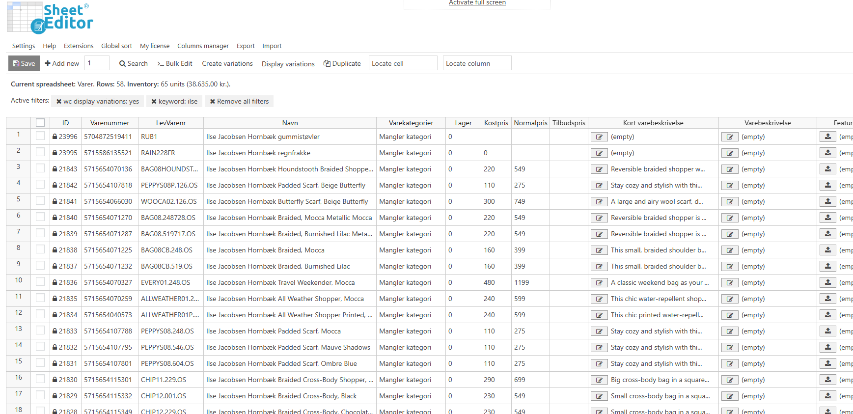

Then I had a thought, what if this also repaired WPML? And it did! I just tested now, see clips. Sheet Editor workes now. Great.
So either did your team reapir the error or eles did simplys.coms script for WP repair do it.

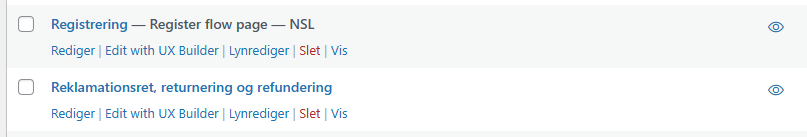

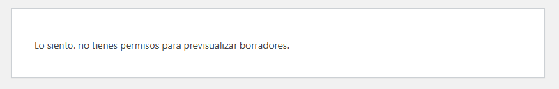

Then I tested the old WPML error that I also mentioned for you earlier. This error is not repaired. Still there. The error consists of that a mouse click on the eye symbol in Pages gives an error going about missing rights. This is a never solved error reported by me to WPML earlier, so you can just look at our support cases and see no. 1 case, this is this. We need this fixed also.
I have attached clips of the error here also. The last 2 clips.
The first clips is Sheet Editor now working.
Nice that the error destroying Sheet Editor is gone now!
Regards Michael
