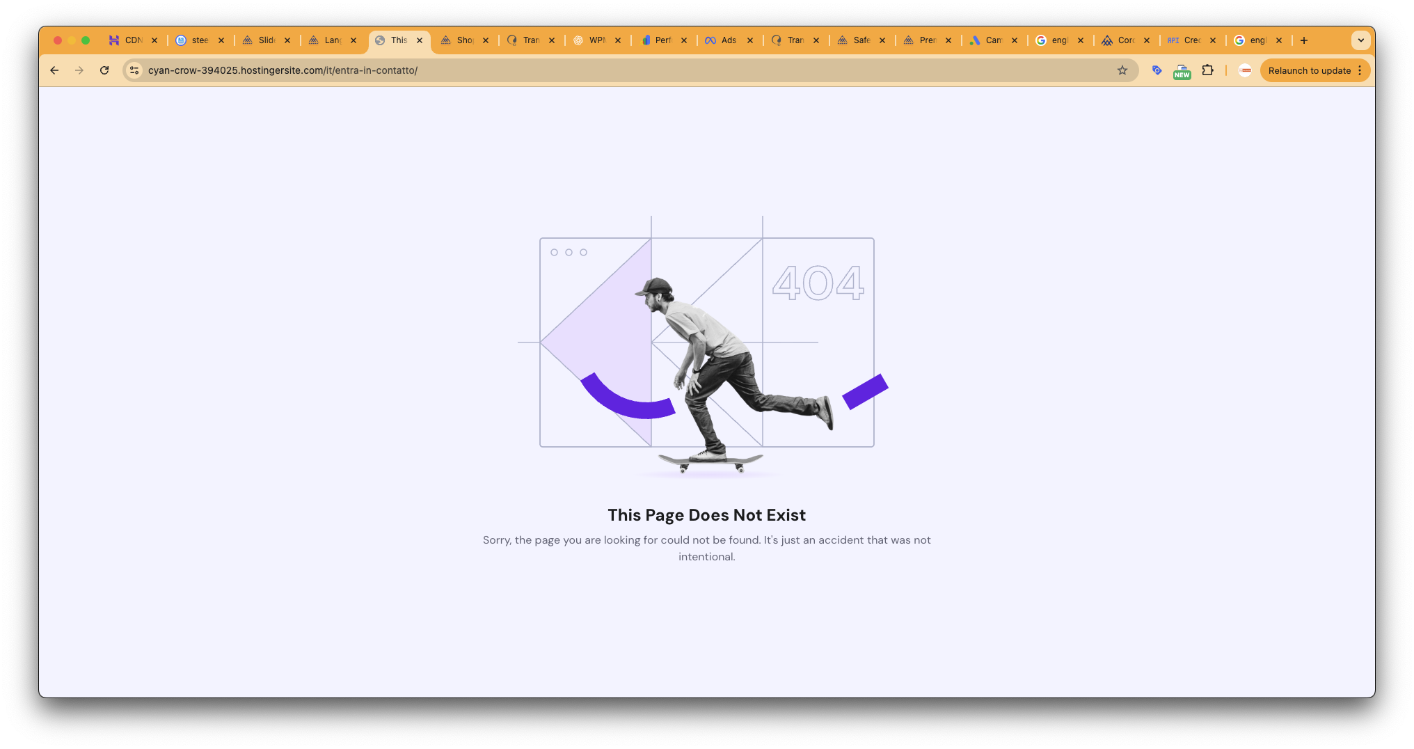

August 26, 2025 at 11:52 am #17348114
kamal-kishorS-2
Hi Carlos,
I tried checking the contact page and again encounter 404 error.

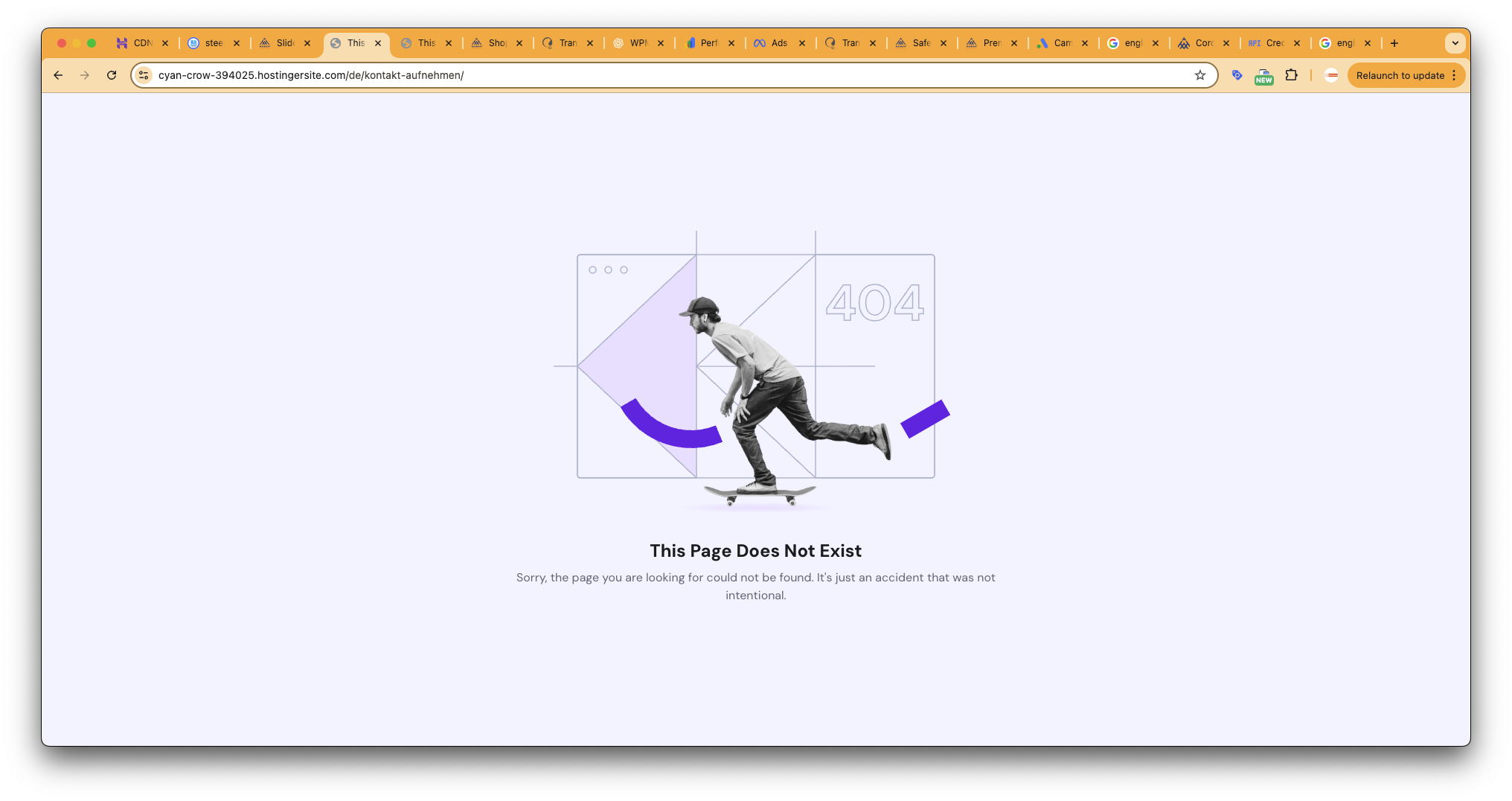

August 26, 2025 at 12:00 pm #17348197
kamal-kishorS-2
Hi Carlos,
Thats is the problem. Sometime, page open and sometime, it return 404. Try navigated 2-3 times switching between language for same page. you will encounter 404 error.
