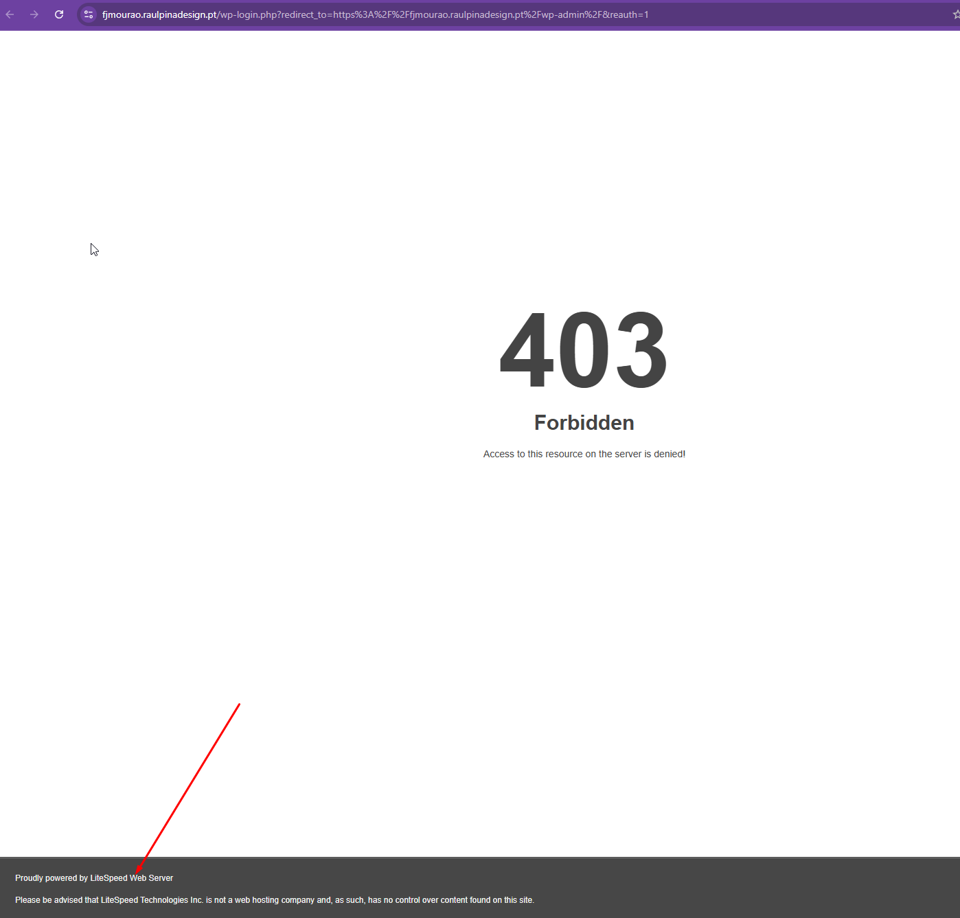

March 2, 2026 at 7:09 am #17863351
Thanks for your reply. I'm getting the error shown in the attached screenshot. Could you temporarily disable the restriction so that I can check?

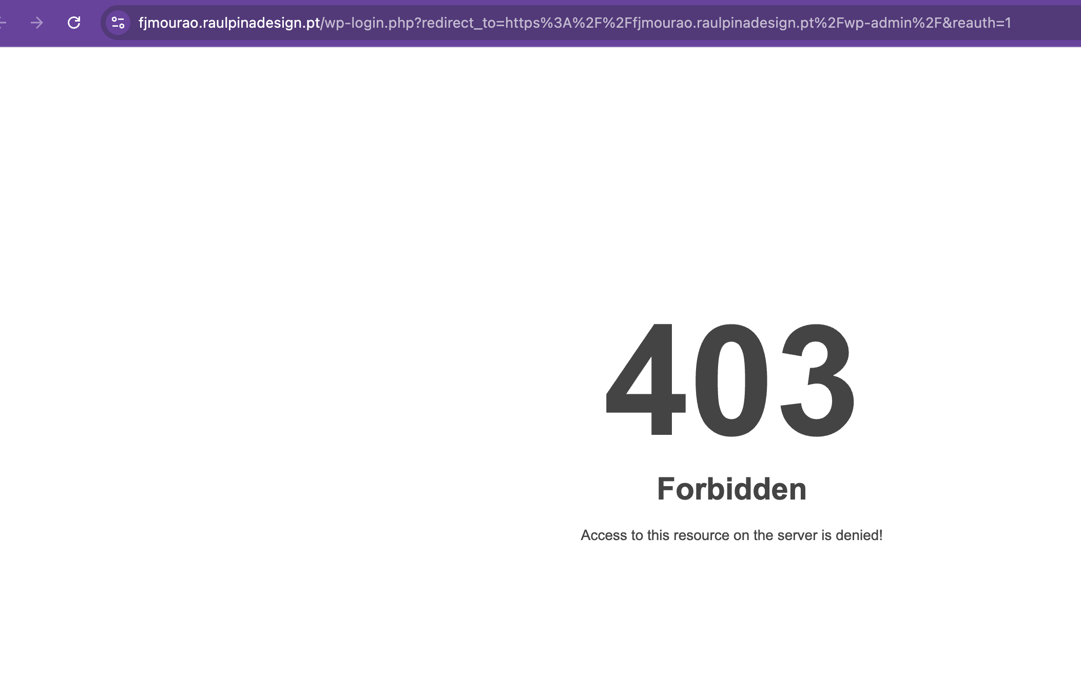

March 2, 2026 at 11:37 pm #17866483
Raul Pina
Hello!
Where this error appears?
March 3, 2026 at 6:58 am #17866780
Thanks for your reply. It's appearing when I try to access the login link. Could you temporarily deactivate the LiteSpeed plugin so that I can login to your Website to check?
March 3, 2026 at 9:17 am #17867367
Raul Pina
Hello.
I don't have any cache plugin. I tried yours login access and it worked.
Could you try again?
March 3, 2026 at 11:51 am #17868088
Thanks for your reply. The blockage is from your server side as shown in the attached screenshot. Could you check with your hosting provider?
March 3, 2026 at 12:52 pm #17868454
Raul Pina
Hello. Sorry.
You should be able to access it now.

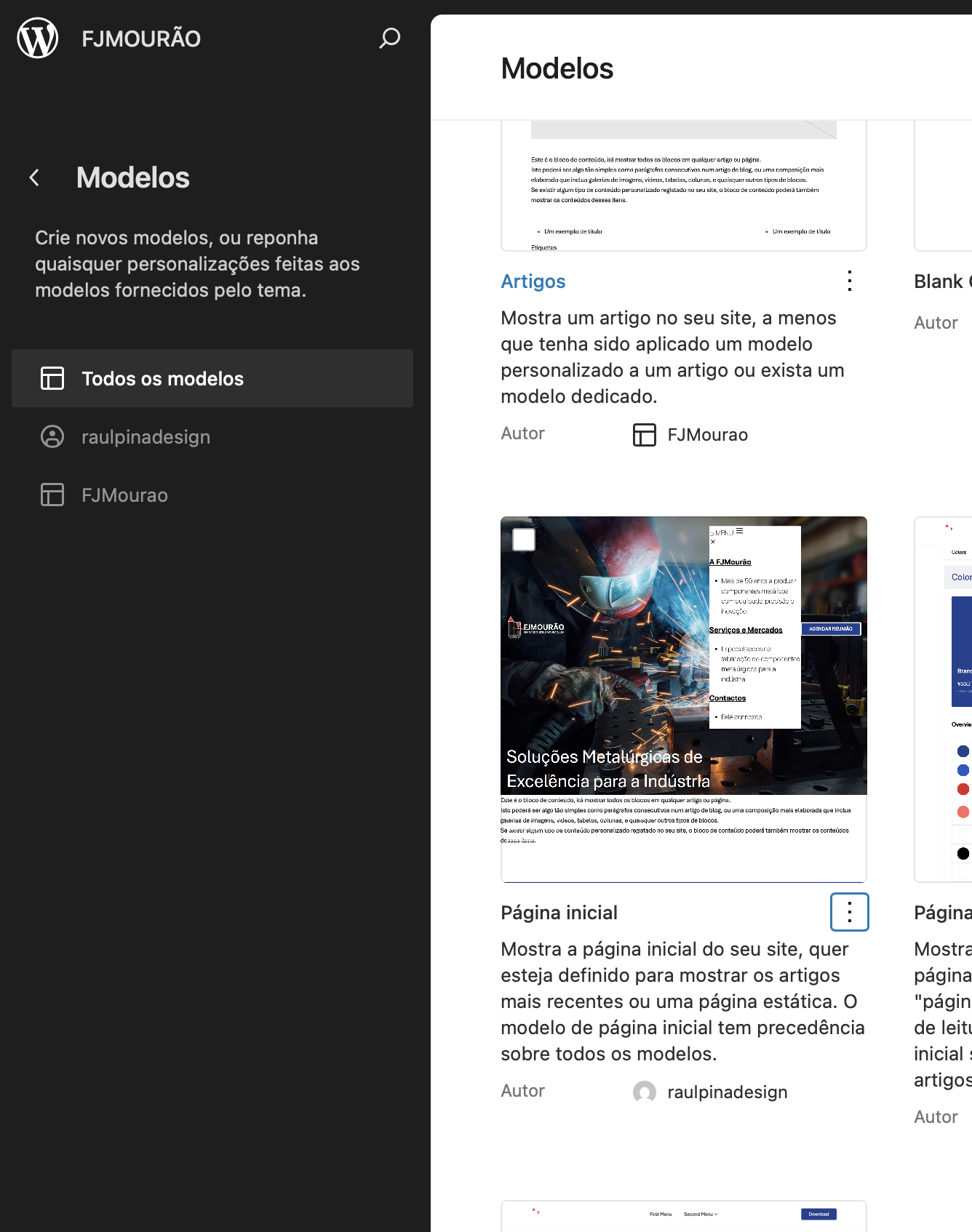

Hello. Thanks for the reply
The header and footer on the pages still not appear (I used a template Paginas - Pages).
Please check the original and translated language (the switcher is on the bottom page).
The homepage is a template (pagina inicial) (check attach)
March 4, 2026 at 11:35 am #17871678
Dražen
Thank you for your reply.
I checked the issue further and it seems that the correct template was not assigned to the translated page. This is a known issue that can happen when templates share the same slug or have very similar names. You can read more about it here:
- https://wpml.org/errata/template-is-not-applied-to-translated-page/
In your case, I manually edited 2nd language homepage and assigned the correct template. After doing this, the header and footer now appear correctly.
Please check on your side and let me know if any further questions.
Dražen
