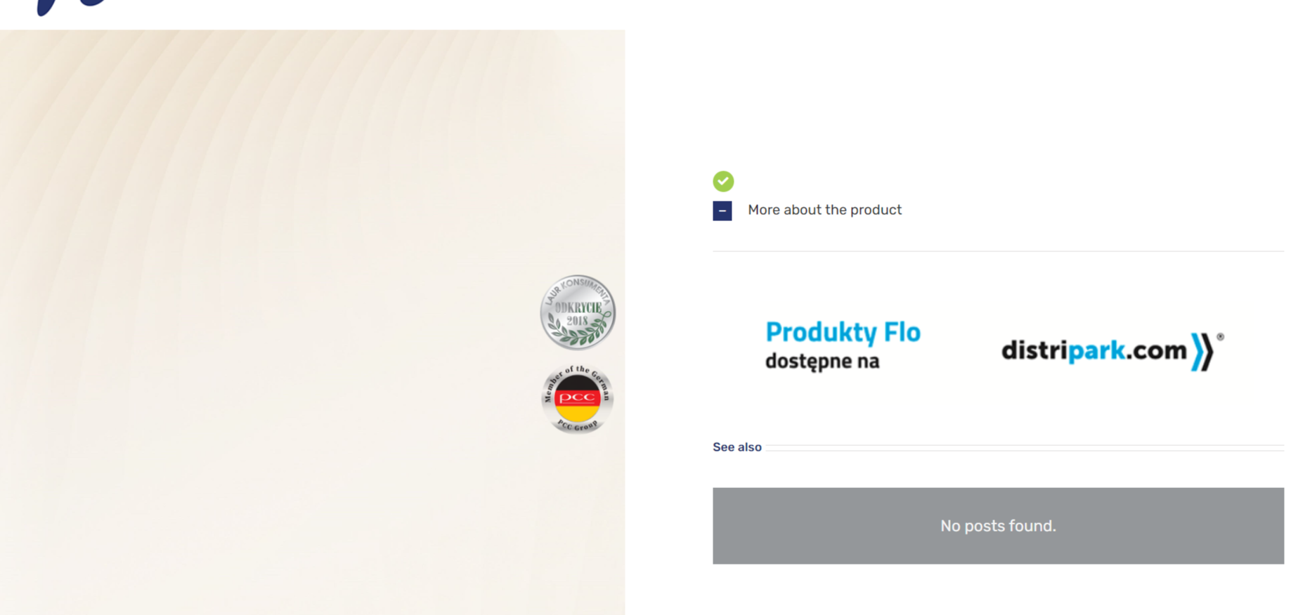

I've added custom post type ("produkt") and some custom fields. I've checked them as translatable in WPML settings, I've translated the post using WPML advanced tab.
On the site the content is missing.
Why is the translated post content not visible on the site?
Are there additional settings required to display translated custom post types and fields?

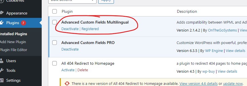

- Installed and activated Advanced Custom Fields Multilingual (ACFML) plugin, because you're using ACF for custom fields and these fields are being used for product's content. So these needed to be translated. And ACFML is required to add multilingual functionality to the ACF.

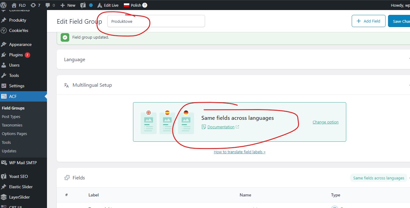

- Then I set the fields group's settings accordingly, as mentioned in the ACFML guide, and saved the group.

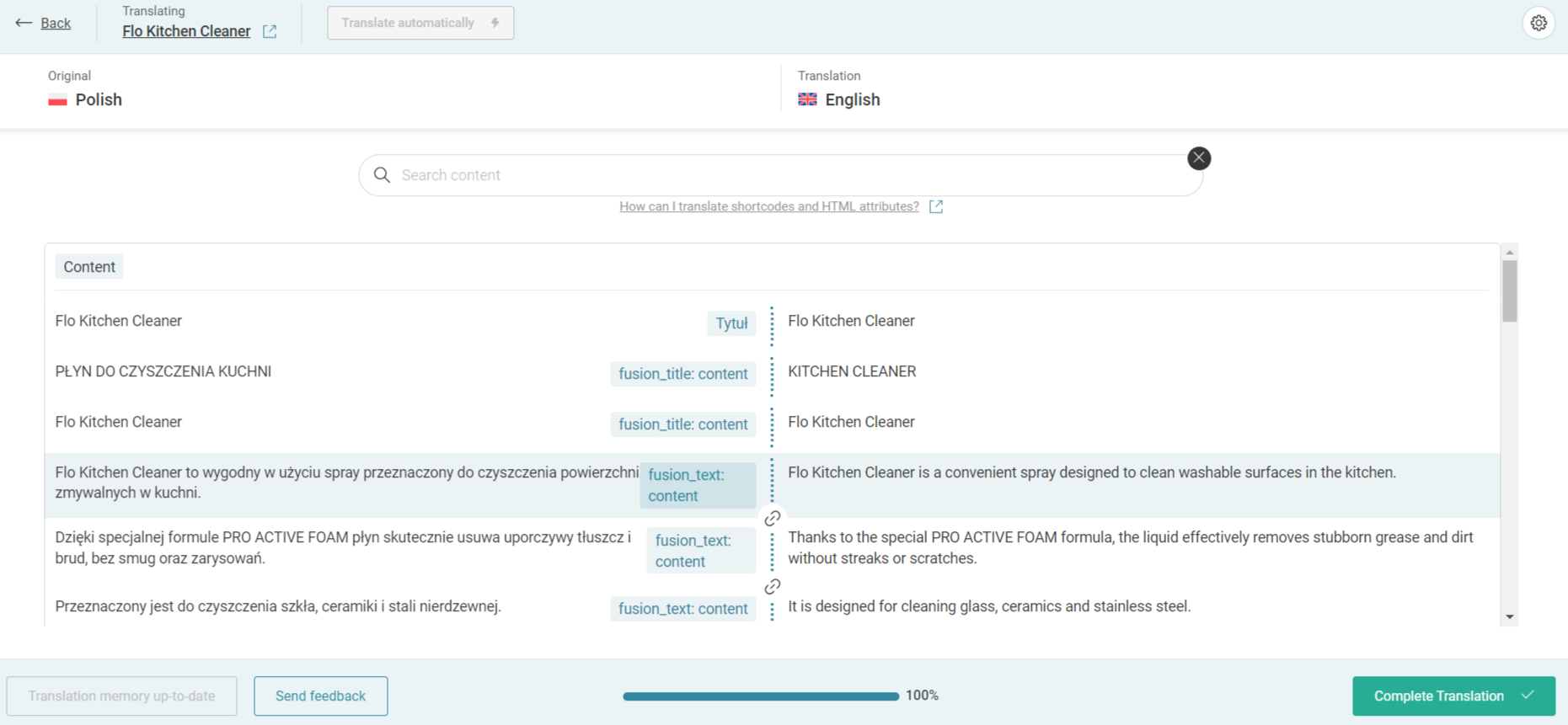

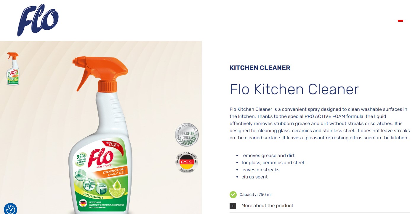

- Then opened the "Flo Kitchen Cleaner" product for editing in default language. Made a little change to the content of a field (i.e. added a couple of dots), saved the product and updated the translation. In ATE, it was translated automatically and all fields were present there.
After completing the translation, now hidden link displays fine.
