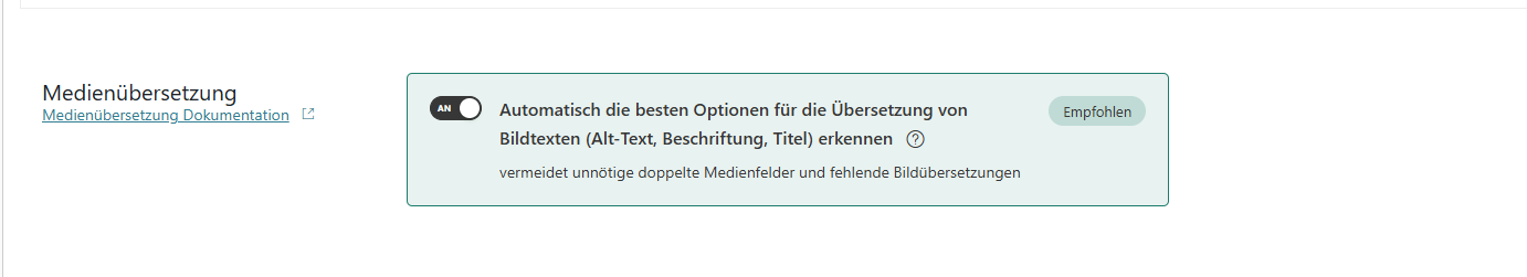

Also, please upload a screenshot of your settings from:
WPML → Settings → Media Translation
This will help me better understand how media is currently configured on your site.

I tried both, it resulted in the same error.
Also added the Screenshot.

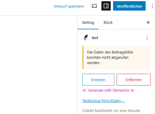

I tried to debug a bit further:
Example:
Post ID: 46669
Featured image ID: 46670
The post is trying to load attachment ID 46670, but this attachment does not exist:
Not present in NSi5F_posts (post_type = 'attachment')
No related entry in NSi5F_postmeta
REST API call /wp-json/wp/v2/media/46670 returns 404
Because of this, the block editor / WPML tries to load a non-existent media item, resulting in:
“Die Daten des Beitragsbilds konnten nicht abgerufen werden.”
