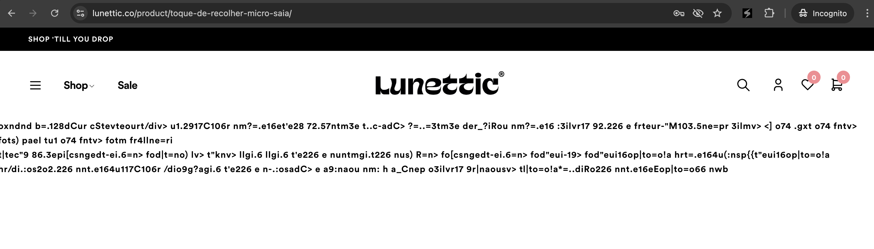

For some reason this product is not appearing after that: hidden link
The other ones were fixed.

Thanks for your reply. I can see the issue you’re experiencing. Since your website is live, may I have your permission to temporarily deactivate WPML for troubleshooting purposes?
I suspect the issue may be caused by another plugin, as it also appears in the primary language on this product page: hidden link . If the product remains broken in the main language after WPML is deactivated, this would confirm that another plugin conflict is involved.

December 16, 2025 at 6:55 pm #17669053
Thanks for your reply. I’ve attached a screenshot showing the error, and the issue still occurs even after the WPML plugin is deactivated. This suggests that the problem may be caused by another third-party plugin.
If the issue is only affecting this specific product, could you please try deleting it and recreating the product from scratch, then retranslate it and check if the problem persists?

December 19, 2025 at 2:11 pm #17678080
marianeM
Its a problem in something else as you said, thank you so much for the help.
