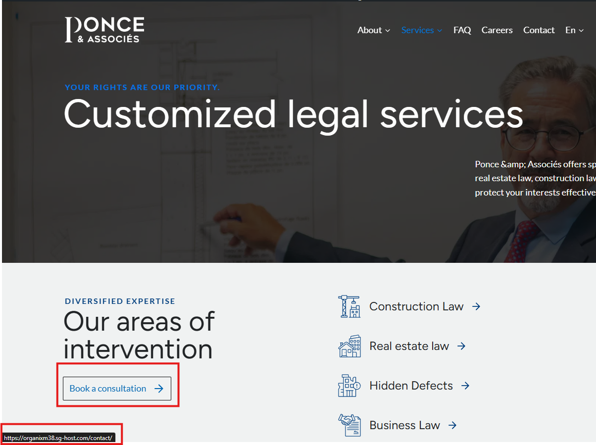

It's still not working even when adding the translated urls manually. They appear translated in the editor, but then on the front end it's still the french url. Look at the hero banner for example the contact button and also all the sections below you will see there should be /en/ in the URL.

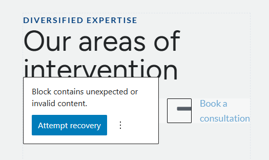

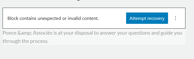

I just saw something. When doing in the editor of the english page, I'm seeing this code ''block contains unexpected or invalid content''. This is what is creating the problem it seems because in the WPML editor, the urls appear translated, and inside the gutenberg editor as well. When i click on ''attempt recovery'', it repairs the block and now the url appears translated. Same thing for the ''& '' symbol, it appears that error and the issue is fixed when i click on attempt recovery.
I was able to do this as quick fix since we need to launch the site but it's not convenient because when we update the translation, then the bug reappears and the urls revert back to the french ones.

the added custom XML configuration didn't fix the issue. Links still appear in french in the service page, and the symbol still appears broken. And it's worse now, many titles in the english pages now appear in french. Look at the h1 on the home page for example.

ahmedH-37
Check the service page for urls , not the home page.
Most of the urls appear translated now but not this one (see screenshot).
